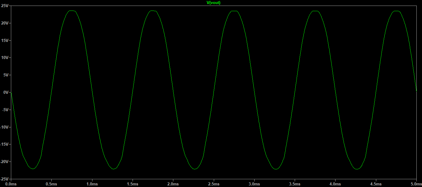

The clipping is well rounded so were on the right path

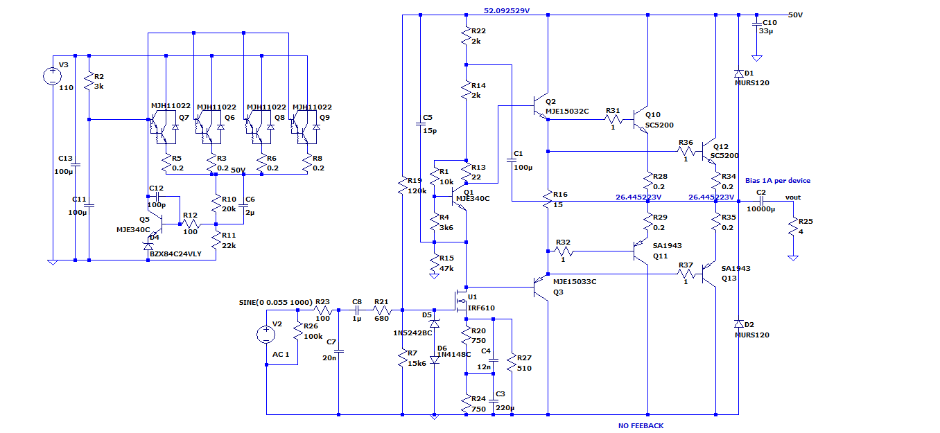

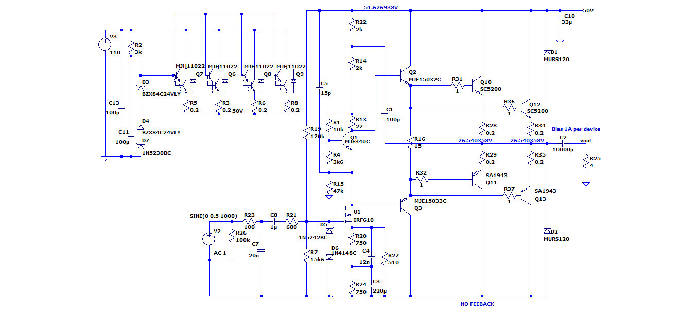

To bring the ripple down in class A amplifiers on the no feedback design a better regulated supply is needed since using an unregulated supply where one relies solely on capacitors can get crazy untenable for the 100,000uf needed for class A amplifiers, so seems regulated supplies create a balance and we can use reasonable cap sizes. Class AB is so much more flexible

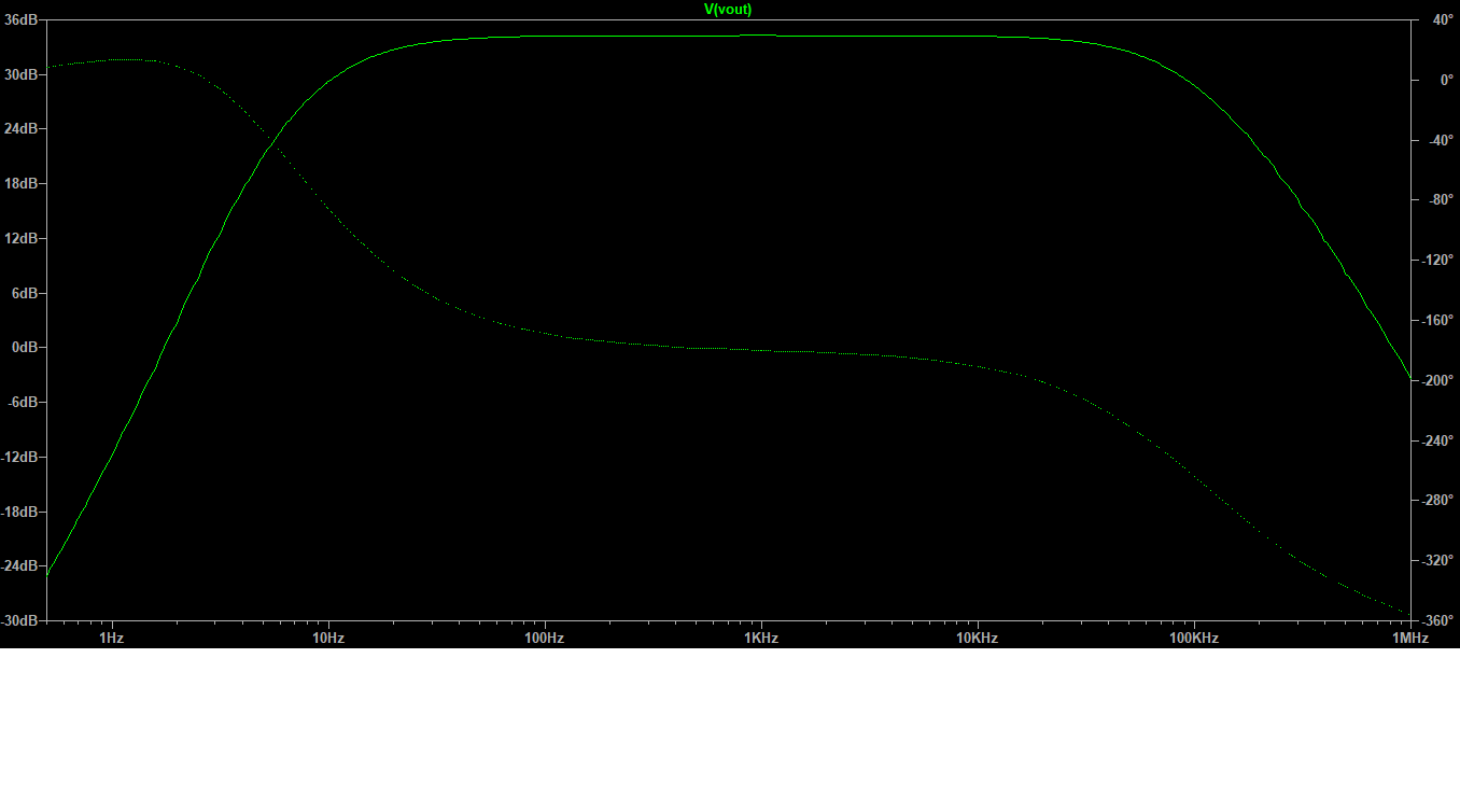

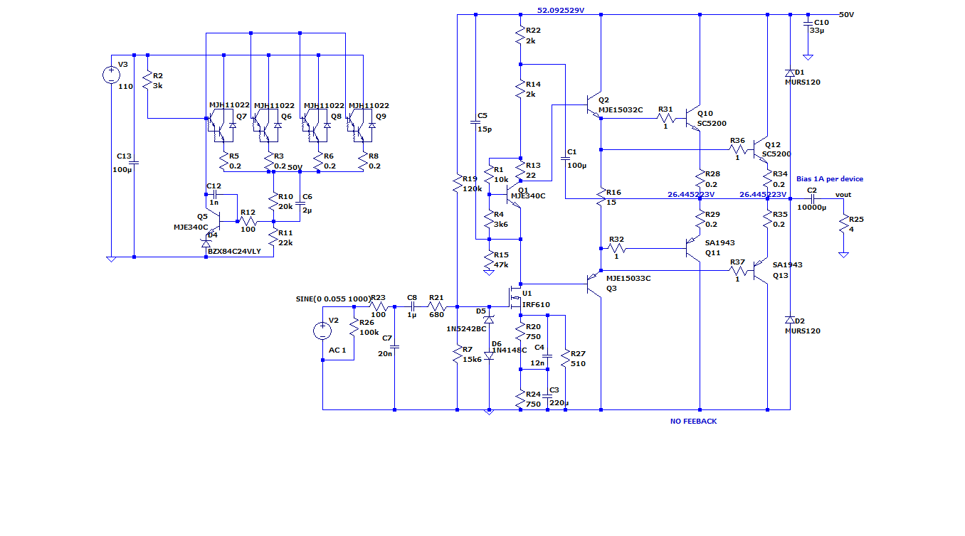

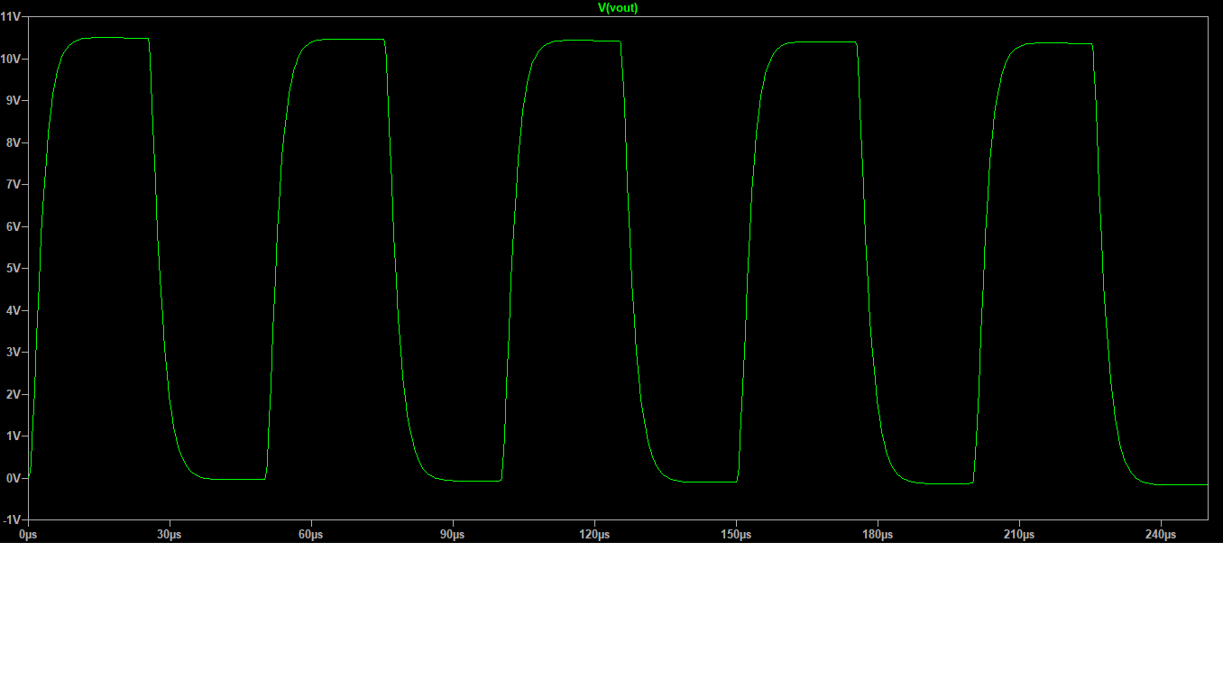

The regulator is part of the amplifier so deleted C11. With feedback in use only in the regulator increase the miller capacitor C12 in regulator to 1nf to stop high frequency oscillations. Updated is the schematic, frequency response and 20kHz square wave response

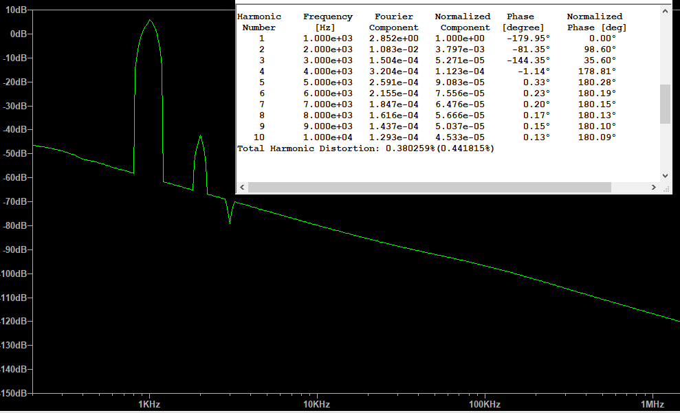

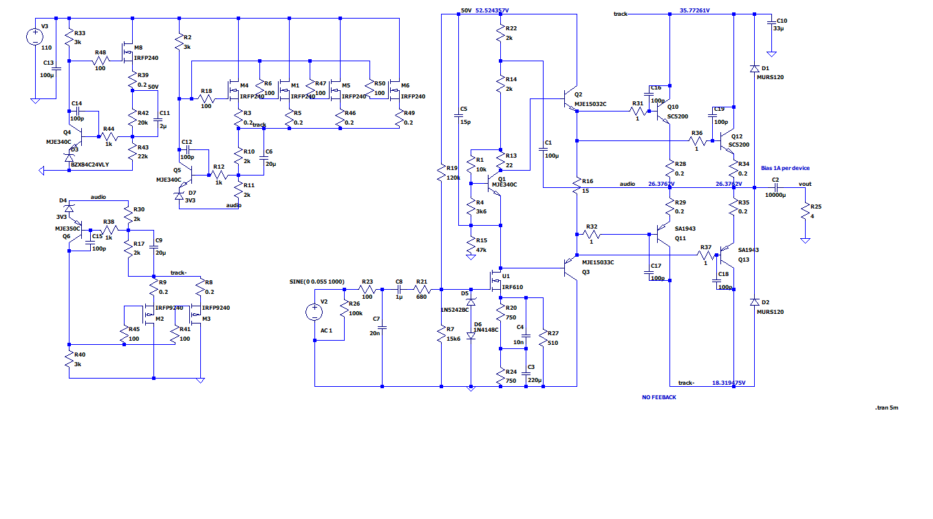

The tracking supply is half done and distortion is still 0.3%. Using PWM for regulator mosfets would take away most of the heat from the mosfets once done we can bias the output stage into pure class A. This design still has a few issues.
