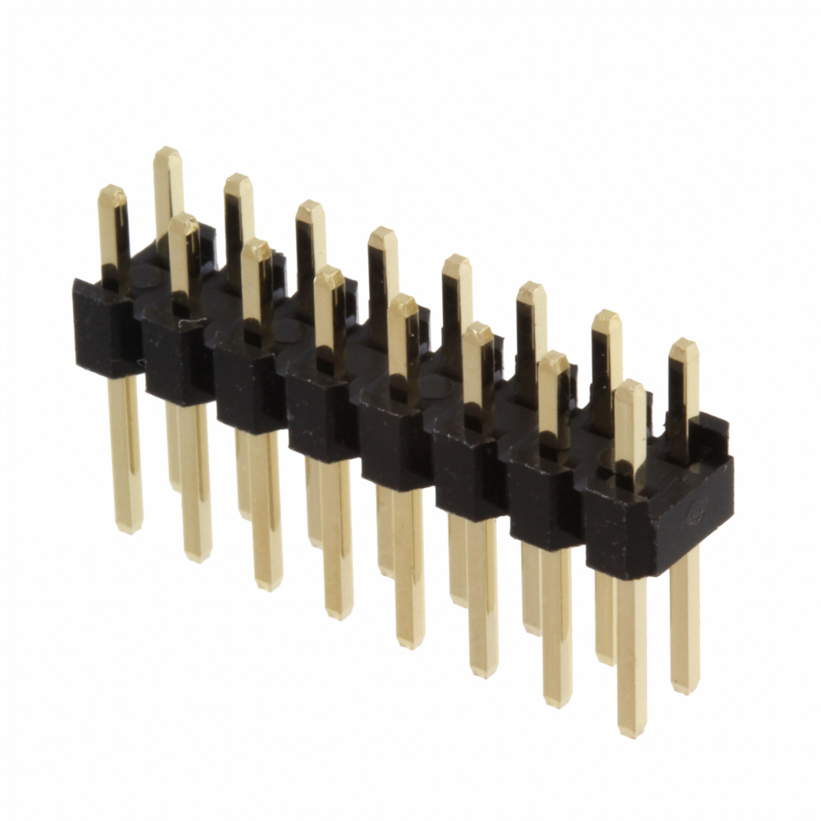

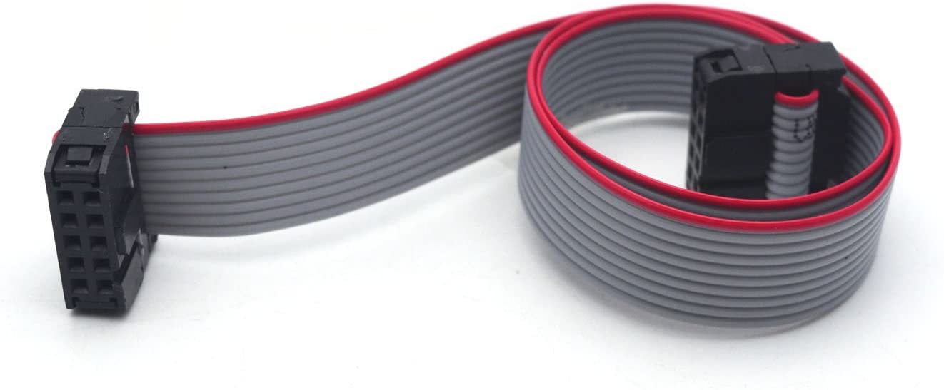

I would not recommend using board edge connector with printed pins for a DIY project. It will make your PCBs too expensive because you will need gold finish for wear resistance and reliable contact and an edge chamfer to ensure easy insertion. To wire my boards I use ribbon cable with 2-row pin header (see examples below). I place the selector PCB right next to the inputs and control circuitry somewhere else. This is cheap, simple, reliable and takes no more space than a board edge connector with printed pins.

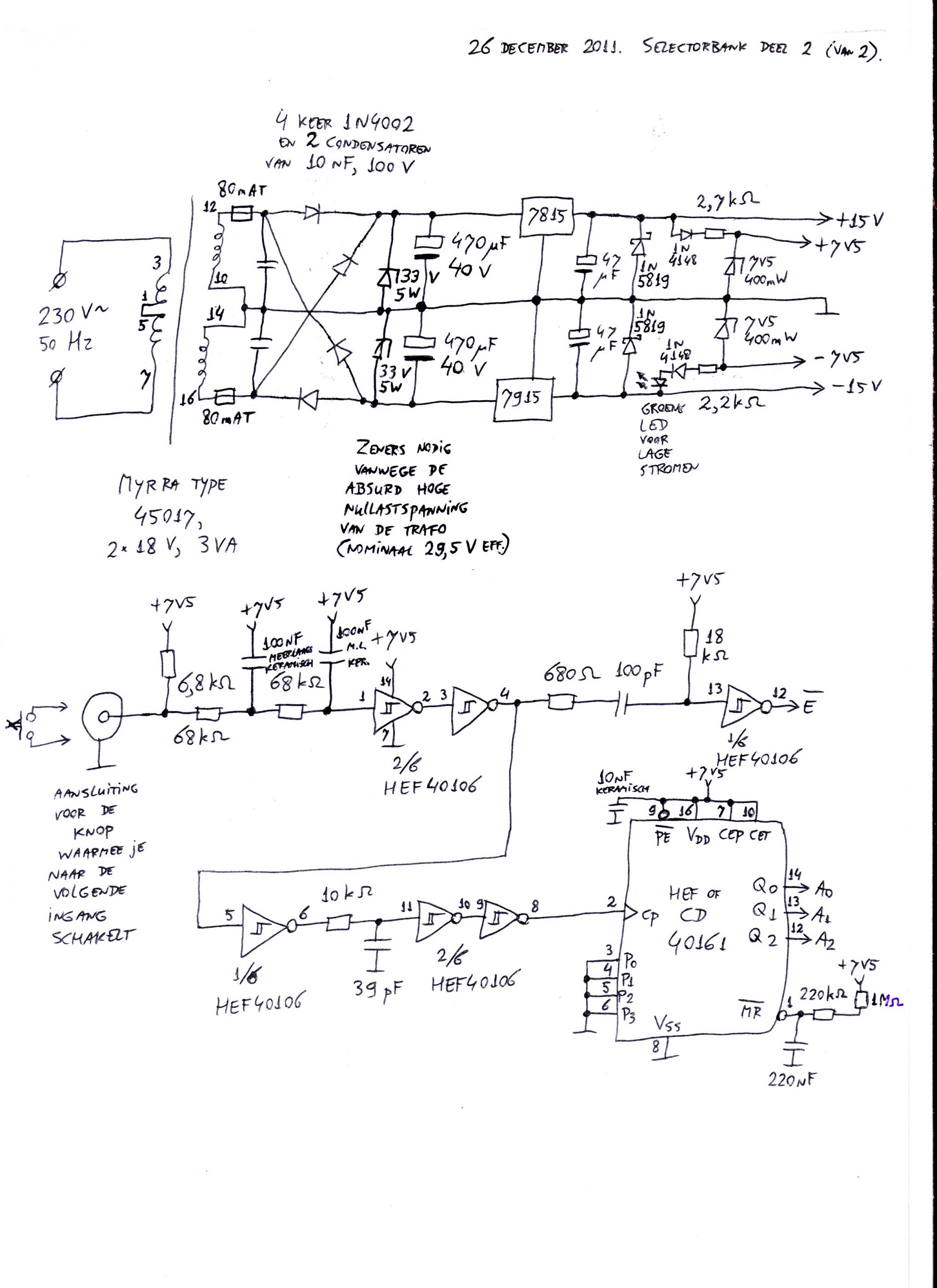

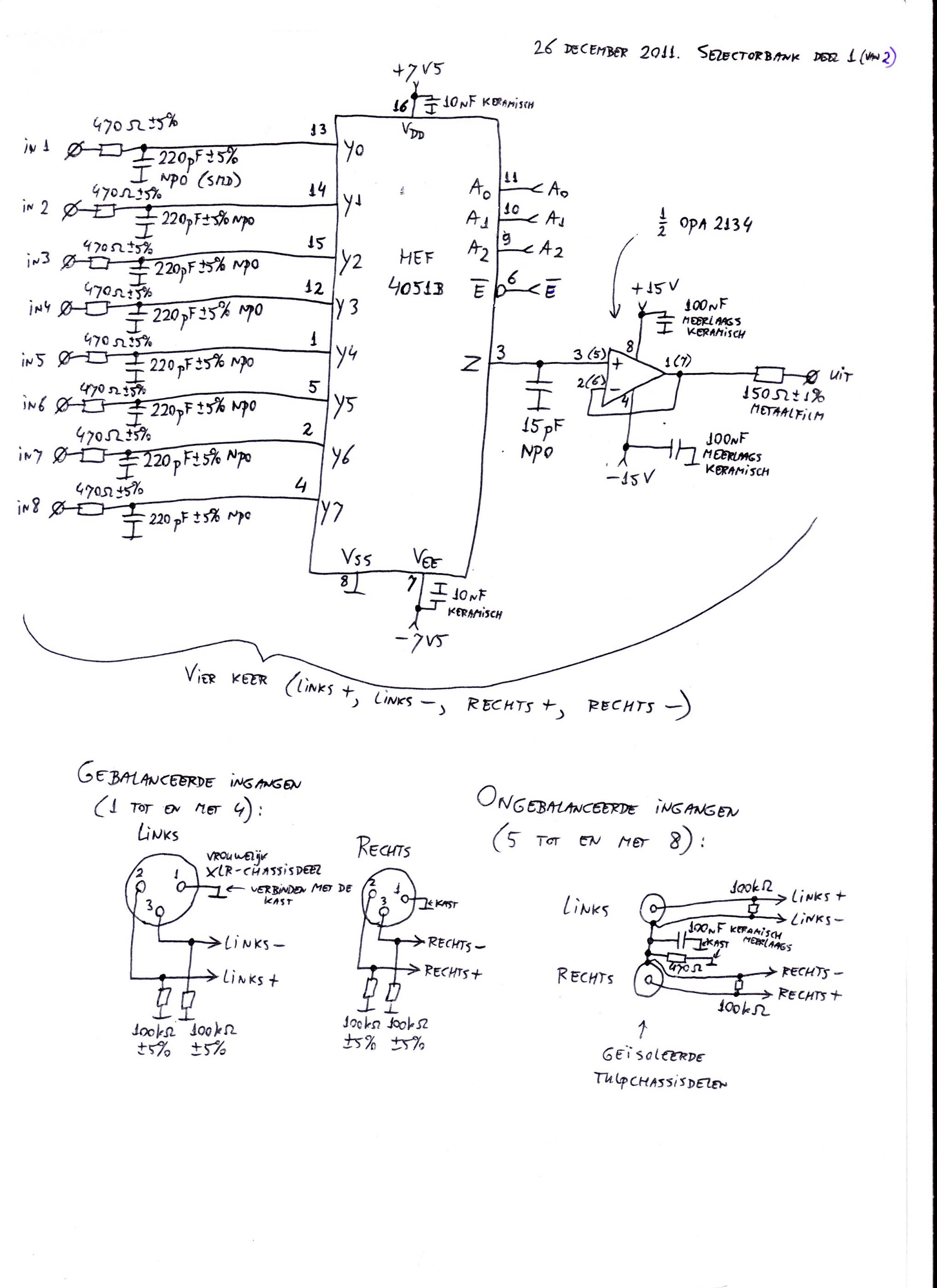

Attached are the schematics of a simple eight-to-one audio multiplexing circuit I built in 2011. It is controlled from a switching output of a mixing desk that works as a momentary switch; every time a button is pushed on the desk, the multiplexer switches to the next input. As it is a balanced stereo circuit, the part with the HEF4051 and 1/2 OPA2134 was built four times.
The OPA2134 buffer ensures that the on resistance variations of the electronic switches don't generate much distortion. The 15 pF capacitor spoils this a bit, I included it to remember the old voltage while the 4051 is being switched (break before make, using the enable input).
The 470 ohm-220 pF filters suppress any picked-up RF signals, but also limit the current that could flow into the inputs in case a signal goes beyond +7.5 V or -7.5 V. The 4000-series ICs are supplied from a Zener-stabilized supply with little decoupling to minimize the risk of anything getting damaged in case the input current should still be enough to trigger latch-up.
By the way, the 33 V Zeners were needed because the supply transformer has an unusually large ratio between the output voltages without and with load. Under worst-case conditions, the voltage could get a bit higher than the 35 V that the voltage regulators can handle.

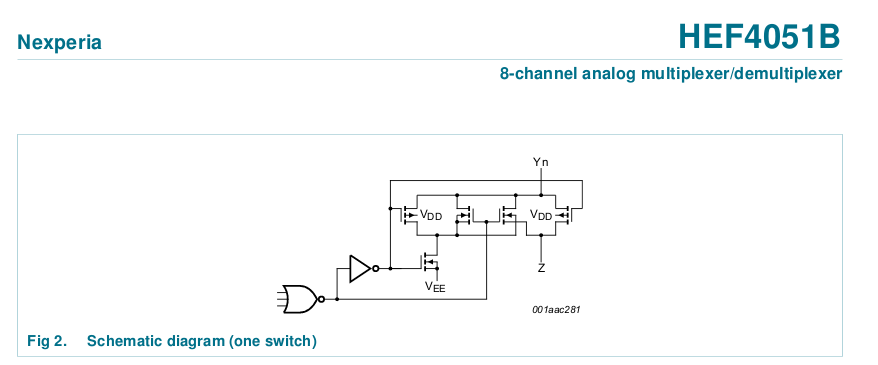

According to https://assets.nexperia.com/documents/data-sheet/HEF4051B.pdf , see the attached figure, the bulk of the pass gate NMOS is switched to the Y terminal when a switch is on, presumably to reduce on resistance and on resistance variations. Apparently the HEF4000 ICs are made in a process with N-type substrate, or at least that is my educated guess seeing that all PMOS bulks are hardwired to the supply while NMOS bulks are connected to different nodes.
As a result, you probably get substrate coupling issues whenever any terminal goes enough above the positive supply to cause forward conduction. The ESD diodes to VDD are probably series of N+ and P+ stripes placed straight in substrate. When an input goes too high, its anode, the substrate and the P-type source and drain regions of any PMOS form a giant lateral PNP transistor. The ESD diode anode then acts as the emitter, the substrate as the base and the sources and drains of all PMOS transistors as collectors.

Sorry, I meant to write that the sources and drains of all PMOS transistors and the switched bulk of the pass gate NMOS act as parasitic collector. That switched bulk is probably larger and more effective as a collector than the PMOS drain/source stripes.
