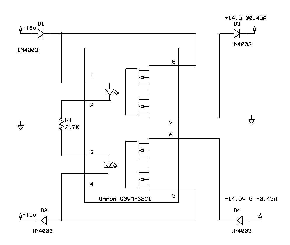

Here is a circuit I've used several times, although the SSRs (6 pin DIP) would run and hide if they saw your power units. 🙂 These are 60 volt low current.
This circuit guarantees that if I'm using two separate DC wall warts for the rails (two DC power plugs on the chasis) that neither rail will come up until *both* wall warts are plugged in. And vise versa both rails die together if either cord is accentally pulled out. Prevents the case of having one rail up and the other down.
D1 and D2 protect against reverse polarity (adaptor with tip negative instead of tip positive). D3 and D4 prevent circuit capacitors from back-feeding the LEDs and keeping the SSR on in the case of either supply being removed.

Here is a revised diagram with the diode drops added that I forgot to show. 🙂
With the diode drops it would be better to source with 18V if someone was trying to start with 15v, etc. Using schottky diodes would trim some more voltage drop.
