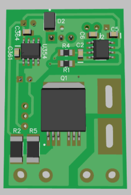

I'm trying to replace rail fuses with a current sensing circuit and a low RDS mosfet. This should eliminate the possibility of fuse distortion while better protecting the amplifier on overcurrent as well.
This will consist of two small daughter cards soldered in place of the existing fuse holders that are interconnected so if one protection circuit activates, it will signal the other circuit to activate, shutting down both rails.
I'd like to add provisions for interface with other protection circuitry in the amplifier to activate these as well. If a speaker DC detector activates, it would be nice to disconnect both rails from the amplifier before the supply caps dump through the shorting output device, for example.

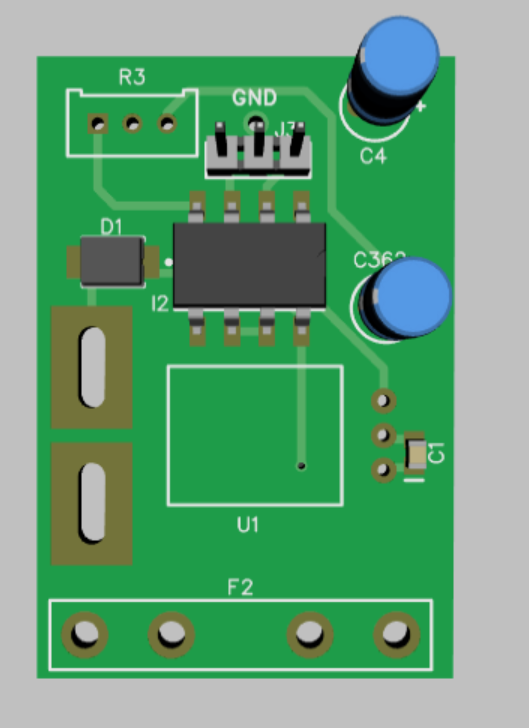

What I'm thinking of would be around 1 1/4'' square board standing up off the main amp board on leads from where the rail fuse holder would normally be soldered. There's around $20 worth of parts there. It's considerably more than a fuse and holder cost, but this is DIY. Who cares?:D

We didn't just design the protection board to adequately protect the amplifier. It's more fun to overbuild things and take them to the extreme. Much like you did with your output stage in your amplifier. I'm not in this hobby to just assemble some parts and make it work. I'm in it for the challenge of innovating new ideas and designs. I'm a hot rod builder for a living, so this is a way of life for me. The more people tell me it's a stupid idea and it won't work, the more I push to make it work.
To me saying it's overbuilt and unnecessary is like saying her boobs are too bouncy. Never!:D
In that light, I am sure your circuit kick the butt of the fuse, it's like the Roll Royce of protection.:up:
Prototype is ready. I get a few done with my next board order and experiment more from there. Inrush might be a challenge without a microcontroller.

A rail FET circuit can take out both rails, if control is properly coupled. In terms of the actual circuit shown, I see one fet, perhaps to take out the "ground"? Rail voltages can run from plus to minus without involving the ground, I don't see the point. My PV1.3k has only a 4000 ohm resistor between speaker and ground anyway.
One quibble with this circuit, I haven't downloaded the IC datasheets, but I don't see a latch to keep the circuit out after an overcurrent event. My circuit also has a front panel LED to show that the protection circuit is red or green. I also don't like three power supplies, I'm having enough trouble cramming in another wall transformer to produce one additional voltage. Putting this control circuit on the audio +-15 v circuit strikes me as asking for trouble, so I went to a separate supply.
Instead of hall sensors, I'm looking at using the voltage developed across the rail FET to set the defect latch. Optoisolators can shift the voltage developed around to other reference points like digital ground, as long as the voltage is >.6 v on the opto input diode. My target trip current is 25-30 A so this voltage is not out of the question. Right now my circuit latch is tripped only by the DC detection circuit previously installed to trip the crowbar SCR. I'll look up this IF8025 FET, currently I'm intending to use Fairchild FDP52n20 in the TO220 package. I'd like the same die in a TO247 package (long leads) but the bigger heat sinks seem to come only in surface mount parts with clipped leads.
I don't see the problem with inrush, my rail FET stopper is between the 10000 uf caps and the output transistors. I have only .1 uf ceramics at the output transistor board, and I added those myself, Peavey had no local rail capacitors on the transistor board at all. I stop inrush anyway with a CL101 thermistor on the AC line after the breaker, my PV-1.3k was dimming the room lights when I turned it on.
Edit, datasheetcatalog never heard of a IF8025.
The + and - on the schematic are for orientation. + goes to positive rail input on one rail. - goes to the negative rail input. Two of these boards interconnect through the mosfet driver module, so if one triggers, both are shut down.
This is in the early stages of testing. I haven't bothered with a latching circuit to keep things shut down yet. My own finished products will likely interface with a microcontroller. The first round is pretty much a proof of concept and something to hack to a breadboard when I'm designing something like this. I don't expect it to be a usable product usually.
Yes, supply caps can make a mess when things go south. We're building amps with upwards of 100000uF. That's a big whack when something shorts! That's the main reason I'm experimenting with this. I initially started experimenting with mosfets on the output rails of my power supplies, but the supply boards ware getting very large quickly. OS suggested this fuse idea and it seems to make sense.
