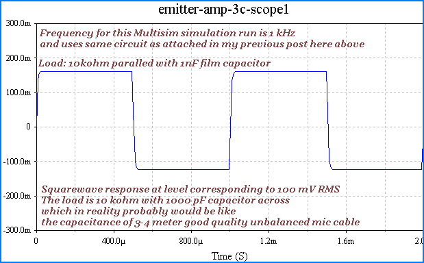

Lineup Microphone Amplifier with emitter input
here's the square 1 kHz at +-140 mV peak
with a slightly capacitive loading = 1 nF ( 1000 pF )
Enjoy!
Enjoy!

Lineup, looks like you are taking the output from the collector of Q1 and not the emiiter of Q4. Am I correct?
Why?
