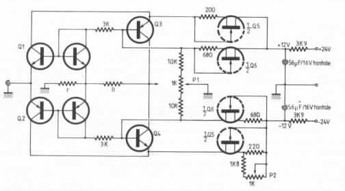

Is there any schematic out there for a direct coupled class-A RIAA preamplifier? Better to be a capacitor-less circuit...
I have seen this pre-pre preamplifier of the 80s but this is a pre-preamplifier for MC cartridges, to bring them in MM level, not a RIAA one...
Here is the pre-pre

Thank you Andrew!
I have also seen this design of hiraga. It uses 1-2 caps only, but unfortunately the article is in French so I cannot understand the details. It says something like this achiever the RIAA response using passive method...?
I have not seen another similar circuit thought...

Hello,
Here are the details translated, at my best:
Direct coupled transistorized pre-amplifier as decribed in november 85 japonese "Stereo music" revue.
Input stages are symmetrical & differential cascodes and are followed by drivers stages and push-pull output with MOSFET.
Between the linear stages wich gains are respectively 33,6dB & 27,2dB,
the passive RIAA correction takes place with passive components LCR Tango EQ-600P.
Total gain is about 41dB, the average distorsion ratio is 0,002%, between 10Hz & more than 40kHz.
Global harmonic distorsion don't reach 0,002%.
Et voila.
Some infos I found about Tango EQ-600P:
http://digilander.libero.it/paeng/inductive_riaa.htm
And, others with Google !
Regards.
Alain, from France.
