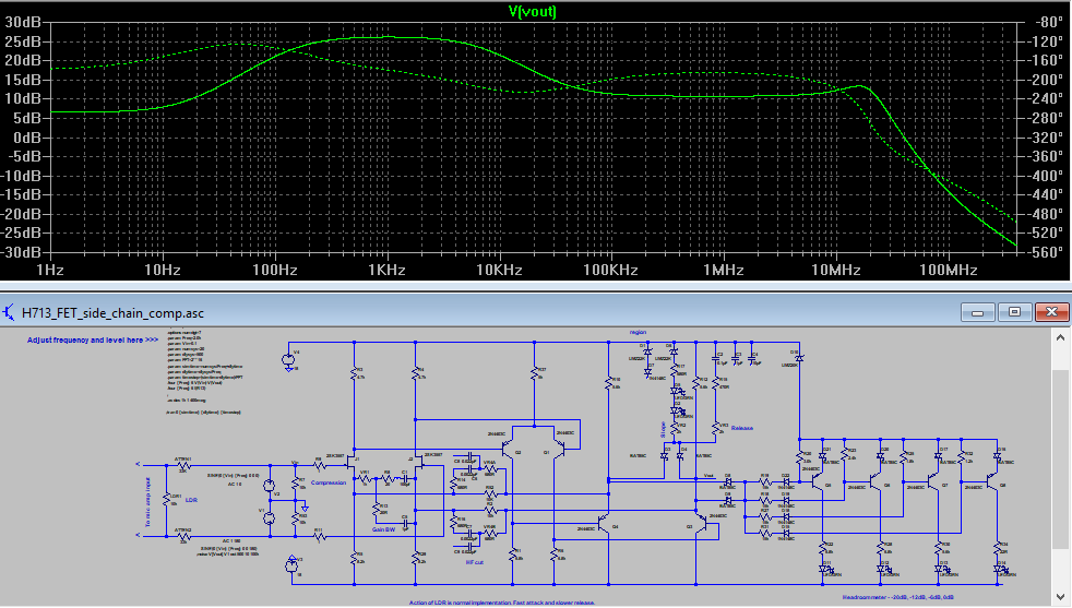

From the LA-2A mold, a side chain compressor. Some additions are present. HF boost or cut for keying, with turnover via selection of caps. A dual-gang control is needed for HF cut. The zener for the compressor LEDs is chosen so that with no input, the LEDs are just off. Additional diodes could be switched in series with the zener, so that compressor action is prevented until a certain level is reached. The slope control adjusts the brightness of the LEDs.
The side chain is parallel with the mic amp sharing the same input. The compressor LEDs and zener can be adjusted so that more LEDs can be added. This is to allow a variety of LDRs which may need to be paralleled due to high impedance of some photo cells.
A LED headroom meter is thrown in. The LEDs are not entirely hard switch on, but should be usable. The good thing is that no currents are pumped into ground.

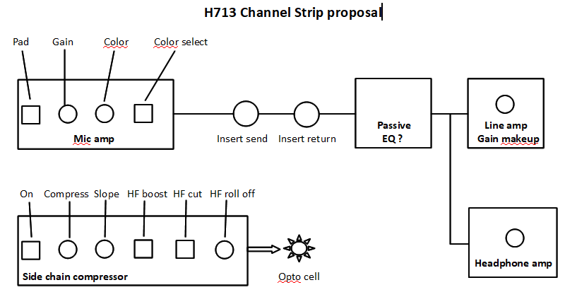

This is what we have so far. Leaning towards passive eq due to amount of R&D effort and ease of build. Unless some one comes up with a brilliant plan. As far as the modules go, fixed configurations may be useful for novices. What these design exercises have shown, is that an SMD uncommitted PCB with just transistor pads is useful because it can be populated with P or N, with a module on both sides. Therefore a two-sided module could be:
1. Dual channel
2. One channel + side chain
3. P and N for the distortion cancelling version
One module covers multiple functions because the transistor footprints don't change for P or N. The module could be edge mounted, or like a big DIL.
