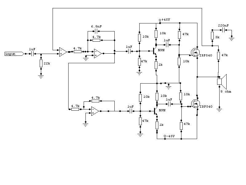

As there is no closed DC path through this circuit, the output of the first opamp will latch to one of the supply rails and won't function. The output will have a large DC offset and probably draw large amounts of current.

d'you think putting 100k resistors in paralel to caps will solve this problem ???

100W guitar amp from elliot sound product
hi, i've built the 100W amp from elliot sound product
but i'm using my own PCB design. the problem is that
the output from the power amp circuit tend to draw a
large amounts of current. can you help solve this problem
or do you know someone that expert in this field.
i've attached the layout of the PCB in the attachment. can you give me your e-mail address. my e-mail address is sovtek_svetlana@yahoo.com.
another thing, what is meant by closed DC path?

first off i think the minus input of the 1st op amp should not connect to the speaker outs. 2nd the input impedance is too low for guitar the 22k to grd s/b 100k to prevent loading the pickups.
i would use a quad op amp and the first stage would be a buffer.
3rd you have no tone or gain controls . install a duel 10 to 100k pot in the feedback loop of the 2nd stages replacing the 4k7 resistors. this will give some gain control.
