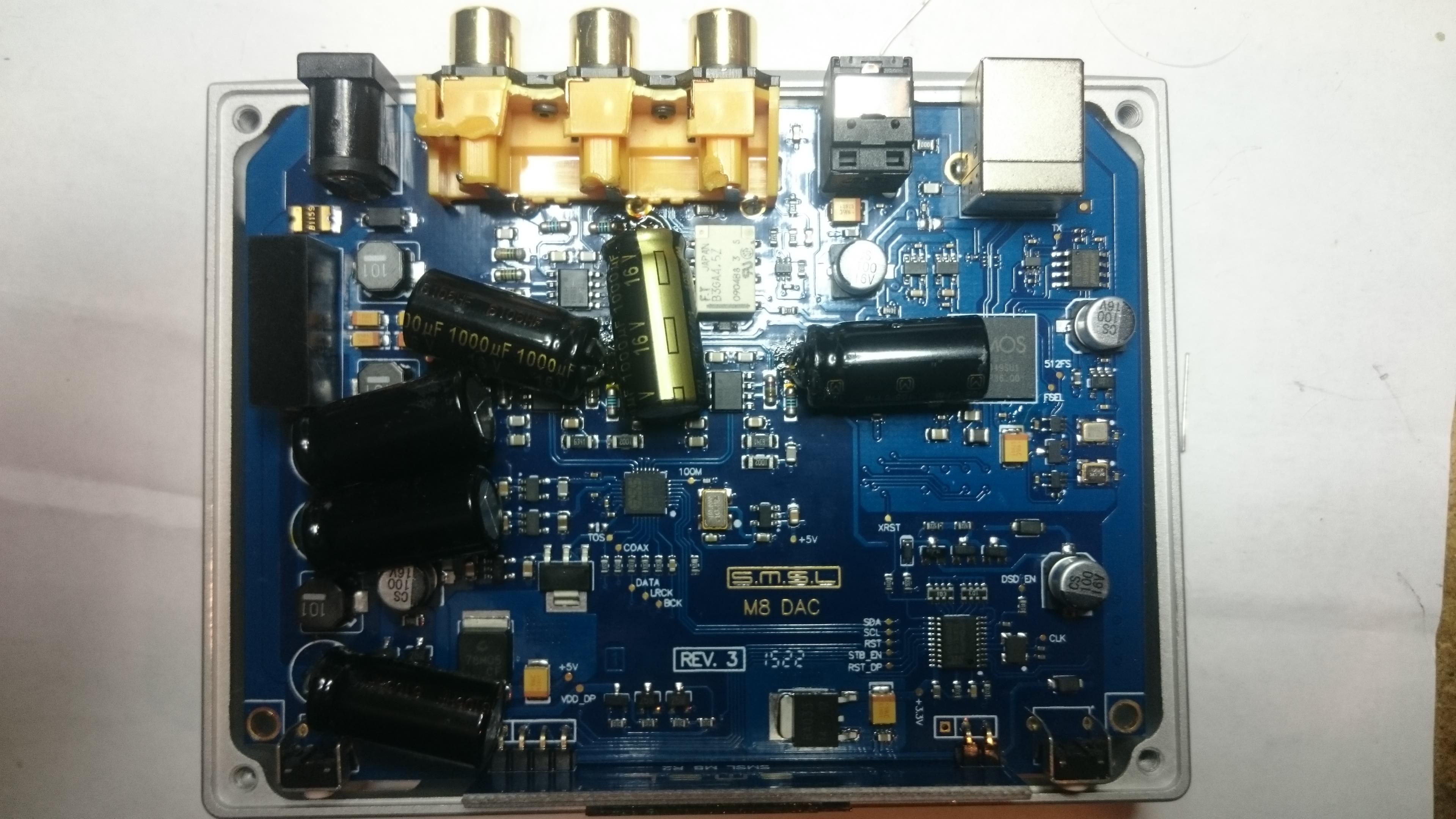

I was experimenting with Oscons in digital circuits - input and output C in voltage regulators and around digital ICs in DACs. They work very well in these positions and help render a very fluid sound - this is probably because of their efficiency in high frequencies. However, I found the treble to still be a bit grainy (I also used them for local filtering of analogue voltages in DAC IC) and I found tantalums to work better for me. Have no idea how Oscons work in analogue circuits but I wouldn't use them for signal decoupling.
I thought nothing better than trying for myself so I put a 180uf Panasonic SEPC on each of the positive and negative rails of the output filter/buffer op amp circuit for my AK4490 dual mono dac. Subjectively this was equivalent to a couple of dB improvement in the SNR. The improvement in SQ was more marked than every time I have played around with different capacitor makes in power supplies. In this particular application they seem to be miles better than Panasonic FMs etc. All subjective off course as the only test instruments I have are a multimeter and my ears.

I'm using low impedance, low ESR, low leakage lytic cap which I replaced the X7R's.
Improvements: More musical, liquidity smooth, very natural, not dry clinical as was before, improved bass extension, tonal balance, excellent decay. This DAC is audiophile grade now and beats up on $2-4K DACS ive heard. Also, OSCONS in this position are not as good either as they have a higher leakage rate.

I cannot say this is at all recommended.
Apparently your recommendation is based on 1970s college text books? . Because not only are the improvements there. Many other diy's on other dac threads have done similar, in removing the ceramics on the op amp power rails to be replaced with low esr caps and heard nice improvements. My own experience with a class AB amp, I also deleted the X7RS on the op amp power rails, with low esr lytics, and the Sq was amazing especially in the lf. Abraxilito I'm sure can explain the scientific theory behind it if you ask him.I cannot say this is at all recommended.
No, I'm reading plenty of datasheets, from Murata, AVX, etc.; I understand quite well what's going on. Have a quick read of what Marce wrote earlier in this thread.
Polymer electrolytic capacitors are great in specific locations, getting a good x7r ceramic capacitor local to your low-power, high-bandwidth chips is good engineering practice. Your higher value electrolytics can be a little further away, but you want that low inductance as local to the chip as reasonably possible.

You report better sound with the X7R ceramics removed. One possible explanation is that the MLCCs were paralleled using traces (ie, inductors) instead of the proper way (ie, GND/power planes). ESR of MLCC is too low. Using traces to connect several MLCCs creates a nice big resonance. A solution is to add a small resistor (like 0R1 in 0603 package) in series with your MLCCs. It increases the inductance a bit, but kills the resonances.
Note that power delivery inductance must be compared to the chip power pin inductance. There is no need to go much lower, unless the chip has lots of power/GND pairs. For an opamp, the package and lead frame already contribute several nH... much more than a MLCC. If several chips sit on the same rail, power delivery network impedance serves to prevent interactions, though.
As a final note, the inductance of a 6mm diameter aluminium cap with 2.5mm lead spacing is the same as a through-hole ceramic cap or film cap of similar physical dimensions. Which means "decoupling"' this elcap with a through-hole 100nF ceramic or film is useless (sometimes, worse than useless).
