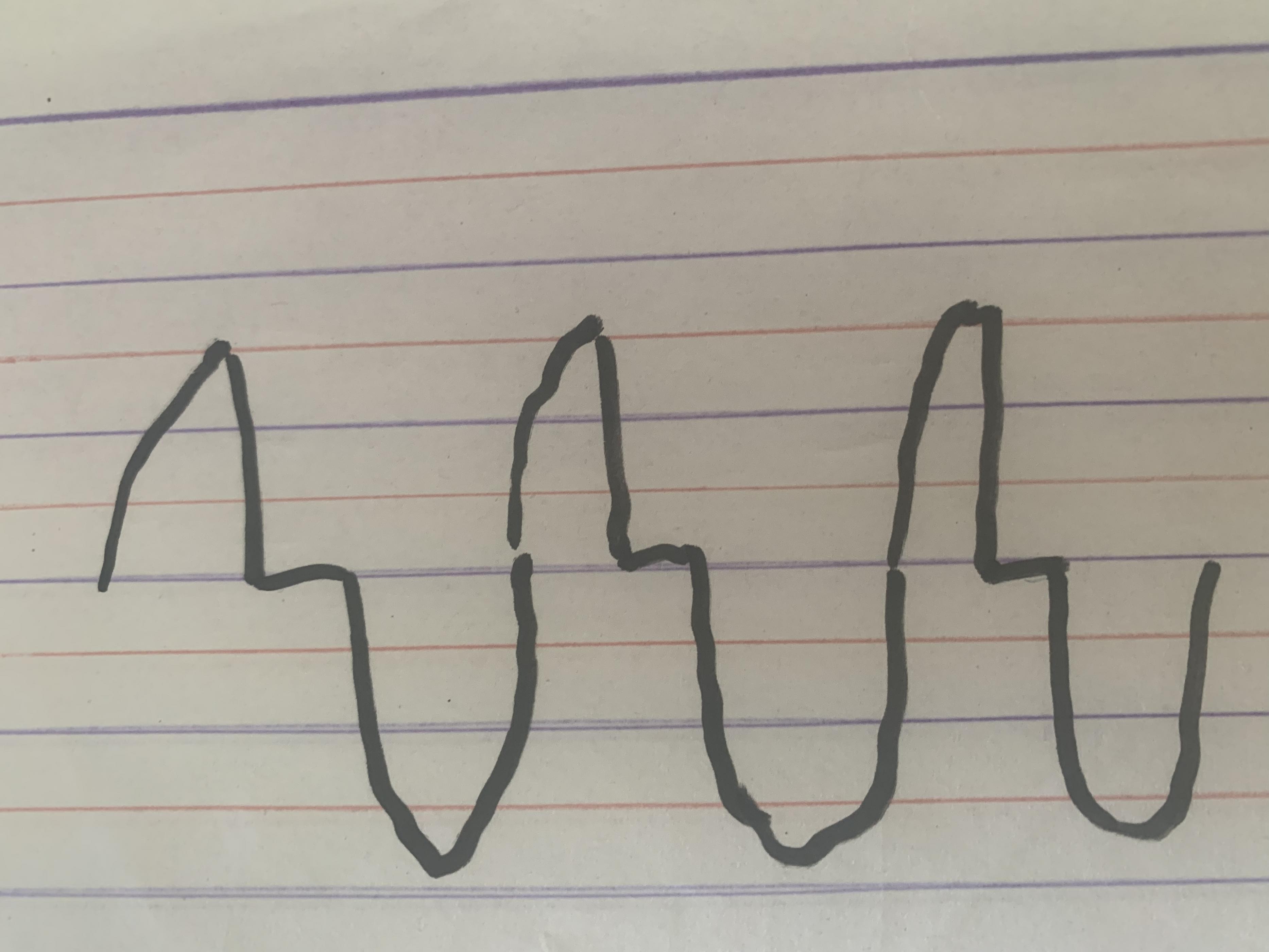

hello! i need your inputs, why my solid audio amp has a 65v single rail voltage? it has only 3 big bulk capacitors in parallel. im thinking it will not be loud as other that has dual rail voltages. other 1500 watts amps has dual +-80v to make 1500 watts. thank u

EDIT: your waveform seems to show that the positive half collapses under maximum load.
When/if that happens, disconnect load, or switch to a higher value one (i.e. 2 ohm>4 ohm) , what happens?
I see it more as an "output MosFets can´t handle the current" problem than anything else.
Maybe one blew open (or a related tracks) leaving the one(s) in parallel with a harder job to do, which is only noticed at highish power.
