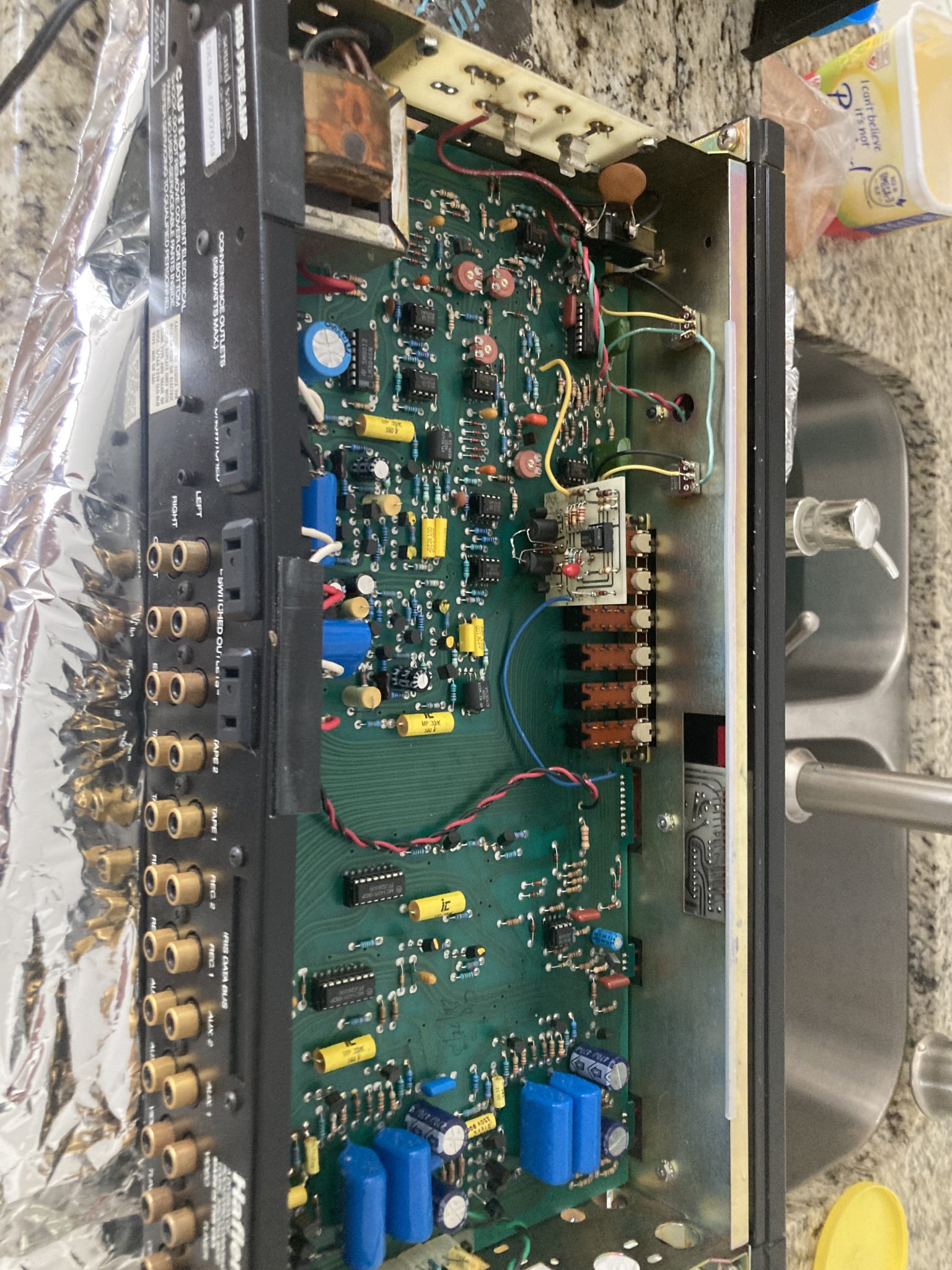

I have 2 Hafler Iris preamp and in both, the tantalum caps failed,

How many do you see in the preamp ?
At first sight on my phones screen: only a few.
I have never seen that device on my bench. 0 Experience means high error margin.
However I do notice silver mica caps, mediocre quality IC sockets and LDR based volume control.
That is up to you to decide, it is your preamp they will be used in.

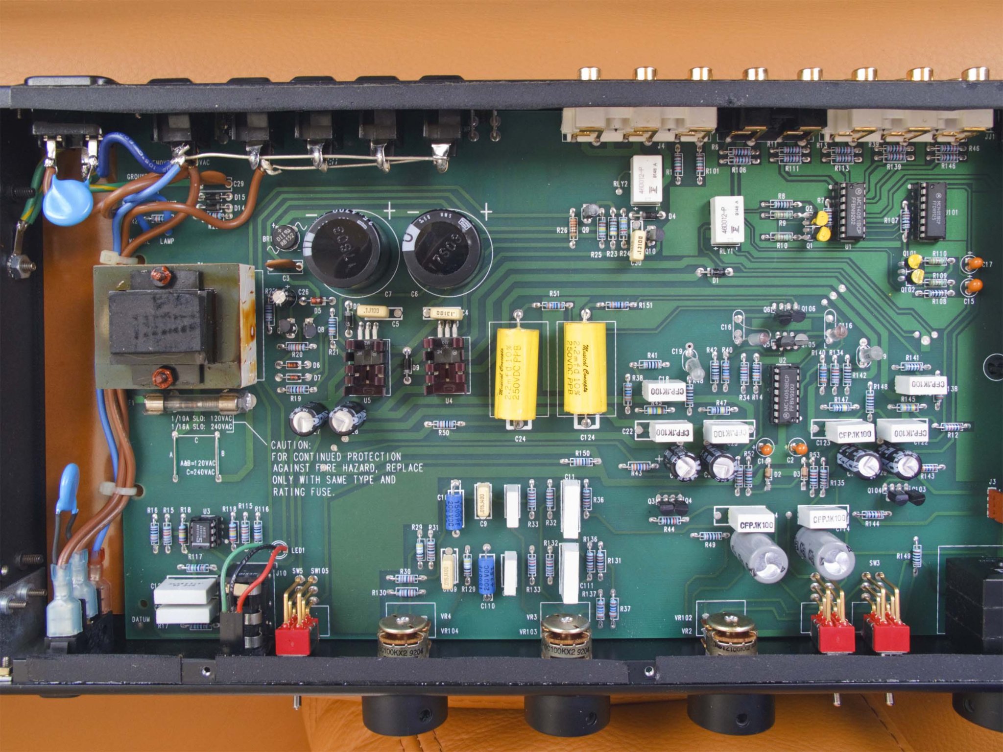

Got another Hafler preamp the 915, I see more than a few film caps, can you guys ID them ?
musical concepts caps ? are those polypropylene ?
what about the square white caps "CFP", what are those, film caps ?
C19, C16, C116 are those polyester ?
