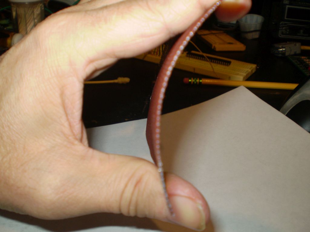

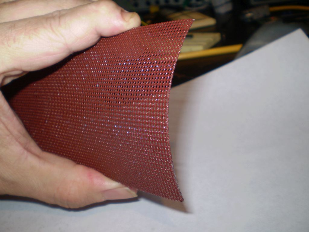

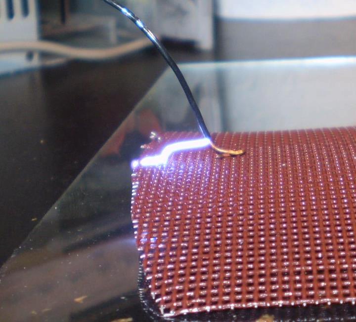

I forgot to post a few pictures of the window screen stator I had mentioned in the above post.
The First two show its flexibility.
The third one shows a test I did of it withholding high voltage at 13.8Kv without any arc through, except to the very edge where the coating was thinner and not coated at all.
I had made this piece about Two years ago and I just took the First two pictures.
If I tried that test again today I am sure that it would pass the same as it did two years ago.
The last time I tested this piece was about 8 months ago and it passed the test then as well.
Its width is exactly 3 inches wide and 8 1/2 inches long with about 6 to 7 inches of a quality arc proven coated section.
Enjoy!!
jer 🙂

Jer,
You sure like to push the limits... I'm surprised you haven't burned the house down 😀.
jer...is a littel fearless... but i would never speak for jar....
but we cant wate for others to push the limts....were all just here for sec.....
i have got great sound from doing mods others say are nuts....
The bias is a big part of the sound of any ESL panel.....i have found....i think as much as the setup tranx....an crossover....

I wanted to know exactly what the limit's are for ESL's and the materials used to build them and I wanted to use common off of the shelf items to prove how easily it could be done.
Knowing raising the voltages raises the level of sensitivity, I need to know how far I could go the the choice the materials I was using.
And every time you can double the bias without the thing arcing you gain 6db of free efficiency.
And going from your common 2.5Kv to 10Kv of bias voltage give you an incredible 12db more of gain!
But my materials stopped me from getting much past 10Kv on the last setup but I did get to 12Kv for a short time just to prove this.
This means that the amp only has to deliver 12db less voltage to perform at the same SPL.
1/16 the power!!
This means that you actually can get good performance with a smaller amplifier as well as a with small panel ESL.

The one thing that my uncle alway told me is that, "You must design for at least 50% more if you can't go 100%, or else it won't be reliable and you will spend more time fixing it than for what it is worth". 😉
1/16 the power!!
I can't imagine what it would be like if these methods were applied to a large panel system as I have yet to build one!!
I guess you could say....."I am obsessed with it" !!!! He,he,he,he,he,he 😉
