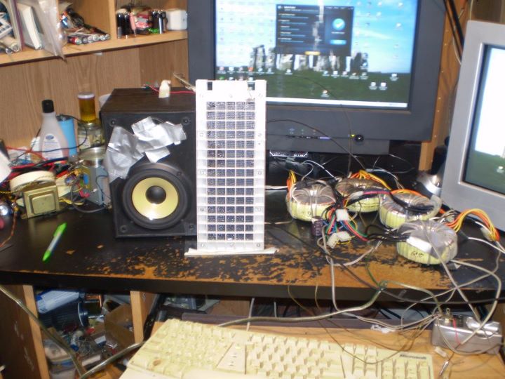

Hi, Charlie!!
Have you showed him my Little panel designs?
Does he plan on making it curve or flat.
My 3.25" x 9.75" panel competes very well with my 8" sub.
I would suggest that he uses no less than a 5.25" with it or even a 6.5" drive would be better.
The natural crossover point using my 5.25' woofer is about 600hz to 700hz and it reaches some very large excursions at less than 40HZ.
But the two drivers sound as one when I listen to heavy drums such as those from Montrose and Foghat on the extreme end of the scale.
And very whole in unison on softer stuff like ELP's "In the Beginning", Just incredible!!
Kansas, Boston and The Spin Doctors would just knock your socks off, and the answer to your next question Charlie would be, "Yes, it would" !!! He,he,he,he 😉
I found that the woofer (5.25" Sony) matched up perfectly as a sealed box rather than its original poorly tuned ported configuration.
This produced a clean tight bass with no muddyness.
He may have to employ a bit of equalization as well such as a variable linkwitz transform for the woofer or something to keep the heavy excursions under control while boosting the bass up a bit.
(I am getting ready to embark on this stuff for my system now as I want to get the amps crossovers and interface all mounted in case before I fire up my latest build so that it will be a complete unit and have HV and wires strewn all over my bench.
And for once call the project done and sit back and enjoy it for a change!!
I will keep every one updated on this as I go.)
Such that I would consider two of them per channel just to keep the package small.
Choose a driver that has the Highest Xmax you can find for the size he chooses.
The little Daytons are quite impressive in this matter but they do come with a cost.
The highest SPL that I could get to with my setup and still sound good due to the 5.25' woofers limitation was about 95db.
The woofer were right to their most extreme excursions of nearly 1/4" to 3/8" peak to peak as measured with a ruler the best that I could.
But they didn't sound bad at all pumping that hard and was not an issue at normal levels of 85db to 90db.
I was surprised that they could do that at all!!
I am working with what I have on hand, but I would consider those little daytons in a second from the videos I have of them in action!!
Have looked into building a mini TL but the length dictates the minimum dimensions for good performance and is no different to using a small driver or a bigger one.
I have though about using a aperiodic enclosure design is this would give the characteristics of being a sealed box but yet the vent will allow the woofer to breathe on heavy excursions.
This may give the effect to help highly dampen the cone movement as well, without restricting it like a sealed box would do.
My lager cabinets are setup in a similar way and the sound turned out very nice.
Kind like a openbox stuffed hard full of insulation or other dampening material.
This is something that I am going to explore once I get going as getting a decent bass out of a small system is a bit of a challenge!
As you know what the consequences are of putting the ESL in a box, I would advise not to do this and don't try to dampen the back wave.
I have tried this and it just destroys the high end detail and finesse that ESL's are noted for.
However, What you can do if it must be in an enclosure is to leave it open backed and line the 4 inside walls with some insulation of some sort.
Make the enclosure bigger than than the panels so that the tunnel is not smaller than the diaphragm size including the thickness of the dampening material.
This will help to enhance the low end (Dipole action F/B is greater) and the dampening on the inner walls will help to reduce any resonance's that would occur in between the inner walls of the box.
I have made a poor example mock up of this back in 2010 but I never took any detailed pictures of it as I was more focused on driving issues at the time, But it did seem to work good.
With 3" high panel and another 1.5"x 2 for the insulation would work out perfectly for a 5.25" or 6.5" matching woofer(s).
Another configuration that I have been debating ( just for some more idea's), is to build a 18" long version of my current 3.25" wide TiG rod design and mount it in the middle of a pair of top and bottom dipole 8" subs that I have.
I have also considered this design with just one sealed bottom 6.5" woofer (or two Top/Bottom sealed using a 12" long panel) for use as standing next to a monitor on either sides.
I hope this helps!!
jer 🙂

If you made many ~3inch x ~12inch ESL panels, you could experiment with different arrangements until you were satisfied.

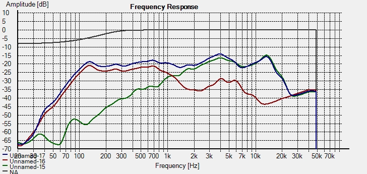

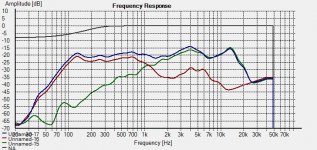

Yes, Your calculations for the 3" wide panel is about right.
I miss quoted when I said it was about 600Hz.
Here is my as measured chart using only the 80HZ and 12Khz shelving EQ's on my mixer to make my system flat and it clearly shows that there natural crossover point for the open panel to be about 1100Hz.
I did however use the sweepable mid to cut the highs out of the woofer but the panel only had the everything below 80 cut only for the amps sake and about -1db to -2db cut at 12khz to flatten it out on the high end.
Even without the 12Khz roll off that I used the difference was about the same and is only something that you can hear.
If I didn't do that then my ears would start to fatigue from the high end bite (NOoooo, I don't listen to music very loud at all........Very Much!! ). 😉
I would use a U-frame for the esl.
Even a 4.5" deep frame would make a big difference and bring your crossover closer to 400hz to 500hz range.
Had I setup my room for measuring this would be extremely flat.
But this was measured as is in front of me on my desk.
jer 🙂
P.S. Even just a 1/2" to 1" batting on the inside would work well if size is a very stringent factor as long as it does not block the path way or obstruct the paht way toward the opening in any way.
I have been thinking about applying this to the Desktop Version as well to try.
