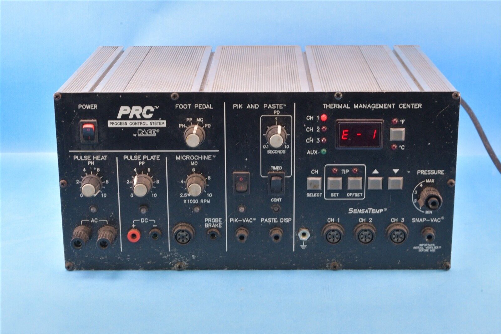

Definitely overkill, but great price at $149
