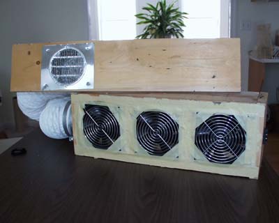

Homebrew Fume Extractor
I did exactly this a few years ago - got 3 cheap surplus fans, some dryer vent hose and fittings, and a little scrap lumber. I run it off a surplus 12V power supply. The wood piece on top in the photo fits nicely into a nearby window which gets shut on top of it. The exhaust grate keeps birds from nesting in it, etc. (recommended). The unit is a bit noisy, but sucks everything out of the area.
If you build one like this, I wouldn't use it around solvents and other inflamables - especially if you don't use brushless fans. For soldering, it works great, though.
kropf said:Everything I've seen so far (except moving outside to solder) recirculates the air into the same room.
A slightly more expensive option is to pick up a bathroom exhaust fan and mount it on a 5-sided plywood box (made with scrap) with the box opening facing your work area. Connect the exhaust with some flexible dryer-vent tubing out through a window. Home Depot has a model that sells for less than $13 in my neighborhood. Total DIY exhaust hood project cost: less than $25.
Sorry, no pictures.
Jeremy
Disclaimer: I make no guarantees on the effectiveness or legality of this or any other approach to ventilation.
