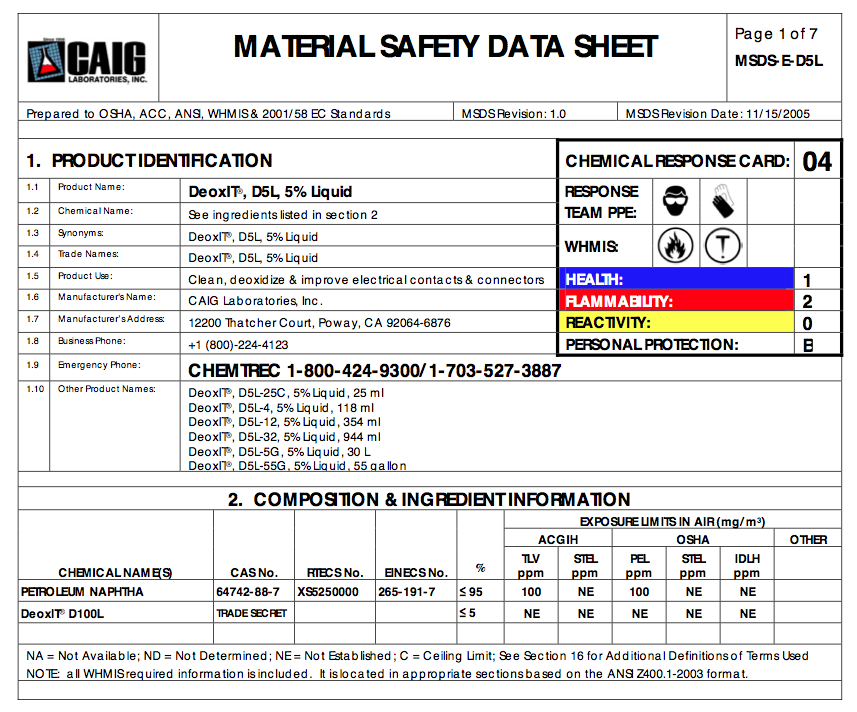

I meticulously made 8 sets of rca’s using Cardas 60/40 solder, while flushing with c02 and cleaned seald with deoxit G5 gold, and enamel clear coat over the solder joints.
This sounds like a comedy of errors:
1) Flushing with carbon dioxide?! You're soldering, not welding...
2) Cleaned with Deoxit G5 Gold? This is a lubricating contact cleaner containing almost 75% petroleum naphta, aka 'oil.' Once you have properly soldered the joint, it is no longer a 'contact' or 'connector,' but a permanent mechanical joint.
3)Enamel clear coat? Over the oil, and over a solder joint? Why?! To poison yourself when you have to re-work it?
Cardas 60/40 is good enough solder, so stick to the basics of good soldering practice...
To Andersonix, I read some very detailed instructions on my method for soldering that also included reasons for those steps. I followed them to the "T".
1) It said That factory made cables are soldered and assembled in this o2 free environment, so there corrosion over time.
2) Detox it D5 is a cleaner G5 is a sealant, I think you confused the 2.
3)Before I seal, I clean the joint with alcohol, the seal with enamel is to keep corrosion out permanently.
No, in this case I'm not confused: I looked up the MSDS for what you said you used (G5) and reported what I read. Now I have also looked up the MSDS for D5, and they appear to be EXACTLY the same stuff...
Please help yourself to all the Caig MSDS:
MSDS - By Category (New GHS Format)

Deoxit is great stuff (helps keep an LED video wall working near the ocean) but I can't see it as good for solder prep. Anyhow, you've got the answer on the acid flux, not a good idea.
