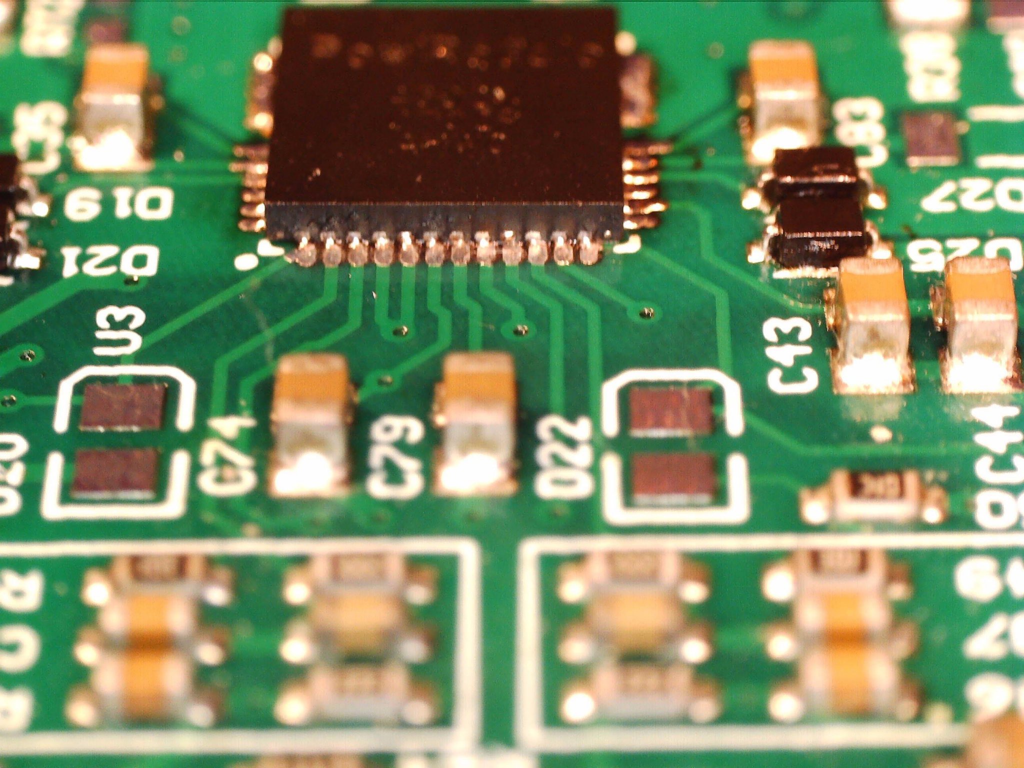

A little progress here the last day of the vacation. Now got the 2 chips soldered. Quit satisfied with the result.
Used a good deal of flux, then soldered dragging the iron over the pins, then used some solder wick to get rid of excess solder between the pins.
Will say it was not so easy, to really get the "legs" on the chip to show nice solder flow.
We'll all know when it is all assembled 😉

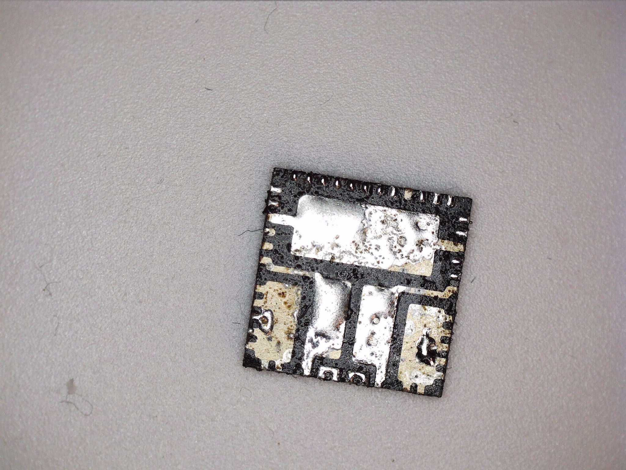

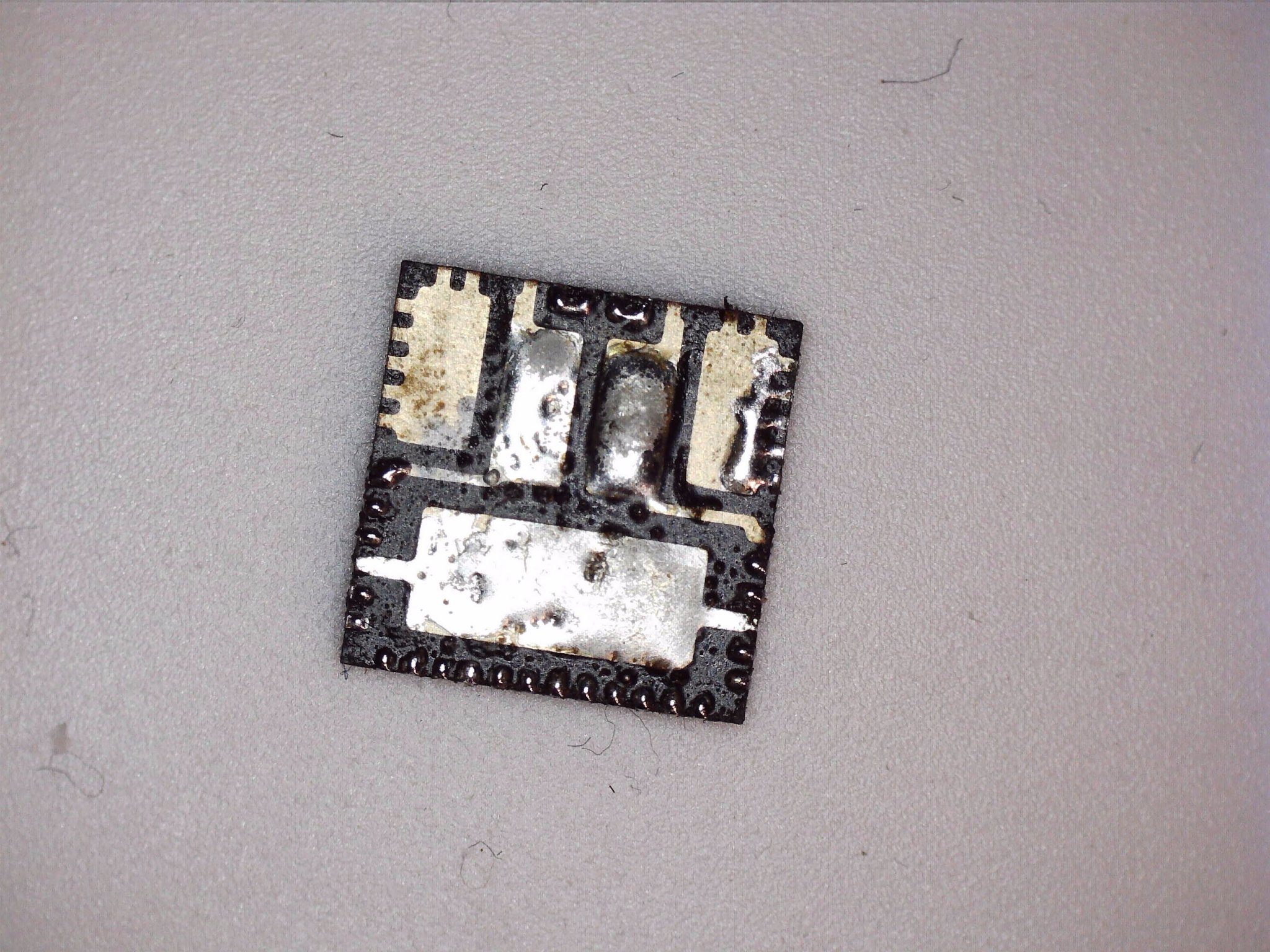

Almost same story for the other chip ....
Had hoped that desoldering one might have left the other one working .... but no such luck
And yes no wonder it didn't work 😉
One good thing though. After removing the 2 chips all the PSUs work as intended ..... but with no class d chips it doesn't really help 🙂
One learning could maybe be to pre-solder all pins and areas on the chip with some good solder and remove most before soldering to to the board.
Like with cables, wires and others it's always good to pre solder to get an easy solderable surface before joining
