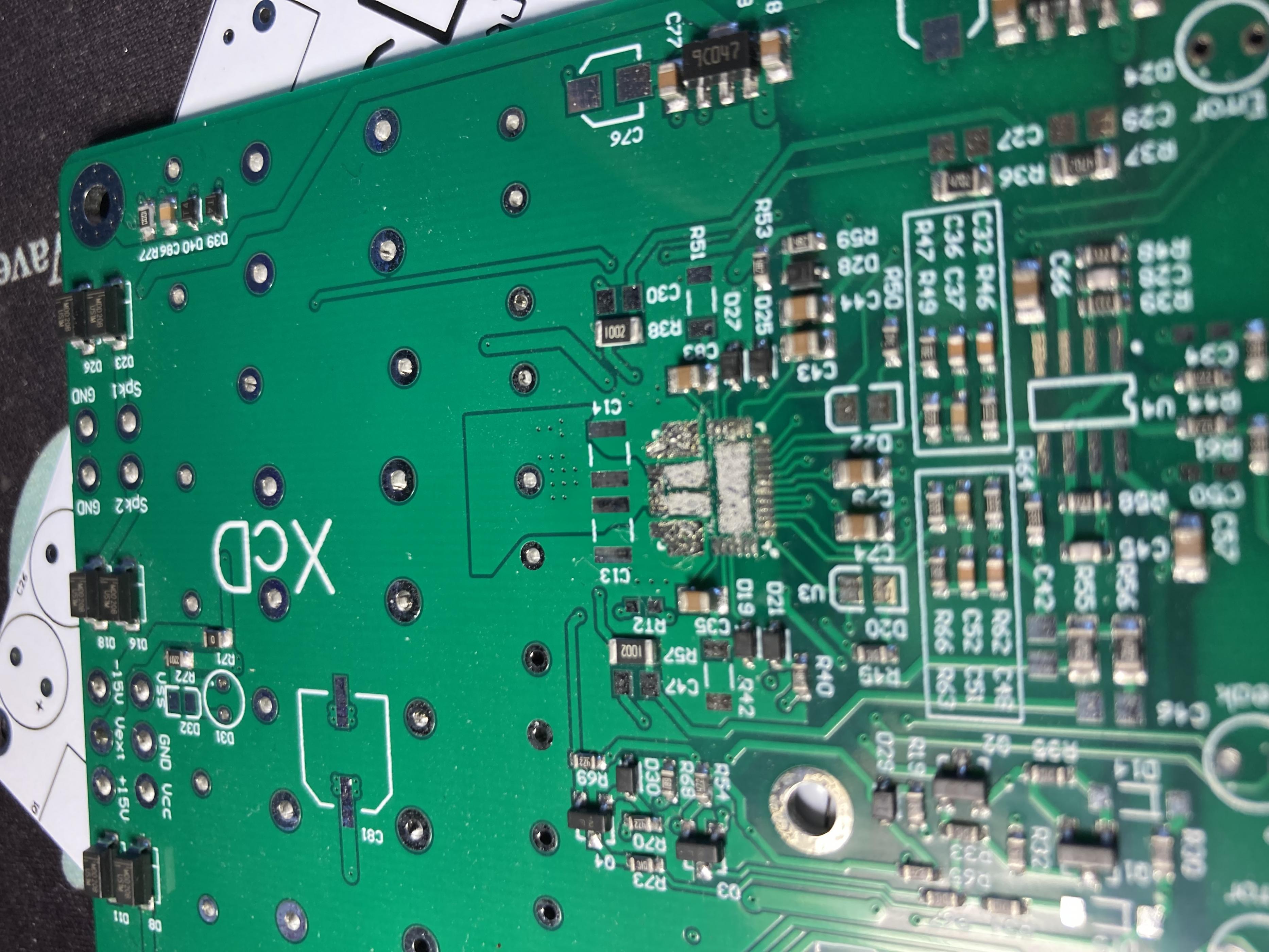

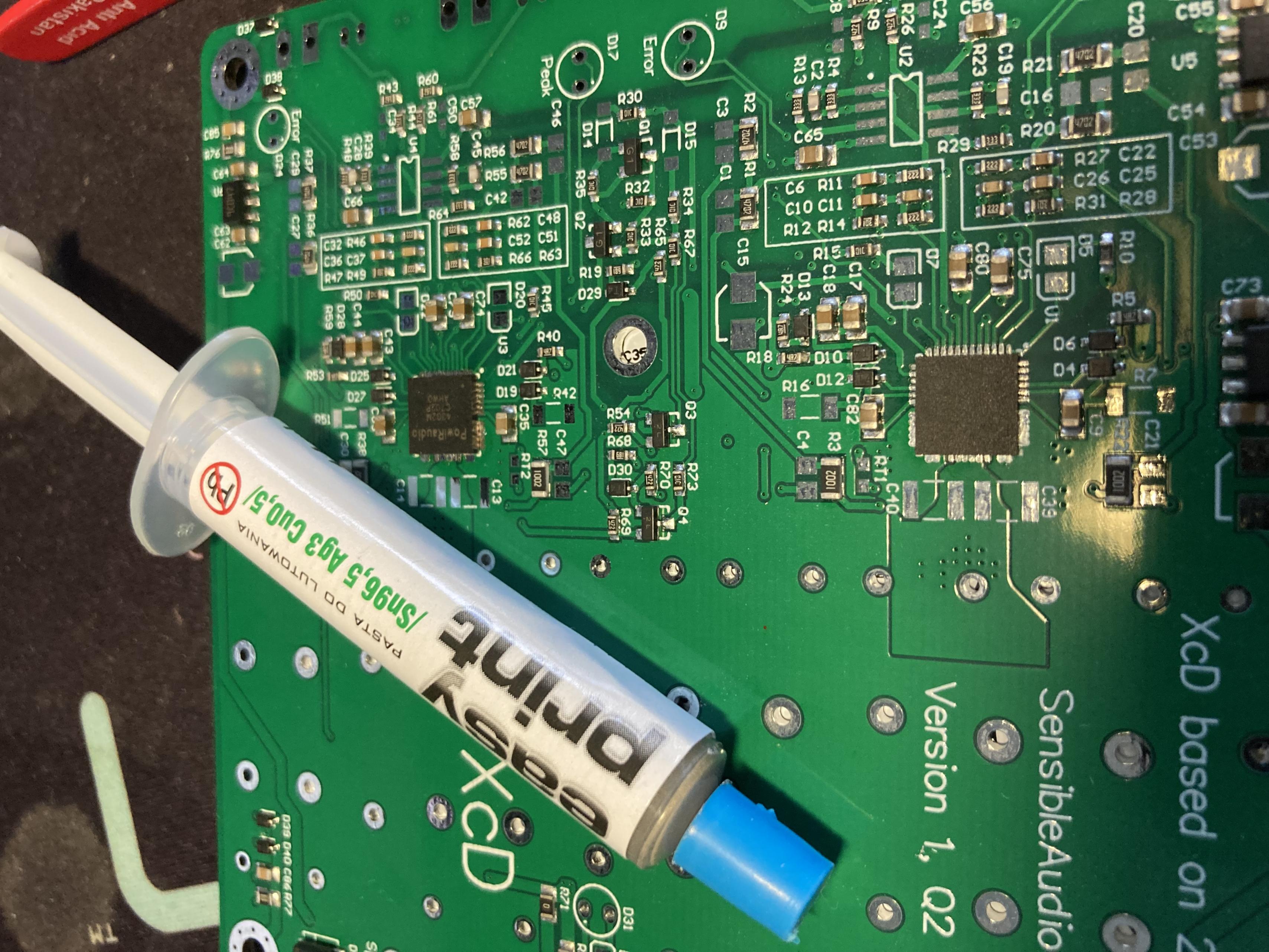

Got some new solder paste from a shop in Copenhagen ... yes a real shop 😉 ...
Cleaned surfaces and put some paste on the inner pads.
Placed as good as I could .... man would be nice with a microscope
A it hard to place as it did not really stick well. I used a quite limited amount of paste not to make any shorts ...
Used a hot air gun like this:
SMD loddestation - WEP 858D - 700W
- Matronics
Tried to follow a reflow profile, heating up to 160 deg for ca 2½ min, further to 250 deg for ca 1 min, and then slowly cooling down over ca 1 min
Will take it to work on Monday to check that the alignment is spot on inspecting with a microscope, before I solder the other pads!
Is this a difficult soldering ... I bet ya 😉

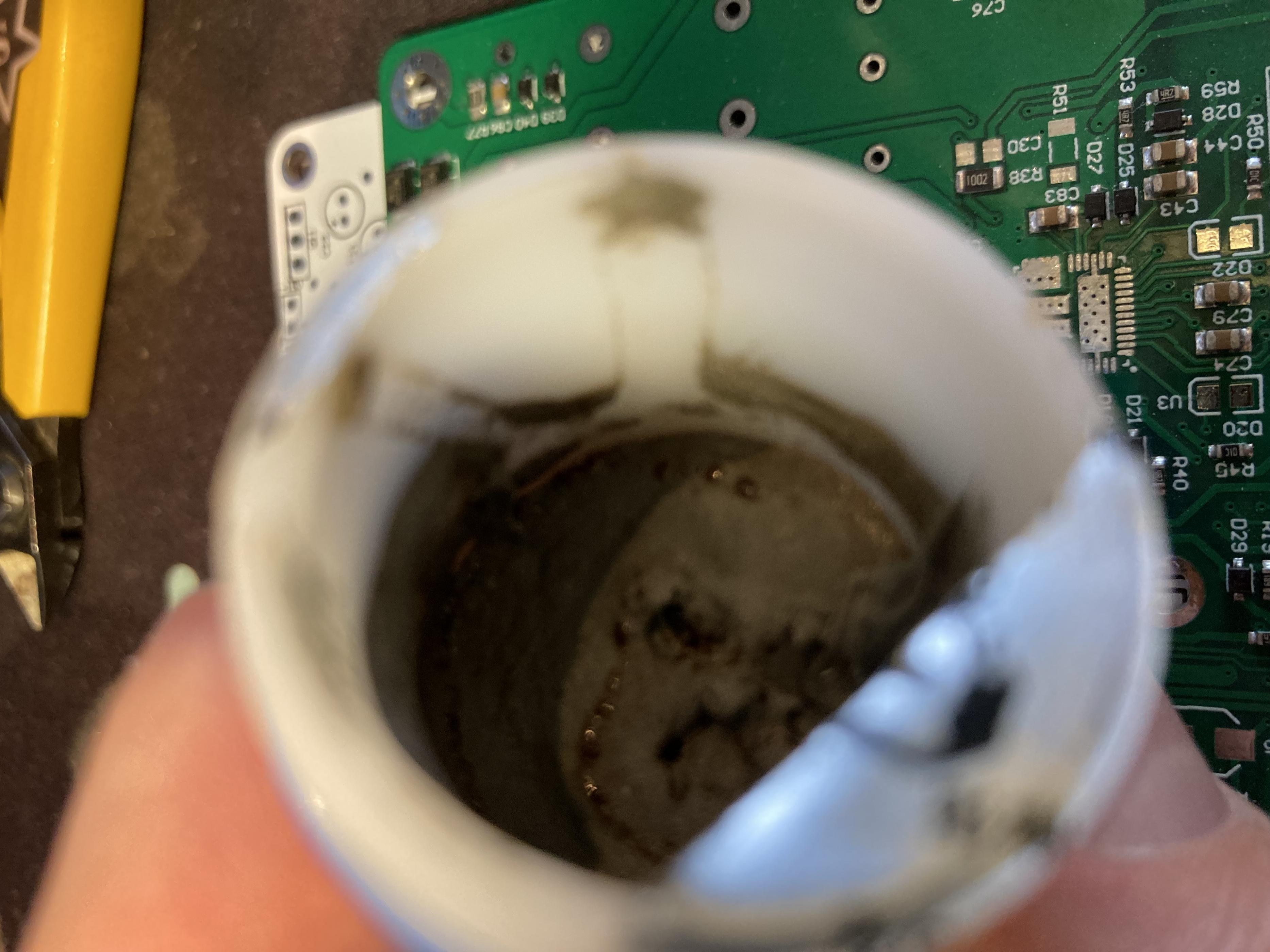

Another attempt, and realizing that the other chip is not soldered well at all either. The paste has jus dried and have thereby glued it together a bit.
Off we go, and try again.
But I simply can not get enough heat under the chip. Tried to heat the board up from underneath before heating from the top, but no chance.
What is not helping is that the pads underneath is used for heatsinking, and the board seem to work quite well for this .... but also therefor transferring the heat elsewhere!
And modern Pb free solder paste is no help at all either .... flows really bad even if you just heat it with a soldering iron!

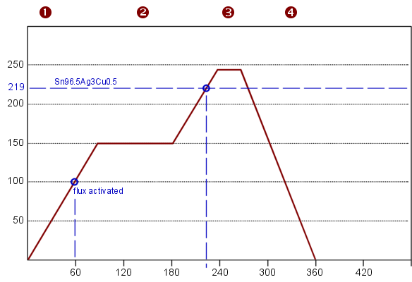

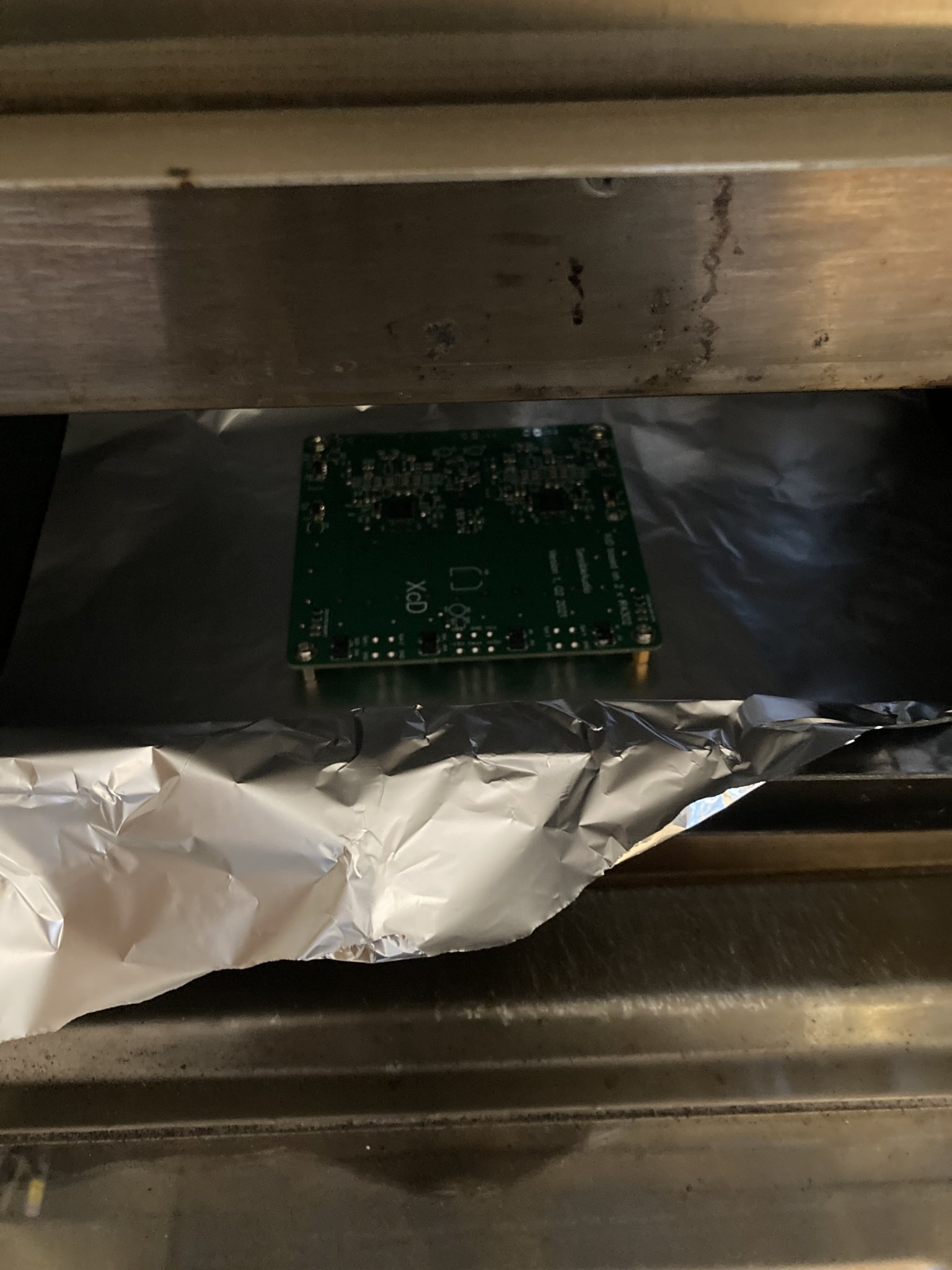

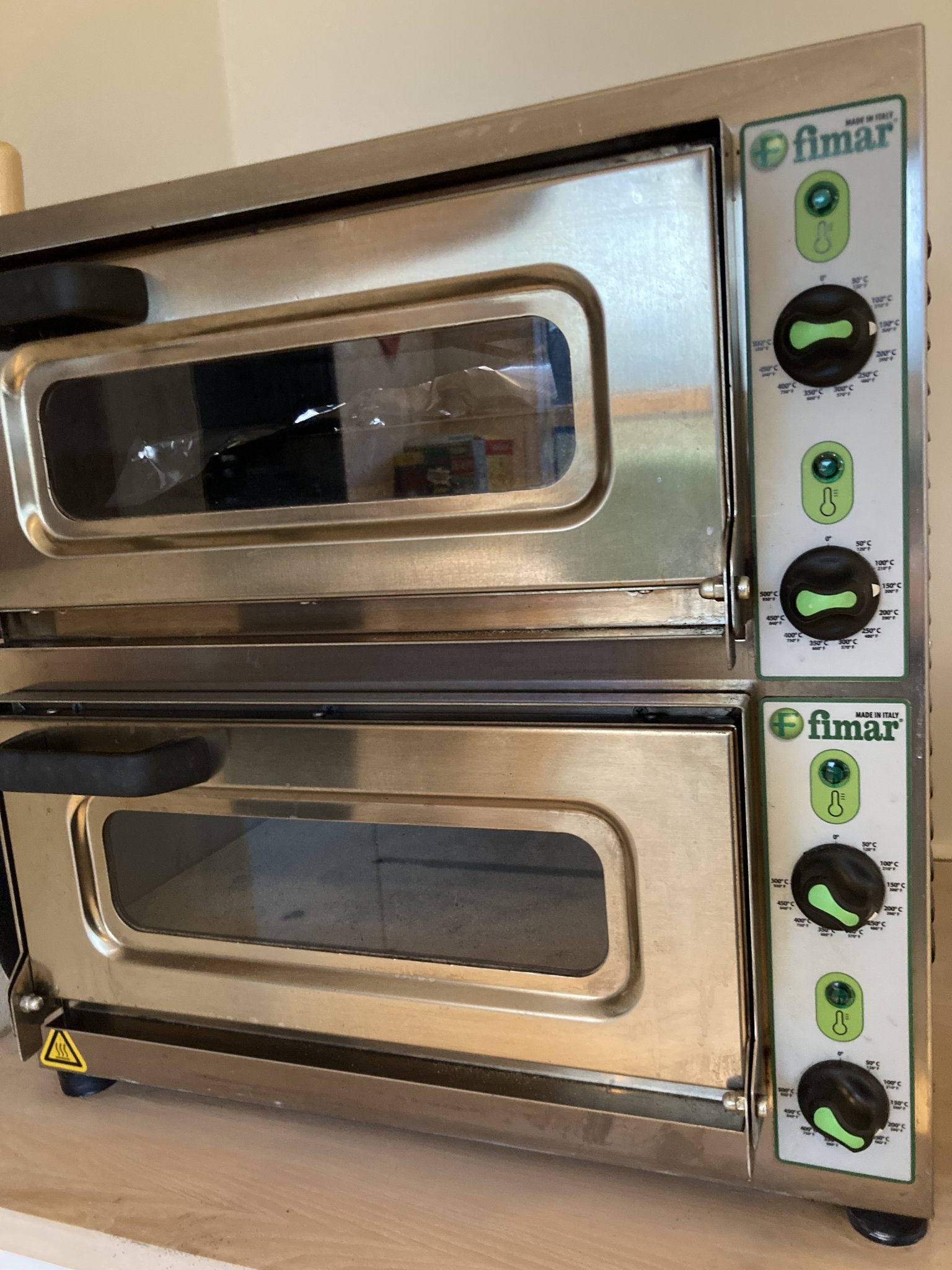

Been thinking about using an oven .. well actually 2.
I'm blessed with a real pizza oven with 2 shelves ..... highly recommended for those Friday nights 🙂 ... but that´s another story 😀
One like this: ELECTRIC PIZZA OVEN MICROV2C - Fimar
I can regulate the temperature independently in both ovens and both for the plate and the upper temp.
I was thinking of using one as a preheater on 150 deg C, and the second on 220-250 deg C.
Then put the board in at 150 for 3 min, and then switch to the other oven for 250 deg C for 2 min, and then out ...
It would sort of mimic a reflow profile like the attached.
I would place the pcb on a piece of alu foil to protect my beloved ovens.
It will of course reflow the other components, but think that will be ok.
Yes I'm missing a stensil ... but will have to do with a tooth pick a careful amounts of paste

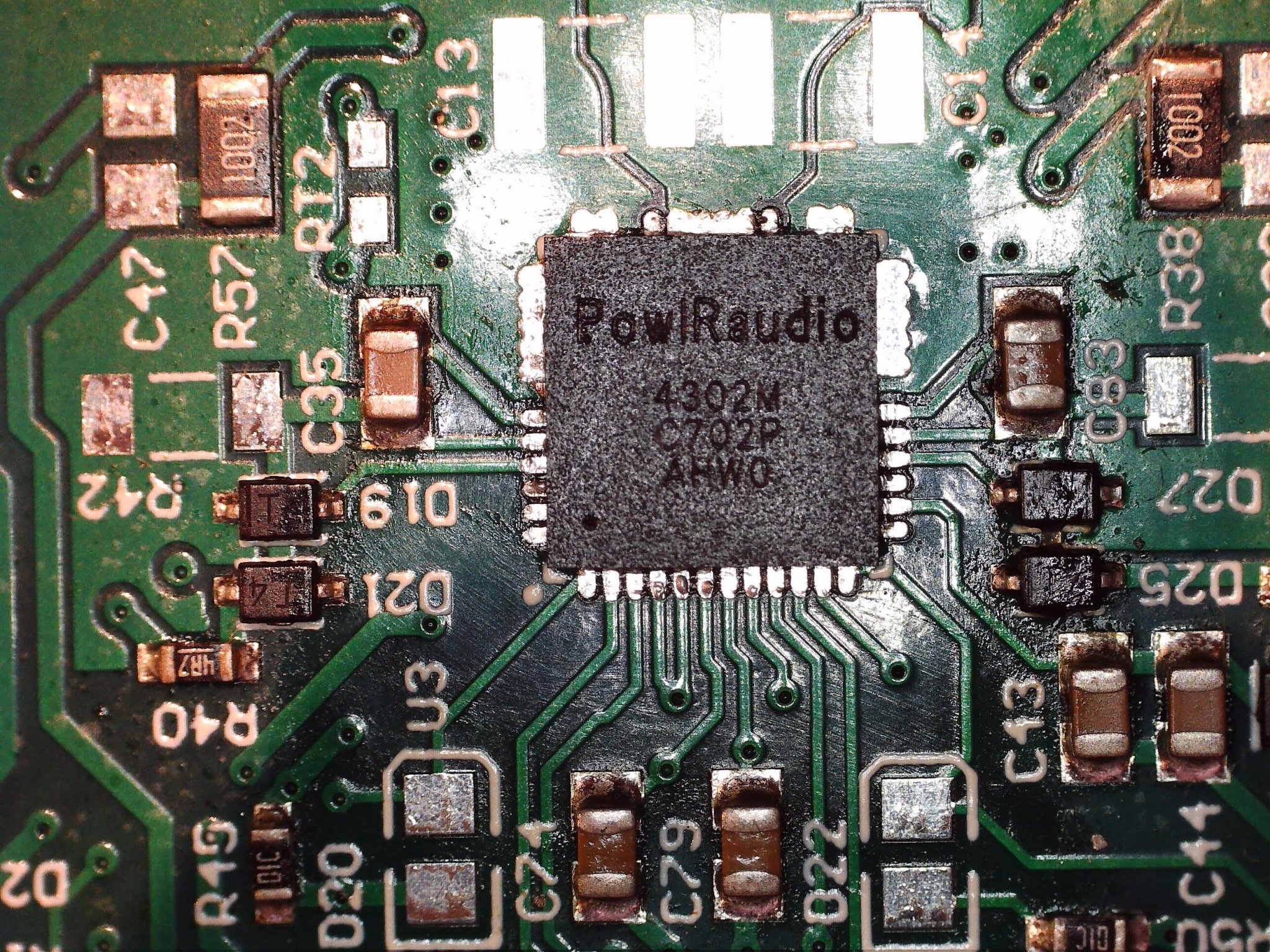

Ok, has taken a while ..... maybe mostly to take on the chance of baking the board in the oven .... but here goes.
I set the lower oven to 150 deg, and the upper to 250 degree.
Gave the board 6 min at 150 and 2 min at 260 degree, took the board out for immediate cooling.
I only applied solder paste to the inner pads.
So next step is securing that no pads are soldered together. Will do that with a simple ohm meter. Layout around the IR chips as last picture.
Then soldering of all leads, and then checking with the ohm meter again.
Final step is to mount the rest of the components and hold ones breaths and cross the fingers ...... let's see whan that'll be 🙂
The close up of the chip is with my new microscope 😉 .....
