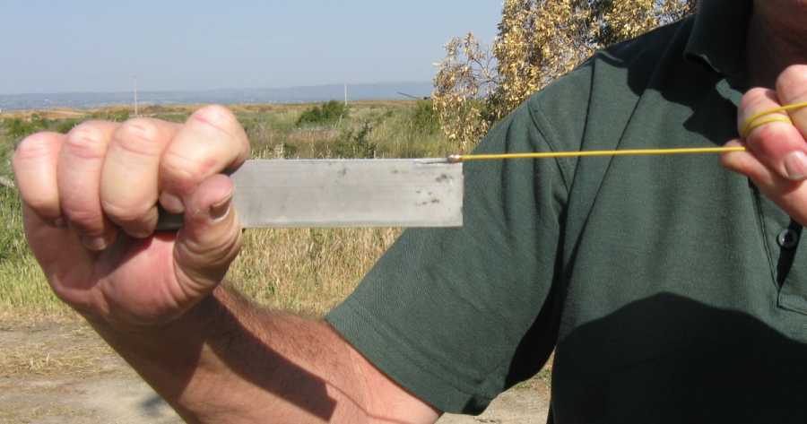

There are companies making aluminum products for torch "soldering" aluminum. They look like some aluminum alloy rods. You use a small hot torch like a butane torch or a MAPP torch (using cans from your local hardwre store, but hotter than a butane torch) and these rods...the technique is similar to brazing except you do scratch with the rods quite a bit, probably scratching thru any oxide layer. Do a search online. I don't know whether the rods have any kind of flux. There used to be some interesting infomercials on TV, might still be on youtube. I never tried it, since my friend Bobby next door has a huge TIG, and is a real aritisan, epsecially with stainless. On lesson with TIG on aluminum: it uses a LOT of current because it needs a lot of heat because it conducts heat away so well. For welding on my motorcycle frames, swingarms, and for stage lighting trusses I use aluminum MIG instead of TIG, shooting MIG wire (with Argon, not CO2) really makes a big fillet quickly compared to the delicacy of dipping your rod into a pool and controlling the heat with your foot pedal on a TIG. MIG I just set voltage for desired arc distance and the wire speed is kind of like current...

Yes,I have seen the stuff it is called Alumaweld and it is $40 a pound and they refuse to send me a sample stick to try for my application.
I have seen a live demo of it ,But not on an application such as mine.
As I have mentioned earlier I have a TIG welder,But I have not yet invested in the argon setup yet.
So, I am looking into possible cheaper alternatives although there may not be any.

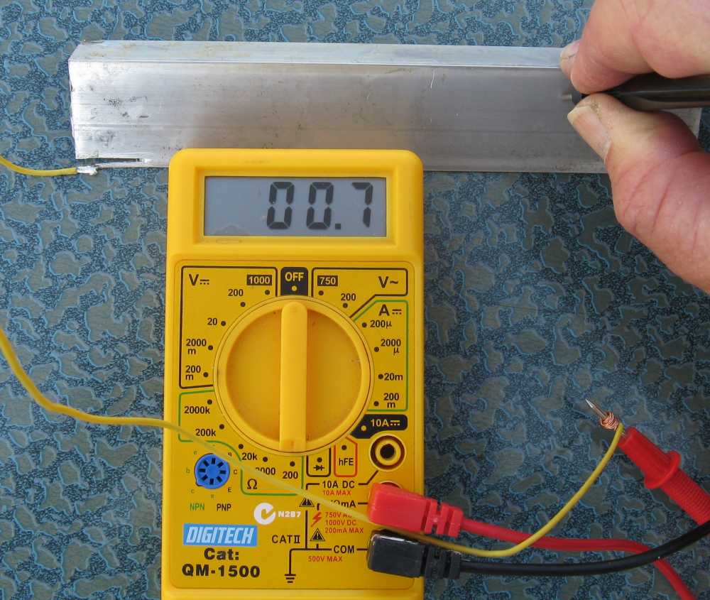

Thanks for the tip. I have received the 1260 flux and the 91%Tin 9% Zinc solder. I will try it on aluminium foil.
Bruno
Works with aluminium foil.
Tip: Hammer the end of a piece of wire solder into a flat shape and place it between the two pieces of foil to solder. Works also for soldering aluminium foil onto copper foil.

I use a product call Alumiweld, first saw id at a electronics trade show may years back. I found it at my local Harbor Freight store which sells only cheap Chinese tools and supplies, and after all do we really want our good tools to be resold when we die at a yard sale for a buck???
The Alumiweld in short is a AWESOME product. I have used it to weld my frames to a nothing short of professional look and bond. There is a learning curve in using this product as it was mentioned in this forum that it is "scratched on to both bonding surfaces. I cant say enough about this product but it has saved me the cost of a "professional welder" doing it for many of my ESL builds!

Hi geraldfryjr,
Having read about these aluminium brazing products here, I did a quick Google search and found a number of similar products.
I think this post give a pretty good overview:
Alumi-Weld test/review - WeldingWeb™ - Welding forum for pros and enthusiasts
As far as I can tell the cheapest available product will probably be good enough for the type of joint you need.

connection of wire to aluminum foil?
Hi there B: Could a wire connection to aluminum foil be made using your "trick".
Proposed connection-treat the end of a foil tape (about 5 to 7mm wide x 12mm long) with Superior #1260 solution, fold the tape over the solder with a wire end included, heat the foil packet externally. ....regards, Michael
