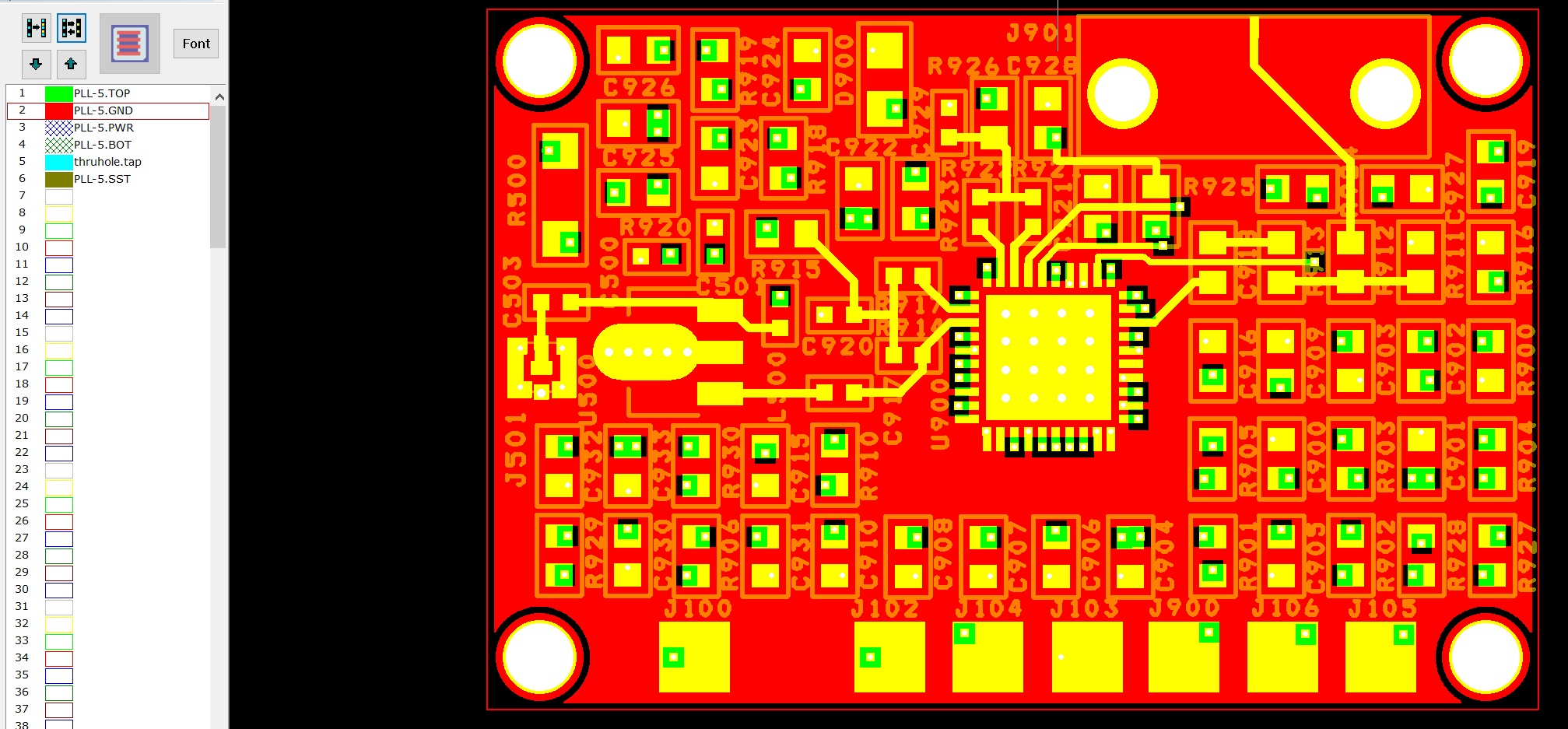

yeah it sounds like you need to bring everything up to re-flow temp, use some paste, stencil. Ability to soldering by hand would depend on the pad stack design, do you have full contact vias, vias in pads, thermal reliefs in the padstack?

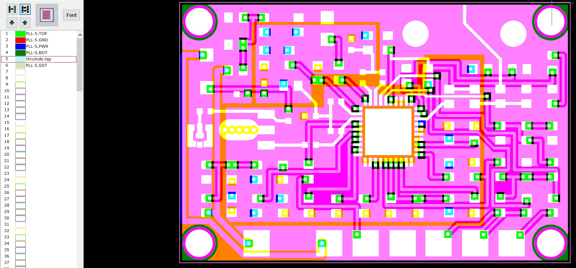

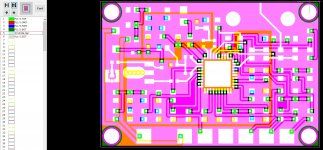

Yeah, it's of the worse kind, with vias in the pads and thermal relief in the padstack. 3 out of four layers (GND, PWR routing, BOT routing) are essentially ground planes or have heavy copper pours. I'm attaching two views, 1 is all four layers, 2 is TOP (controlled impedance and a couple of routing traces), GND, silk screen, and drill layers. Board size is 1.5" x 1" parts are mostly 0603, some 0402 too. After much effort, I assembled one board manually and it's working fine...
