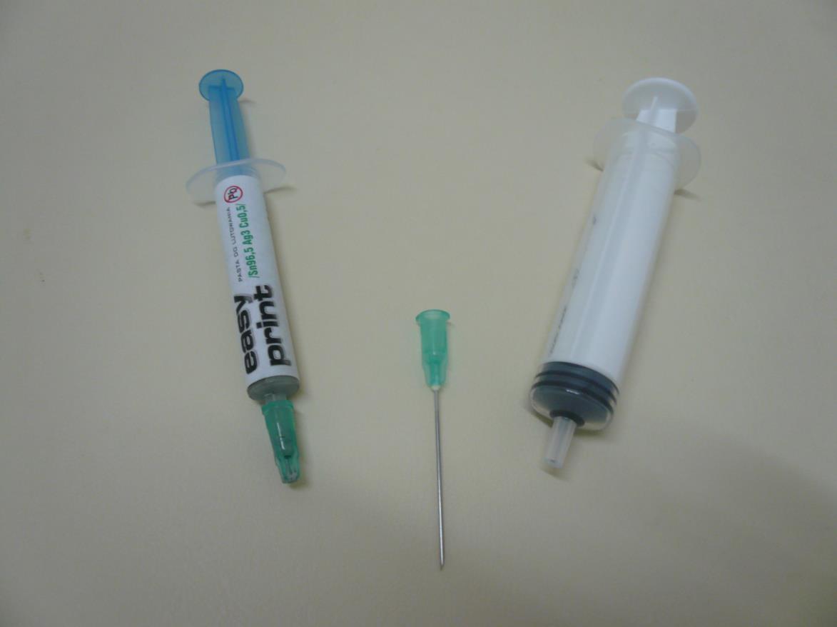

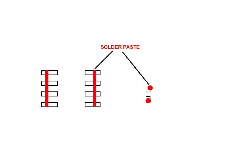

Trying my first steps in smd I acquired a cheap hot air/soldering iron station -Baku BK-702B- from a local shop. I found that it works best to set in rather high temp -400 C which is hardly reaching 200 C on the board- and at the lowest air pressure using a medium 6mm hose. I leave the solder paste of the refrigerator for some time and then it becomes rather liquid and sticky enough to hold the components in place. Don't worry if the paste is not precisely shaped on the pads. Just ensure that it is somewhere about and most important at a minimum quantity.

Yes, I only use hot air gun. Pre-heating or not, the board needs to be heated. I do it with the gun circling around the component. I don't use stencil but I leave the paste to reach room temp before I apply it. I made a diy hose that does the job much easier. See attachments, hopefully self explanatory.
