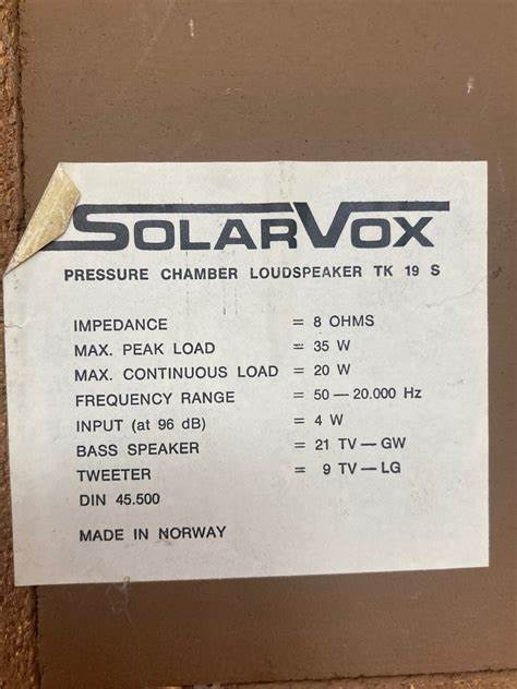

Since the SolarVox TK19S is an 8 ohm speaker (see attached label) and your receiver is 4 ohm capable (see specifications below), you can connect both the SolarVox speakers to the right hand terminal should you so wish.
Don't omit to depress the MONO button!
Pioneer SX-300 Amplifier
Continuous power:
8 Ohm: 2 x 7 W
4 Ohm: 2 x 7 W
