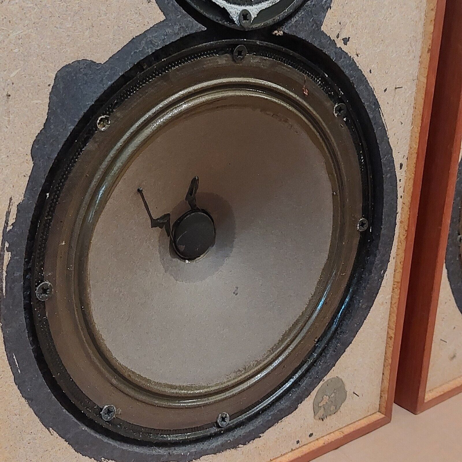

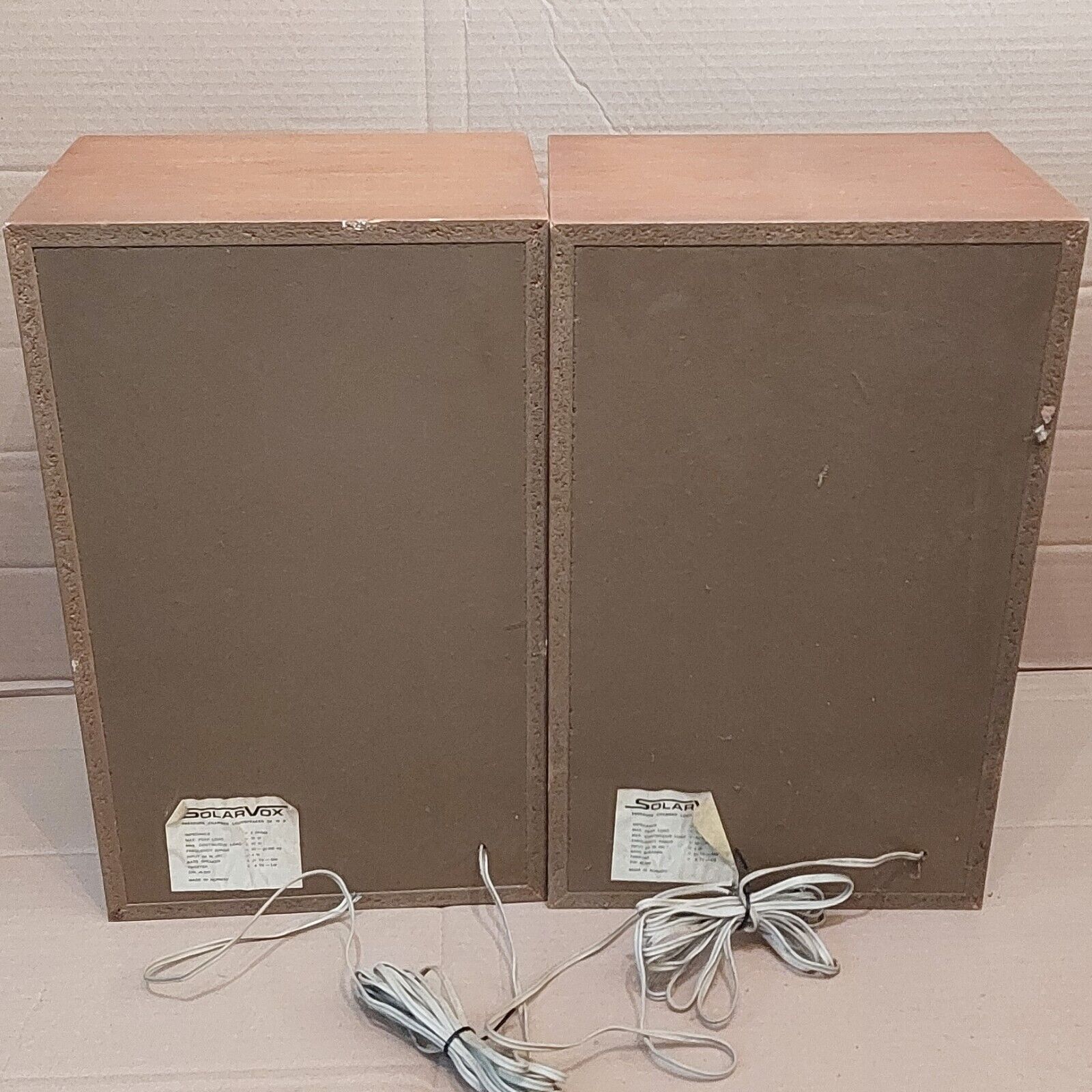

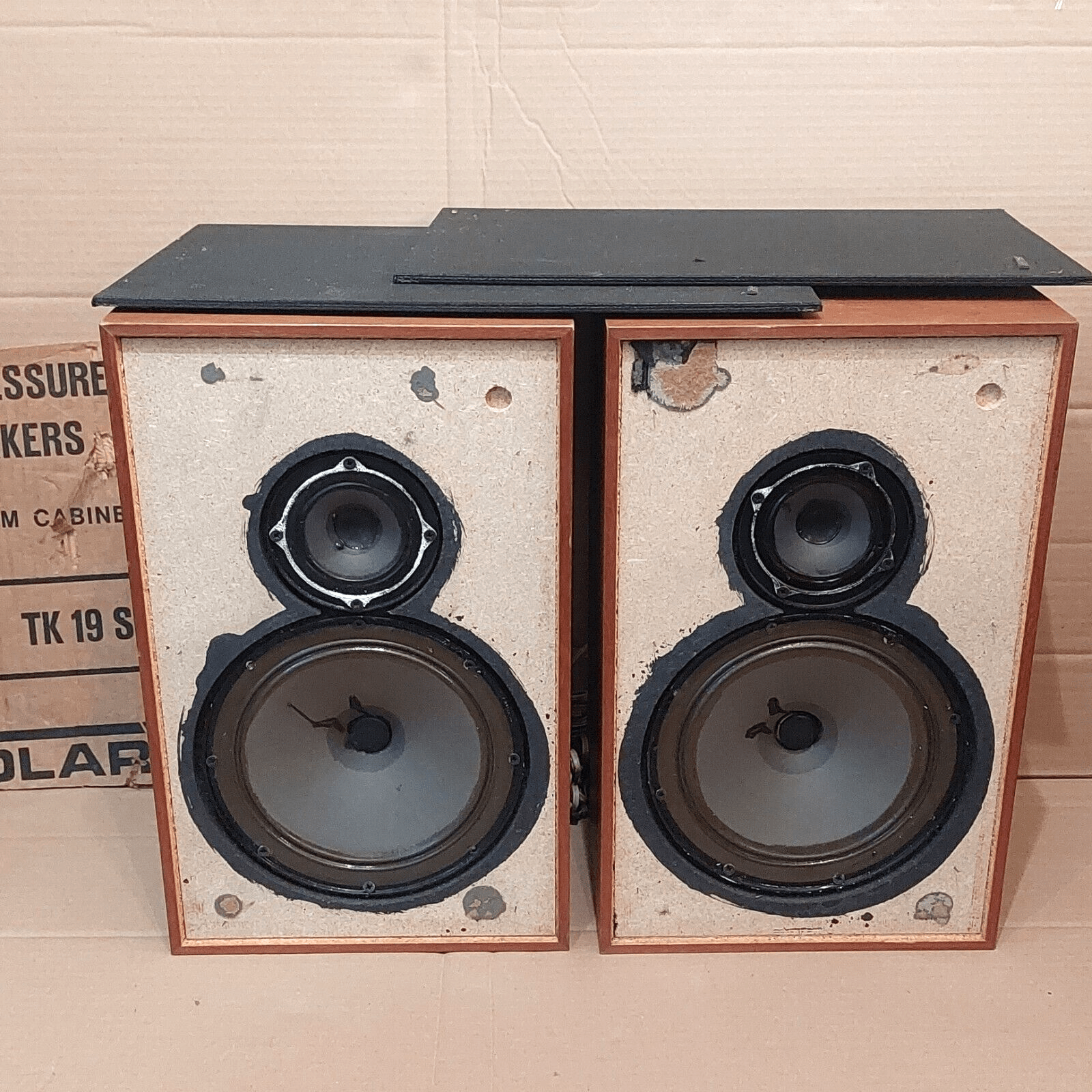

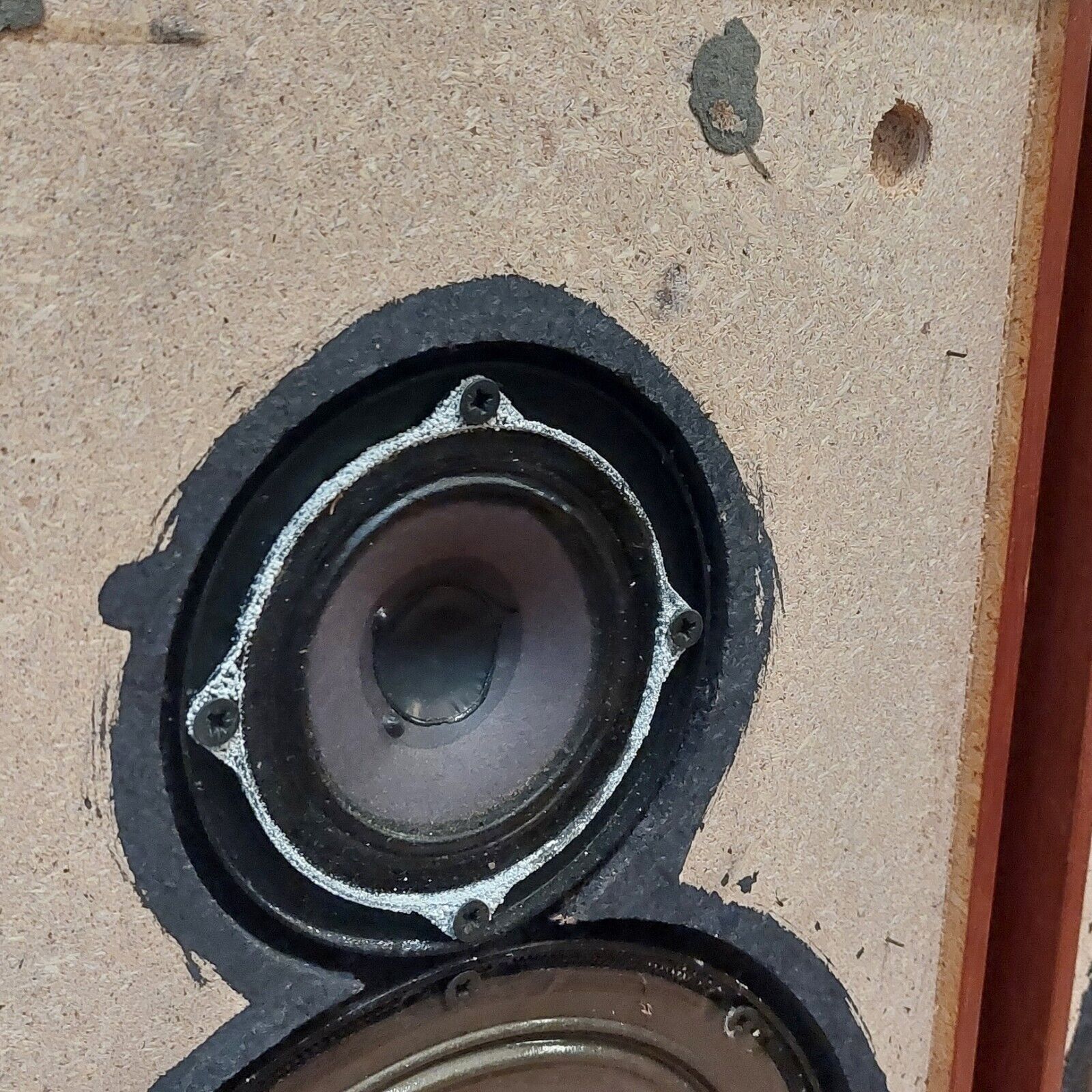

I have Solarvox TK19S speakers (bought in 1973 or 74) made in Norway. They have developed severe crackling even if not in use, or whether I play radio, CDs or cassette tapes on my Hifi separates system. How can I dismantle the speakers to check the wiring inside them? If its not the speakers, presumably the Pioneer SX-300 receiver must be at fault.
For future reference, dismantling the speaker involves unscrewing the woofer and tweeter from the front baffle - see attached images.
There may be capacitors inside that are in need of replacing - but first you must eliminate the probable receiver problem.

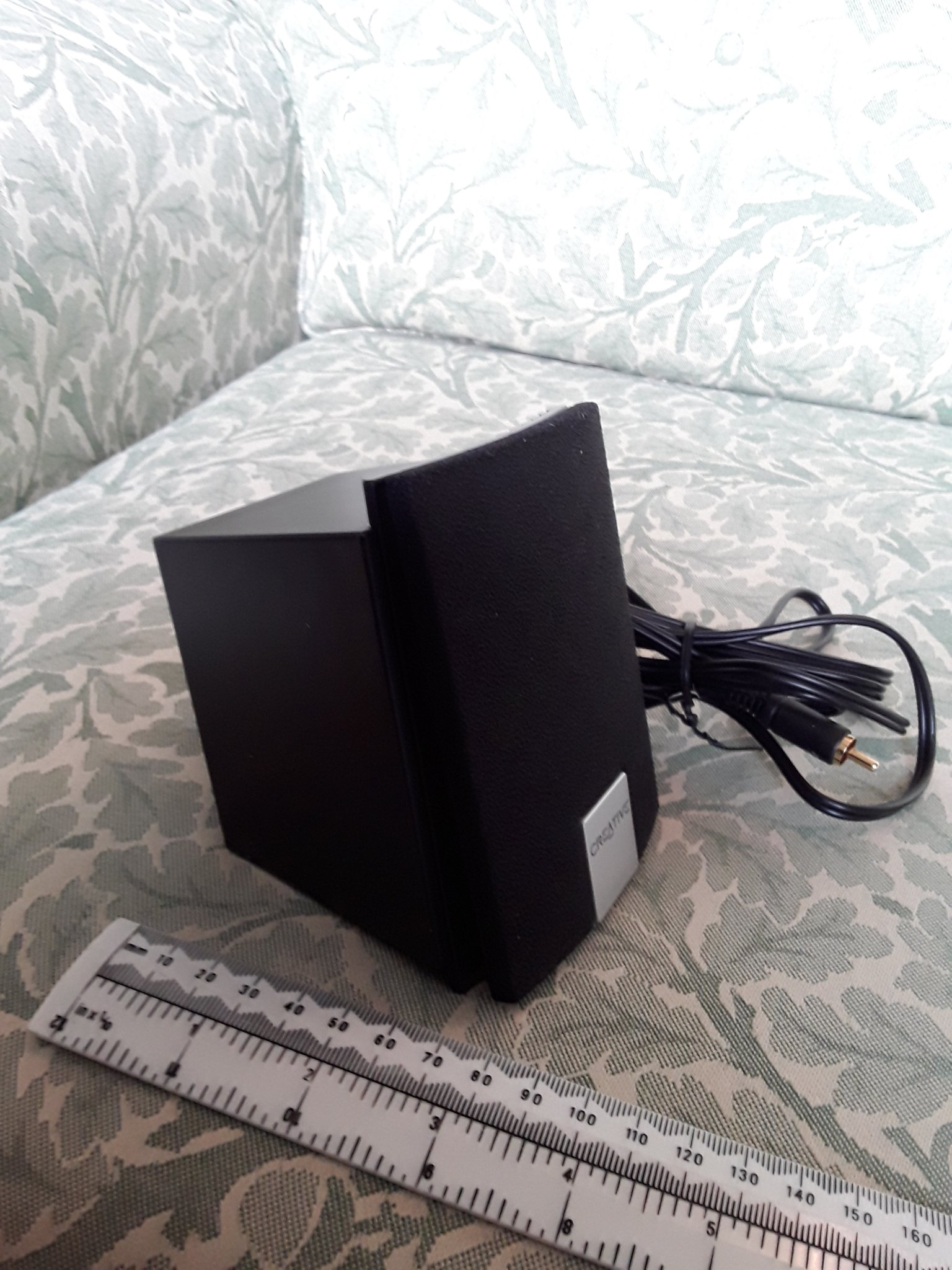

Yes the PC speakers do have plugs on the end.They are Creative Sound Blaster 5.1 supplied with an Evesham PC in about 2002. However with my current PC I only use 2 speakers and the others are not used at all. Is it feasible to cut off the plugs and make wiring connections to the hifi receiver?
Searching "Creative Sound Blaster 5.1" does no lead me to any information about the speakers.

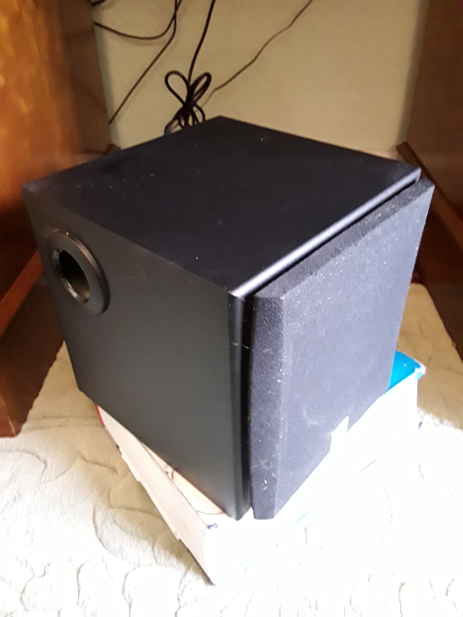

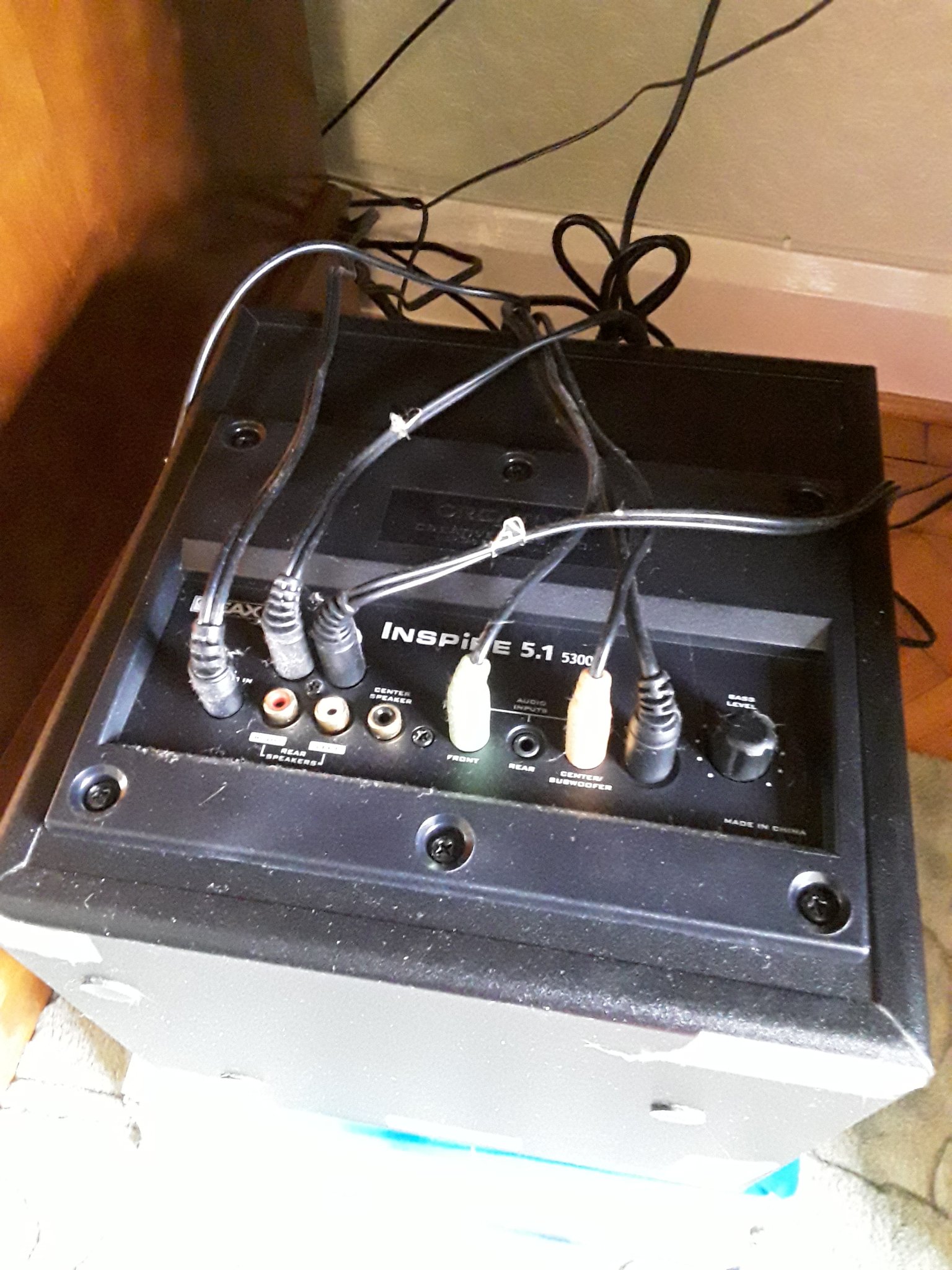

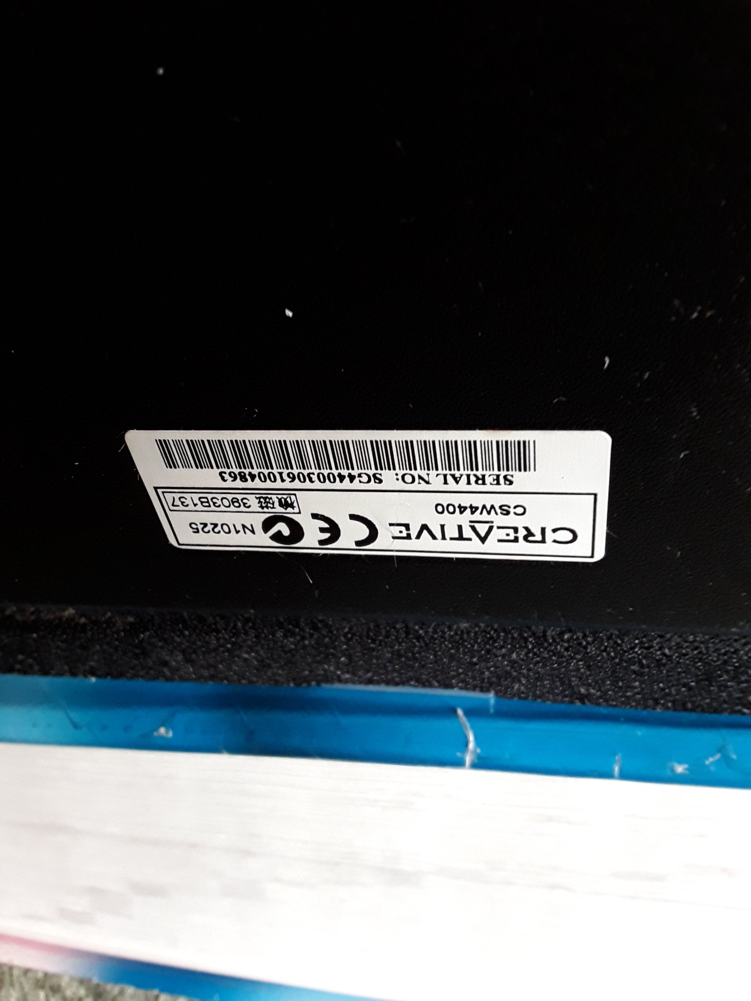

Provided the speakers are passive speakers, i.e., they have no in-built amplifer, volume control or mains/power supply connection, then you may be able to use them.
A photo would remove my doubts. Alternatively, is there any information written on a label at the rear of the speakers?
Thanks. The little computers are passive according to your description. There are 5 little speakers but only 2 are connected. There are no labels on these. However they plug into a much larger speaker and that does have controls and connects to the computer and also plugs into the mains. This large speaker does have a label. I attach photos of the small and large speakers and the label and connections.

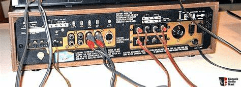

I've tried the computer speakers as test speakers. There is definitely a fault with the left hand speaker terminal. It makes no difference whether I connect the test speaker or the solarvox to the left terminal, there is still background distortion even if the volume is turned down completely. The output from the right hand speaker terminal seems clear whichever speaker type I use. If I have either sort of speaker connected to the right terminal, and nothing at all connected to the left, the sound is fine. Is there a technical problem with running the system just using one speaker, on the right? Alternatively with this Pioneer receiver there are places for A speakers and B speakers so you can have a 4 channel stereo system. The B speaker terminals have never been used. I wonder if it would work if I use the B terminals instead of A.
It would appear that the left hand channel of your receiver may be faulty, producing noise in the speaker even when no music is playing.
If you were to run the system with a speaker on only the right channel, you would have to depress the MONO button on the fascia to combine the L and R stereo signals so that all the music plays through the right speaker. Don't worry about leaving the left channel unconnected as it'll not break anything.
However, you should first connect both speakers to the B terminals and report back with the result.
