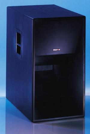

A single 15" horn might not be the best option for playing very low and loud so perhaps consider ported, when 360l becomes quite a large enclosure, possibly for a pair of 18s bridged to give you 4 ohms. I feel there is often no replacement for displacement! As many have suggested, you will have to compromise between low and loud!

I agree on compromising between low and loud. When toying with a 'picnic system' I was amazed how much power I saved by not amplifying signals below 50Hz. 600w in amps is closer 1Kw in power consumption, add exterior lighting, and it's a lot for a solar-powered system. Some get too caught up in specs.
