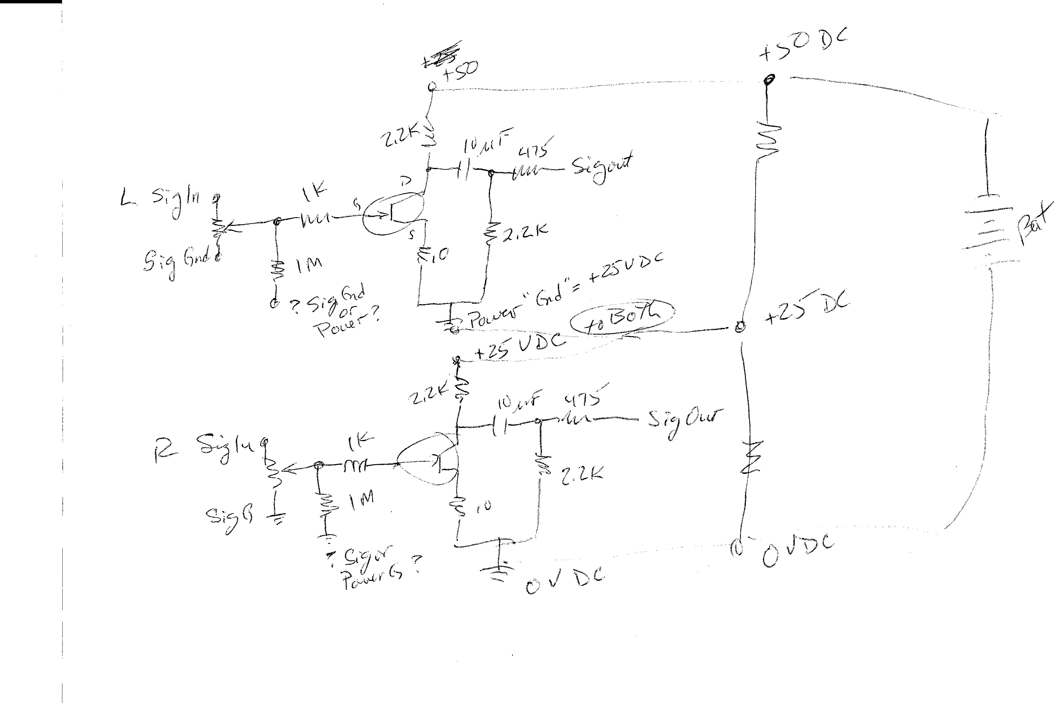

That is interesting and I will definitely need to noodle through it at some point. For this project, however, I wanted to make a simple SE Class A amp like the Zen 9. The discussion of voltage dividers has me thinking about a different use for them. Since the jfet BoZ wants about 24V, SE, and I have about 50, could I run them from a divider? One would operate from +50 to +25 and the other from +25 to 0. Since the signal is NOT DC coupled, it shouldn't care and as long as each channel of the preamp is looking at 25VDC, it shouldn't care unless there would be some problem with the DC - ("ground") of one channel being attached to the DC+ of the other. I will try to work out a schematic of what I am talking about and post it, but it may have to be hand drawn. I know it seems off the wall, but the more I think about it, the more I think it might work. After all, nothing in the amp will have reference to EARTH ground. As long as I keep the signal "ground" separate from the power +/-, would it work?look at psu solution in Quad 306 and 606 (caps and divider)
when that's clear , grasp how to make F5X with same ; in that case , when load is gnd-free , you don't need Quad's solution for small signal gnd , simple resistance divider is enough ........ and everything is DC coupled , as long you're using small signal gnd for entire signal chain
it'll work , but ..... even if JFet Boz is tiny consumer , it's still better and cleaner solution to just shave positive rail , especially if you're going to use power gnd as gnd for your amp

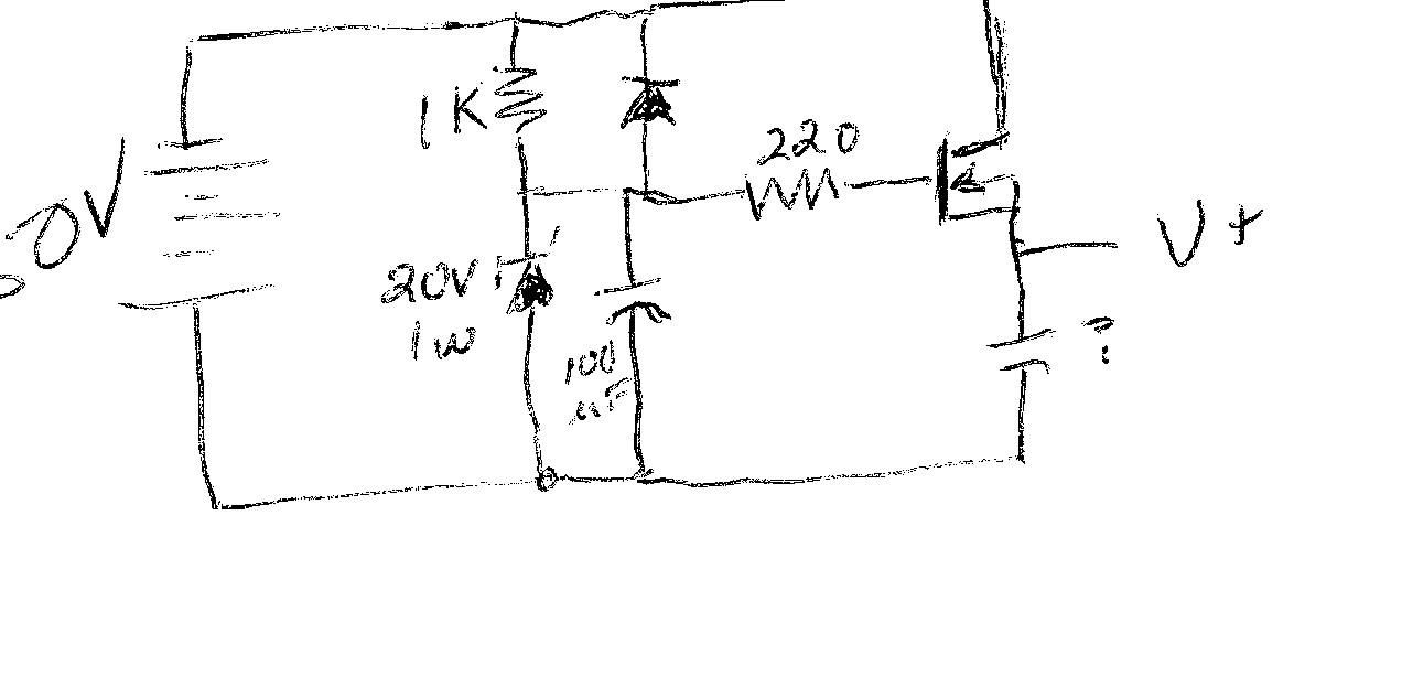

I think I can draw one, but I'll post it for comments before building it.😉however , it's better to make zenner follower series reg

Again, excuse my crude hand drawing - hardly "eye candy"!if you need help for drawing it , say
A few questions:
- Should I have a largish (2200uF) cap in front of this, or not needed with battery?
- Are values OK? (20V Zener is one I have and I think the output is a bit lower than the zener rating, correct?)
- IRF610 for MOSFET OK? (I have some)
- What value range for cap at end?
- Is the regular diode necessary? Why? What does it do?
1. not needed
2. OK (Uout = Uz - Ugs)
3.ok
4. 470 - 1000uF ; you can also add bleeder resistor in parallel to cap ..... for 10-15mA
5. cap discharge path , in case when supply is off/disconnected
3.ok
Thanks so much! I think I'll go with 1000uF and 2.2K @ 3W for bleeder (parts I have)
