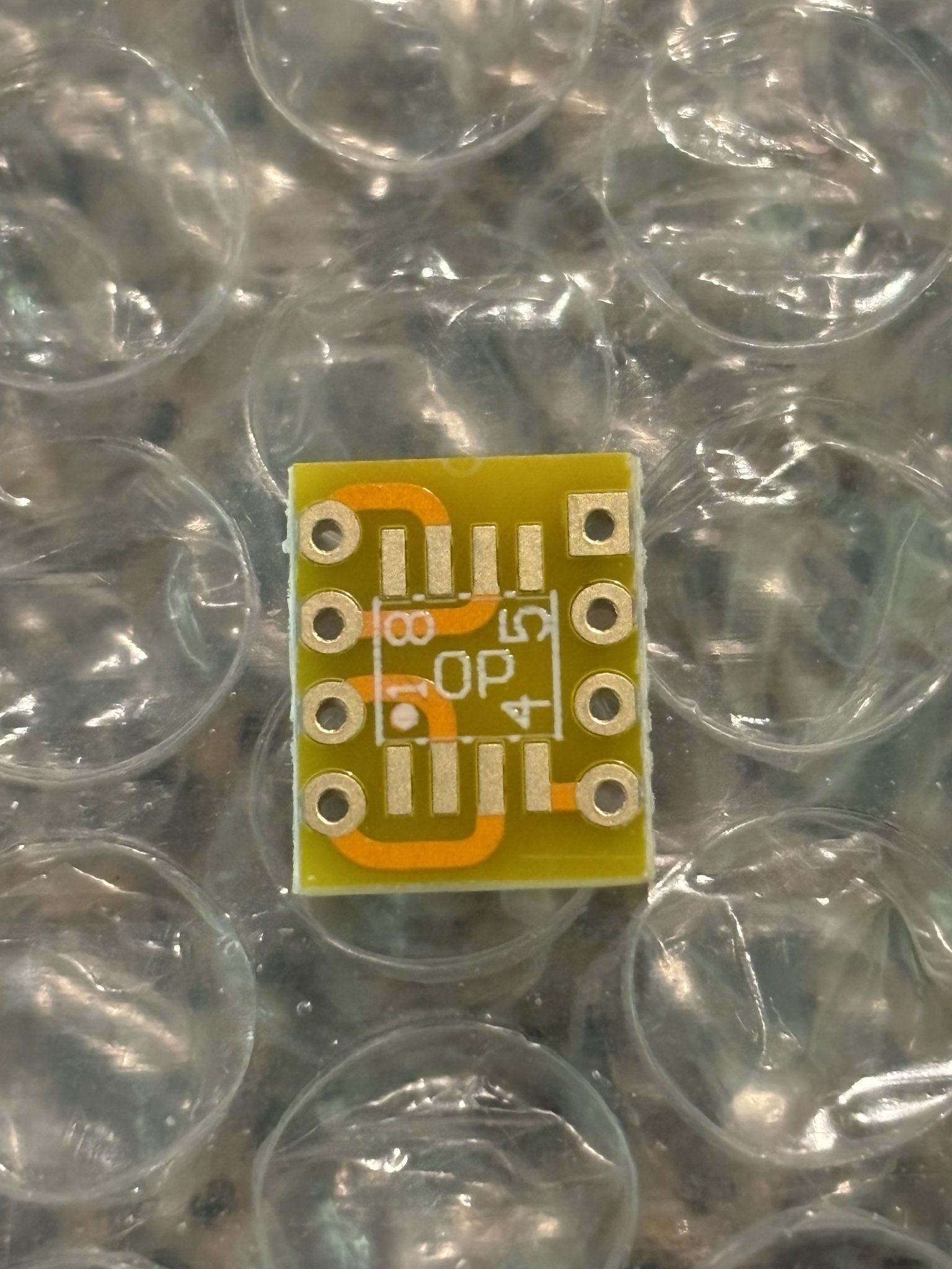

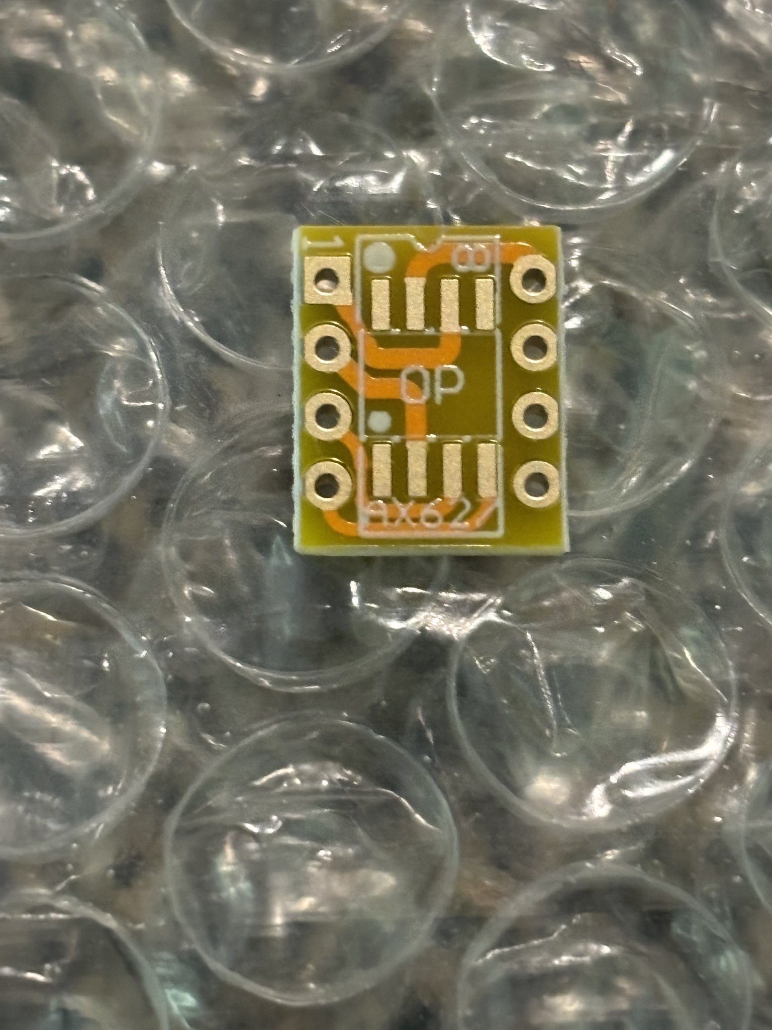

I bought these on ebay to convert a soic ad797 to dip for a phono stage but the more I look at it the less sense it makes.
These things are double sided to convert soic8 or sop8 to dip.
Am l missing something?
Can someone recommend me adapters that would work?

Thanks! I thought I was going nuts!
I emailed the seller just for kicks, these are going to the garbage. Returning to china cannot be done obviously. They seem to be selling a sht-ton of these, if ebay stats are believable, which I don't think they are. I don't know what is happening here!

These are 2 x single amp to dual amp adapters. They are correct for that application.
Presumably you need a single (SMD) to single (DIP) adapter? What opamp are you replacing?

Makes sense if you think of it as being an adapter to convert two single opamps in SOIC footprint to a dual opamp in DIP foorptint.
Such adapters are useful only for prototyping work. So I would suggest using them that way and then switch over to a proper PCB for the real thing.
I agree! I understand the PS caps positioning should be as close as possible to the chip and having an adapter puts them further away than I would like. Unfortunately, I am working with Sachu's riaa MC pcb. I don't quite understand why this was not designed to accommodate a soic chip directly but this is a discussion for another day.
