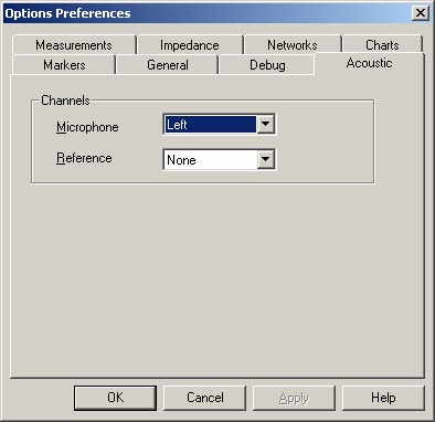

go to options/preferences and click on acoustic. select one channel for your mic input (obviously the one its plugged into)
I've got it plugged into the line-in with a mono-to-stereo plug. So I guess either left or right should do.
and select none for the other. If you don't do this you will either get virtually flat freq response curves or something completely out of whack.

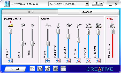

Also it may be necessary to play with your audigy settings. I've got my mike plugged into the mic input and have only the microphone selected as input also your output is important. you should only have wave selected on the source, DO NOT select line in or you will get feedback.
You may have to experiment with "what you hear" and "Analog mix" You may also need to use the built in windows sound thingy to select your input.

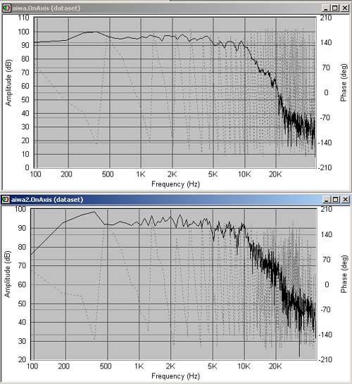

I've attached a file showing the freq curve from my very ordinary aiwa computer speakers. The first one is with 96Khz sampling rate and 256K sample size, the second is with 96Khz and 4K sampling size, to give you an idea of the difference. Note niether curve is smoothed.

edit: I think the wild fluctuations above 20K are due to mic limitations. The sound card is pretty flat out to at least 30Khz from memory. If yours are occuring lower, it could be your mike only goes to say 15K.

Speaker Workshop does not work with the Audigy card. I owned an Audigy an traded it with a friend against a turtle beach card wich works pretty well with speaker workshop.
The reason that the Audigy does not work is that the recording of the input is always linked directly to the output, so ther is always some form of feedback wich makes all measurements to fail. There is no way you can mute this, you can mute the whole output but than you also don't have a measurement signal anymore.
I have had a long discussion with Creative about this topic and in the end they could not help me in any way with this problem. (it took me a long time to explain them why the hell I would record the souncards own output) It's the way the hardware works, there is no software patch for it.
