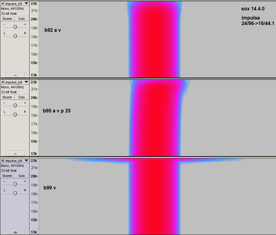

With sox you can't mimic the impulse response of either Meridian nor Ayre. Only some minimum and immediate phase things. I may suggest creating spectral images of these recommended impulse resonses and wonder how much these change the whole frequency behaviour. Better to have the standard pre-echo at frequencies you can't hear.
Edit: i once did some for downsampling with sox but it should illustrate what i mean
