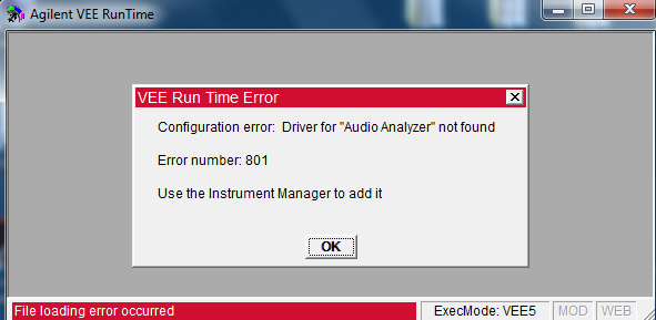

Hi, I'm new here, I have a hp8903e I use in remote control with my PC.
I use HPIB cable 82357B to usb , Keysight suite 17.1 with win 7, and all work fine!.
I'd like install the peter Millet sw , but none of the VEE runtime plug-in work!.
someone has experience with this type of procedure?
any helps are appreciate !!

What error are you getting when you run the Pete Millett software?

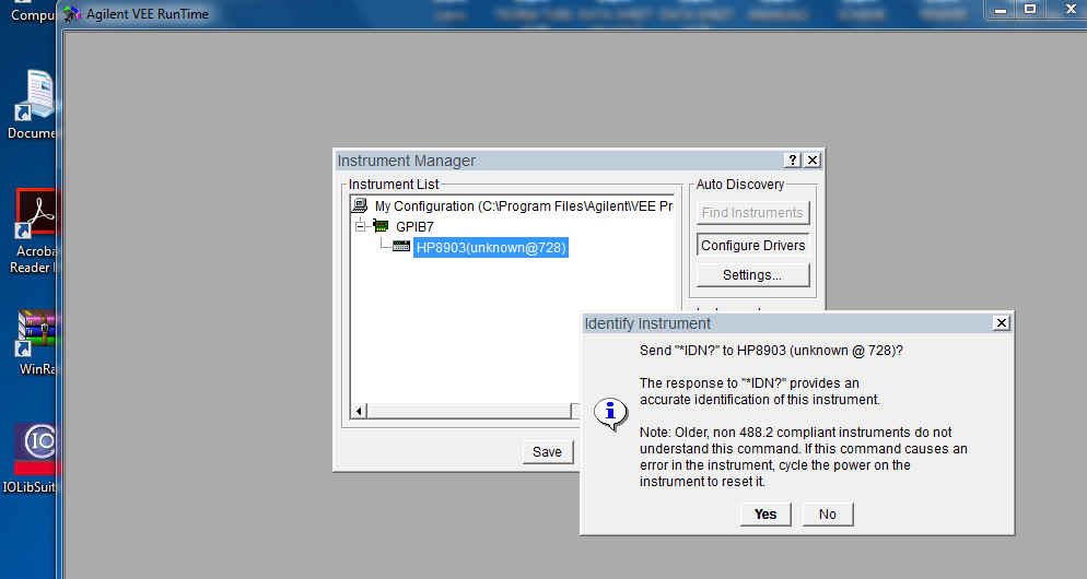

What address are you using for the GPIB interface in Instrument Manager?
this is the error when I run Pt Millet sw

In Instrument Manager when i click "configure drivers" it opens a window -identify instrument- and when click YES , the displays flashing "ERROR 21"( invalid HP-IB code sequence).
what's wrong? I have to set or configure something else?
thanks
