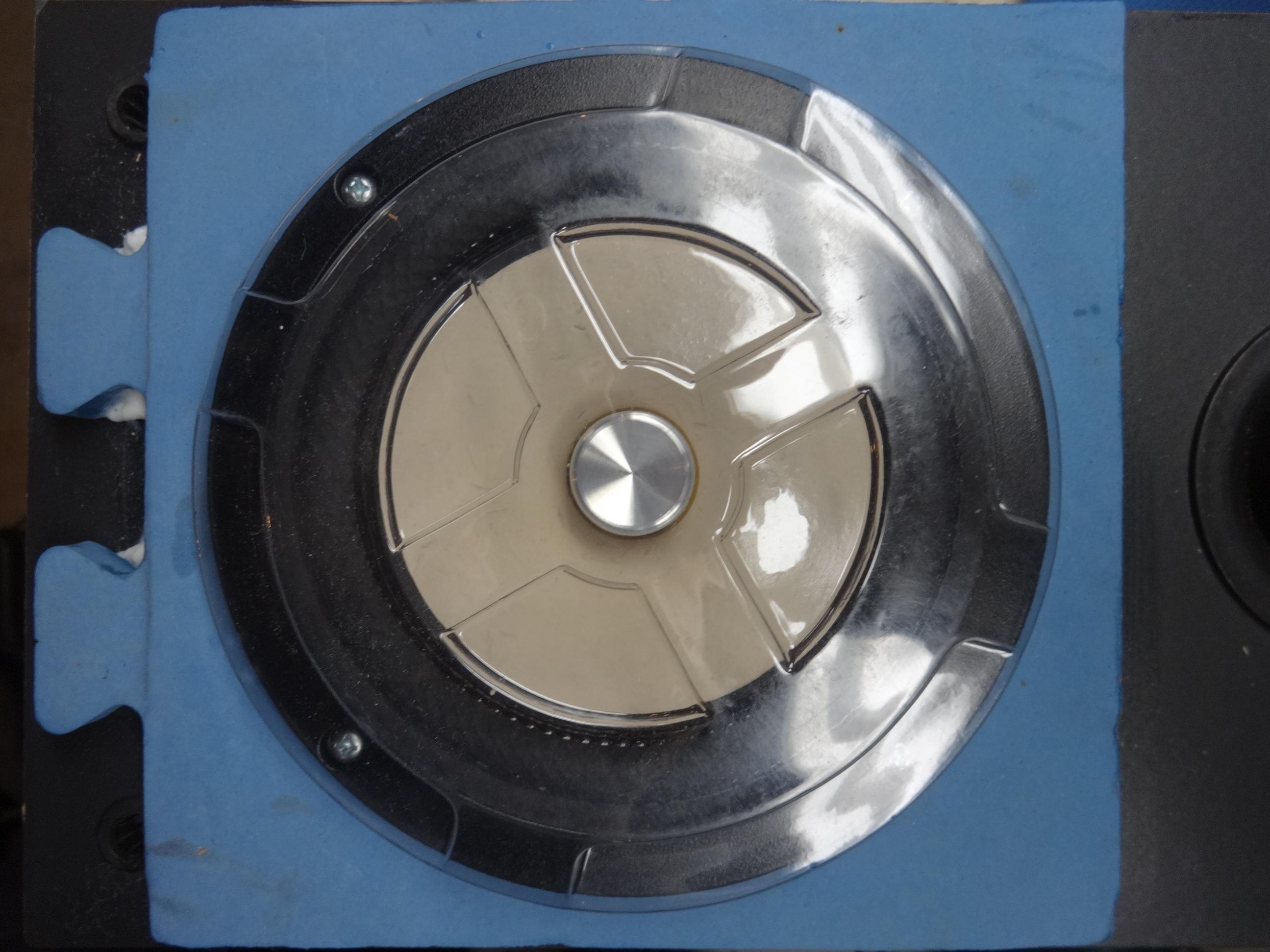

So I have some really bad cabinets with no internal framing nor braces - just cheap, 1/2" MDF glued together at the edges. They ring badly and have never sounded good to me. Rather than throwing them away, they may lend themselves to this kind of experiment.

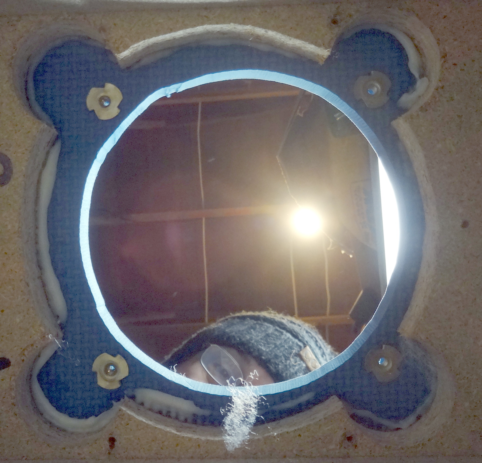

So what to do? Take a first shot at it. I had a couple pieces of "foam" - the kind that clip together to make a soft play floor for a kid. So I cut holes in the baffle to accommodate T-nuts with the idea being I want the foam to isolate the mounting fasteners from the baffle wood, by any degree possible. See photos below.
I'm not particularly good at building anything and I barely made it with clearance between the T-nuts and the baffle wood - it however shows the idea of what I'm trying to attain. A rap test about the driver frame with a screwdriver handle indicates "FAIL", as the clunk of the basket seems to well radiate through the foam and into the enclosure wood panels. It even makes different tones about the radius, corresponding to the 4 struts left from the T-nut clearance hole cutouts.
I suppose if I used something like Sorbothane, I might get a better result. That stuff being worth its weight in Gold, (because it works for audiophile TT isolation) probably a couple 8" square 1/2" thick sheets arent within the realm of a possible investment for experimenting. I do have some less stiff material (from an inexpensive yoga mat) on hand. Any suggestions of an effective material I can try?
I'm pre-supposing that decoupling a cheap cabinet design from the driver trumps giving the driver a solid mechanical ground to push against, in terms of how the whole system will sound. The measurement techniques in the "accel for cabinet panel resonance" thread could be used to validate any effect, by building one with soft decoupling and one with hard coupling to the baffle.

Hi Joe,
Decoupling the driver is a good thing, and sorbothane is a good material for doing this. But instead of bolting the drivers into something soft, think about mounting/fixing the driver by magnet, or to clamp it softly between a brace and the front baffle. Both will work fine and will reduce vibration transfer into the box and baffle. A thing to keep in mind is the weight ratio when you´re doing this. A small driver, let´s say a 5" widerange with Mms of 6 grams and a total weight of 2000 grams - just an example - will work fine softly fixed, a larger bass driver might require additional weight attached to the magnet.

I to wonder why this simple idea hasn't been used more through the decades.
It's well known that the cabinet coupled to the driver is the biggest contributor to cabinet colouration and resonances.
The second is sound returning from reflection to the cone and interfering with the sound being produced. This is both through air but also through the cabinet.
These two factors would be significantly attenuated with heavy driver damping at the coupling point to the cabinet.

With soft mounting all that will happen is speaker will move in opposite direction to cone and lose volume.
So you turn it up to make up for it and get the same vibration you got without the soft mounting.

Really? The mass of the cone and the air it pushes is far lower than the basket and magnet.
You might have a point with low frequencies and a really floppy baffle.
But what we are discussing here is basically a carefully constructed mechanical crossover. Like the linkage between the big cone and voice coil in a whizzer FR driver.
IE. you’d get damping of the higher frequencies but cabinet support for the lower that might have amplitude to move the support structure of the driver.

While the cone weighs little, the compressing of the air in front of the cone puts a large force in the opposite direction.

Sony did this way back in the day. They had an aluminum inner frame, and coupled all the drivers to it. The cabinet was only used for back wave separation. I think Stereophile had covered this model in some detail.
The idea is not to let the driver float, but rather affix it to a different structure than is used for control over its wavefront. A baffle on a wooden box does both, and there is some merit in exploring separation of energy emitted by the cone and by the frame.
I think some modern speaker manufacturers (Genelec comes to mind) have also used a single screw mounted to the driver magnet, with the brace held to the rear of the enclosure. Using Epoxy and some spare wood, a DIY version of this wouldn't be too complicated.
I'd recommend doing something like the BBC Ls3/5a cabinets, with a soft ( neoprene, foam or cork ) between the front baffle and box. I used a similar construction ( the front baffle is held on by tension springs, and there's a pair of square steel rods behind each front baffle to stiffen an damp it - the cork gasket being wide enough to separate bars/baffle) on my traffic light speakers that use four full range drivers, three used for bass and mids, the forth full range with boosted treble. Sound sublime. I'd also recommend you look for " mid range experiment... " by Remlab in the multi way section.
Gentleman, I appreciate the encouragement.
I too have thought of the stick-to-the-cabinet-back-wall driver mounting arrangement - and while at it, not just an ordinary wood stick, but one with a sorbothane (or other material) damper in it along the way. Sealing the driver basket to the front baffle then becomes another matter, where perhaps a less expensive material could be employed, such as butyl rubber sheet.
Of course, if very close tolerances between the driver basket edge and the baffle cutout edge could be kept, the rubber ring seal could be thin enough to not be flapping about due to pressure inside the cabinet. I'm sure there's an optimum for the width of this ring, allowing the driver to "float" on the post or X frame attached to the magnet.
I'm sure there is a Goldilocks Zone between the "duro" of a sorbothane puck perhaps attached to the driver magnet and the thickness / width dimensions for a rubber seal. Because the mass of the driver is now suspended on a damped spring, it's going to have a resonance - which hopefully could be engineered to be out of the way. There's a good application for an accelerometer measurement.
I'd think the bass speaker in a multiway could still be hard fastened to the cabinet baffle, as it wouldnt excite the cabinet at offending frequencies. That relieves it from this kind of treatment. I put the idea here in "full range" because in all cases, the driver may excite the cabinet at offending frequencies, thus the speaker perhaps could benefit from such an idea - particularly one with a cheaply constructed cabinet.
