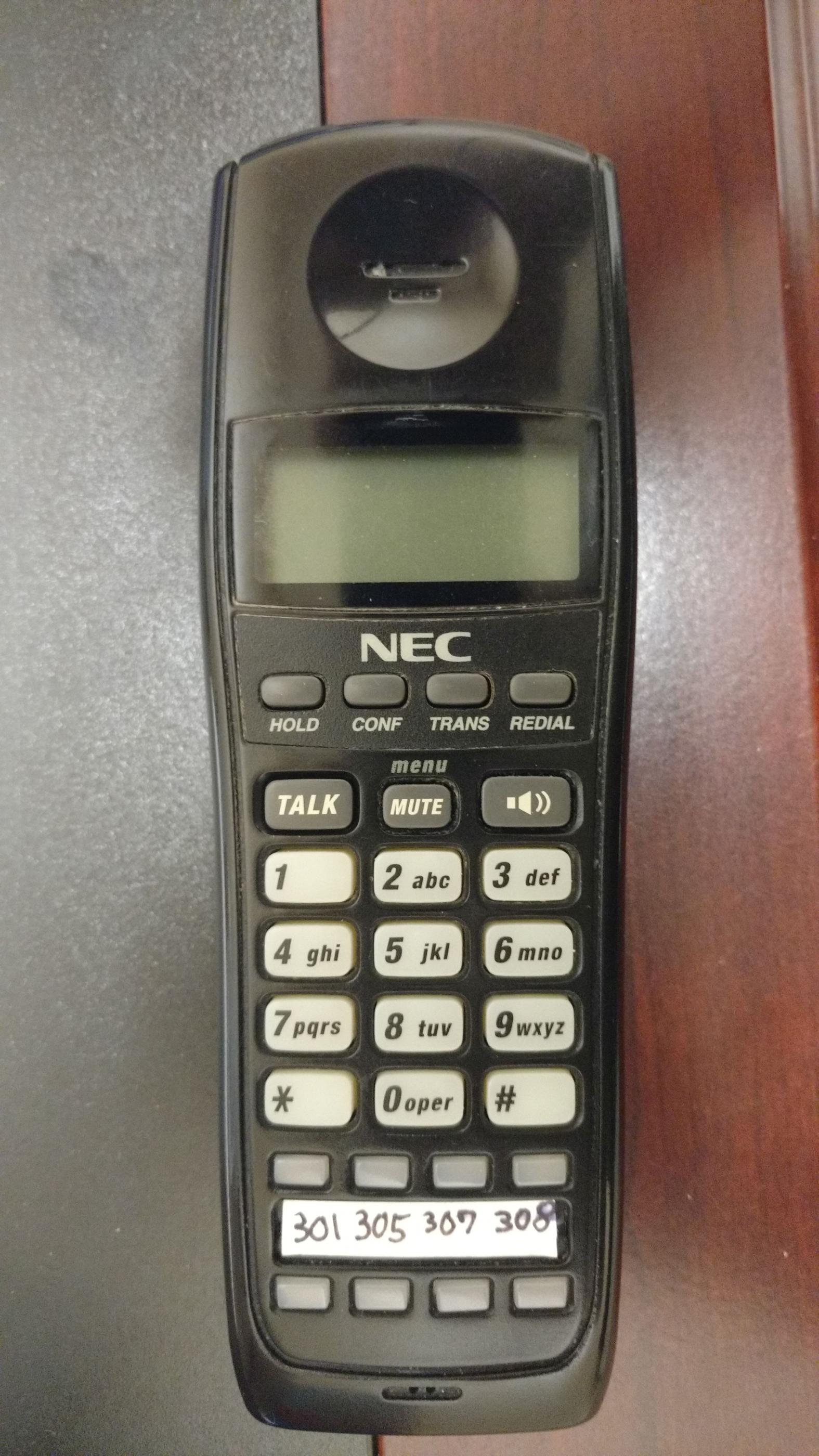

After 5 years, the keypads on our cordless office phones are reaching their cycle limit. Of course, the handsets are discontinued, no longer available and the only solution is a complete phone system. Even in our small office, that's several thousand dollars.

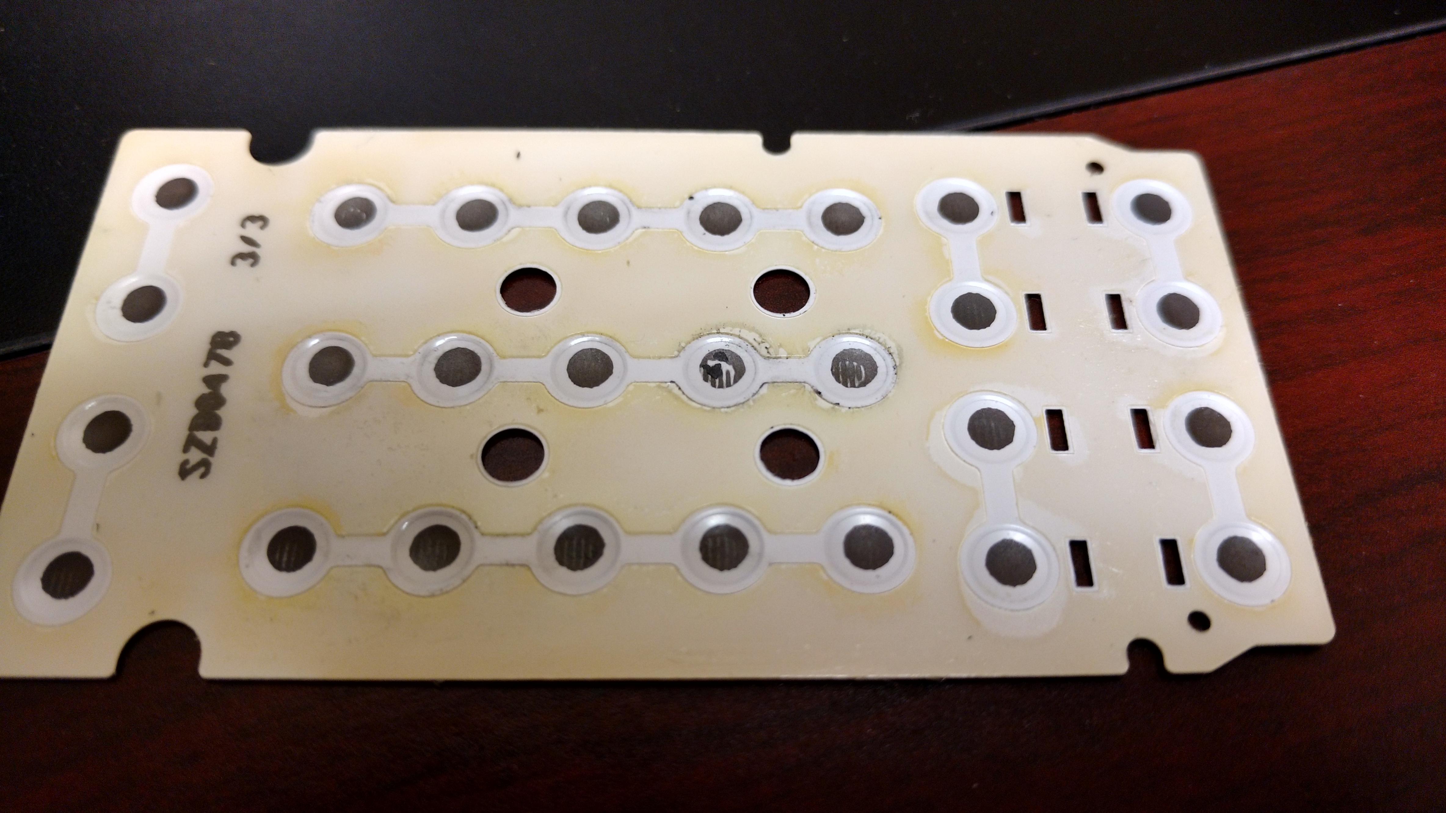

What's annoying is the only problem is the contacts on the (membrane?) switch pad are wearing off, leaving us unable to dial certain digits. Picture attached.
What I've done is to file some pencil leads into powder, mixed that with some PVA white glue thinned with water into a paintable slurry, and dabbed it onto the contact surface. It took a couple of tries to find the right carrier and viscosity, but this works fine right now. I have no idea how long it will last.
Replacement switchpads/membranes/whatever they're called would be the ideal solution, I can find no helpful resources for such.
Better or more permanent repair ideas would be most appreciated.

You can get kits with new conductive pads like this one: Keypad Repair Kit Remote Control Conductive rubber buttons

Bob, I was thinking about foils before trying the graphite. It seemed like it would be too stiff to stay in place, but gilding foil may be thin enough if an adhesive would be reliable.
ubergeek, those pads are neat, but this doesn't have those little carbon buttons. These contacts are pretty much painted on, and additional thickness would be an issue.

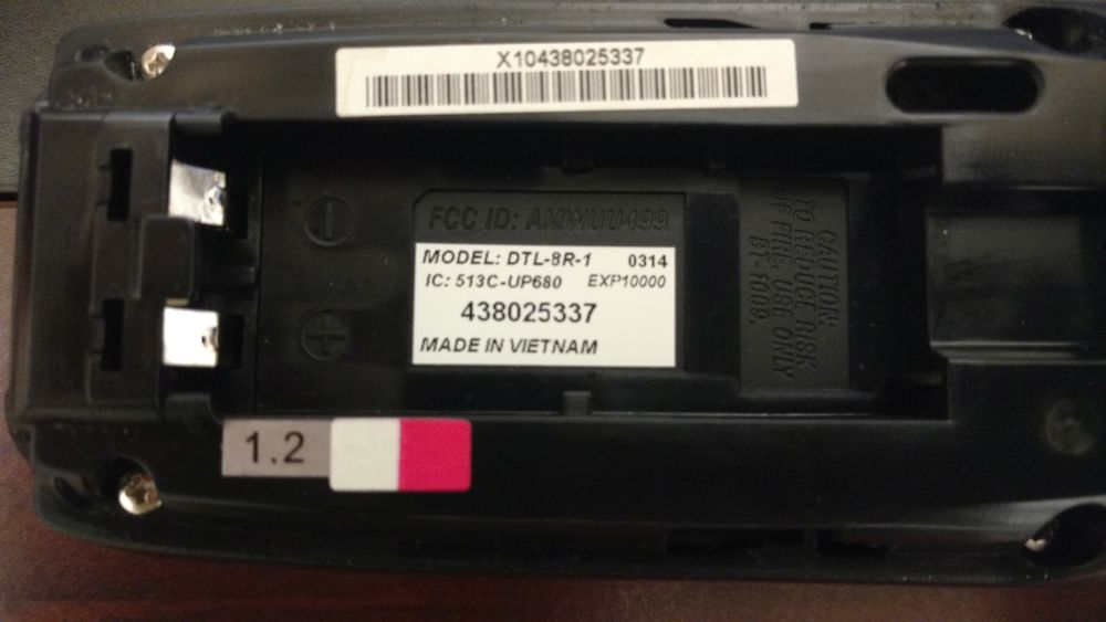

I seem to recall you could get those thin membranes in the past, but I couldn't find any just now. In my experience (as a telephony engineer with contact centre background) most handsets last very well indeed, usually well beyond obsolescence. So I'm interested what make and model these are to wear out in 5 years.

OK yes I've had similar cordless sets wear out the buttons (even in a home environment)... they are built about the same as TV remote controls. The thicker pads in the desktop models last a lot more presses I guess, it makes sense.ubergeek, it's an NEC system. Handset model is DTL-8R-1.
Other functions are fine, and 2 of the 4 we have are still OK.
