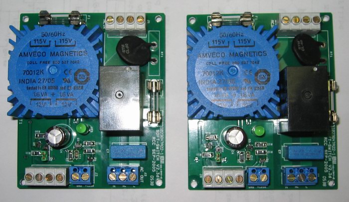

Switches done...!
My switches ... finally done !
Arne K
Mine also! Only one drawback,......they don't switch :xeye:
If I apply power to the unit, both the LED on the PCB and the blue ring in the push button lite up. If I press the push button both go out, and so and so on but the relay stays silent. I reversed D1 as was mentioned earlier and I measure 11,94VDC on both units. Is there a possibility that I overheated a transistor :cannotbe:

The switch/flip-flop is working since the LED is changing state when you press the button. If you have a DVM you can check each leg of transistor Q1 to see what's happening. The base of Q1 should match the LED: high when LED is on and low when LED is off. The collector for Q1 should be high when the LED is on and low when the LED is off. If D3 was installed backwards, then Q1 will fail because of excess current. If you have the PNP transistor installed in the place of Q1, then the circuit will not work.
Let me know what you find out.
Maxhawk
After inspecting both boards I found the following errors.
On one board I reversed D3 :headbash:
On the other one I mixed up Q1 with Q6 :headbash:
I already corrected the D3 error but still no switching. I'm gonna put everything away for a while and come back on it when I feel less p****d about it. :redhot:
