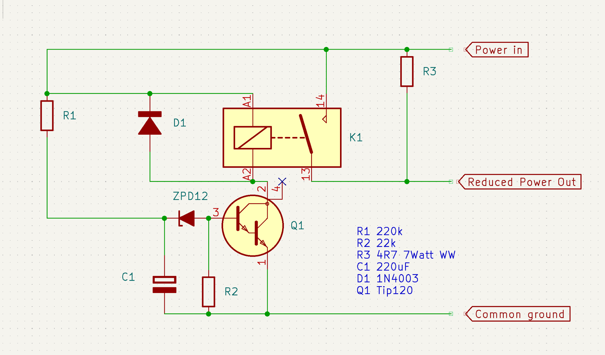

Hi team, not really an audio question but I know there are plenty of brains around here… I need a very simple current limiter / softstart for an 18v DC motor, just need to slow the initial turn on hit, half a second would be fine. Motor runs at around 3-4 amps but start and full load would be a lot higher. Thought about an NTC or a two position switch with a resister that could be inline for a bit then change switch position to direct (Cut out the resistor).
What do you think?
Cheers

The time constant is of course variable and not having any requirements to hand, the schematic is intended as a starting point.
Drawing 42Watts at turn on, reduces rapidly as the motor starts to turn.
My appologies, R1 and R2 somehow got reversed. Dyslexia rules KO.
Yes a 22u or even 10u, would speed things up.
If the relay fails to close, there is no power going to the circuit. A Tip120 is unlikely to fail, hence the component of choice.
-Tell me what role does r2 play in this circuit?
-How can I speed up the circuit recovery time after disconnection? I mean that the turn-on delay is small if it is turned on again after disconnection
-Perhaps it makes sense to install a thermistor instead of a load resistor in case the relay breaks?

Thanks, can you tell me more about this circuit? Space is really limited...

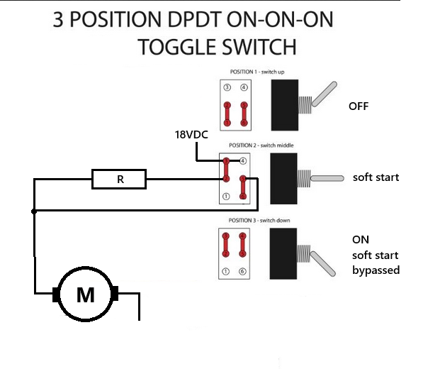

I was looking to use just a 3 position switch but all the rated switches seem to be center off. I really want a switch where position 1 is off, 2 is through the resistor and then 3 is resistor bypass. Simple operation, move switch to position 2 for a second then to position 3 once motor is up to speed. Trouble is I can't find the right switch...
Cheers for now.
I believe an ON-ON-ON DPDT toggle switch will do.
