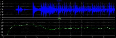

Here's another simulation result where the load applied is real music, full power into 4 ohms. Top trace (blue) is the music waveform, bottom trace (green) is the PS rail with 70000uF.
Basically, if you're playing real music at realistic levels, the PS capacitance you have now should be more than enough to handle any transients. You could argue that the additional capacitance would result in a lower ESR and therefore higher current delivery for transients, but it would likely be masked by the effective output impedance of the output transistors and the emitter resistors.

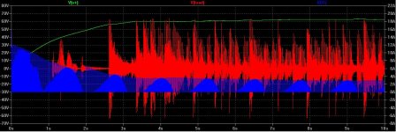

Ok first a description of the modeling approach and then some results. See the attached schematic.
The AC line is an ideal voltage source sine wave 170V p-p. Inrush protection is 4R7 bypassed with a relay modeled using an ideal switch that turns on after 2 sec.
The transformer is 3 inductors, with a coupling factor of 0.98 between them. See the .subckt in the schematic. The ratios of the inductances are set to get the proper output voltage, series resistances are a guess. I don't know if the values for L1, R1, R2, R3 are realistic, I'd appreciate any guidance. I haven't been able to find any transformer manufacturers who spec those parameters. Diode bridge is just the default diode model, same for the caps.
The output stage is modeled using a voltage source, splitting it into + and - halves using ideal diode primitives, and driving ideal voltage controlled current sources. For these sims I set the gain to 16, i.e. 1V input -> 16A current into 4 ohms, to swing 64V max or 80% of the rail voltage. The cool thing is you can drive the voltage source with a .wav file. (I used "Return from Planet Egalica" by Dubblestandart, for anyone who's wondering.)
I won't claim that this model is 100% accurate, but I think it is good enough to get a detailed understanding of the problem. It can be easily modified to use models of the the actual diodes, multiple caps and their ESR, etc.

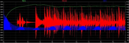

Here's two waveforms showing the rail voltage, the voltage waveform at the load, and the current in one of the diode bridge diodes for 70,000uF and 200,000uF.
In both cases the rail sags to about 60V. It never gets charged all the way to 80V because I haven't come up with a way to delay the start of the .wav file. But if there was excess current capacity upstream from the caps, it would get there. In any case, with 200,000uF the rail is a little smoother vs. 70,000uF but it still sags to about the same point, and the diode current "in use" is about the same.
So this supports my earlier contention that additional capacitance, beyond "enough", doesn't do any good. Unless you're listening to recordings with very high peak to average ratios, maybe the 1812 Overture with real howitzers.

Half the capacitance in your SIM, it is 200K total not 200K /side ......
I should have the necessary parts for the soft start next week and then i will proceed to first test the new caps and then with all 4 caps for a total of 220K...
I have noticed that different brands sound different , so first is to see if there is any degradation in the sound with the new type ( Brand) first with the same capacitance , then upping ...
Viewing your results, there is a big difference for the first 4 secs. Then less so afterwords, the ripple is much smoother , now to see if we can hear the difference on some 1812 dubwise..
thanks MightyDub ..
Ah, that changes things. It looks like 35K/side is "enough" for 8 ohm loads driven to about 80% of the rail, for 4 ohm loads it needs more and not surprisingly 70K looks good. But you'll have to turn it WAY up to get the benefit... hope the spouse / neighbors are understanding.
