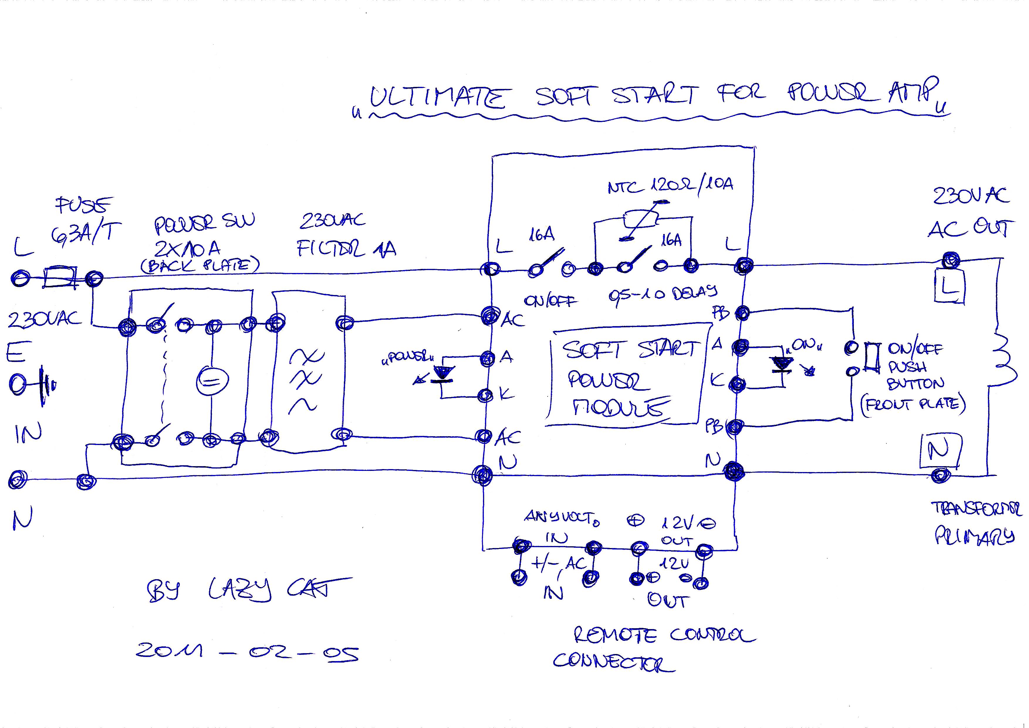

I use two NTC across two poles of a double pole OMRON 230VAC (soft start) relay, in series before this delayed relay is the power relay, which is a similar relay that is used to turn the amp on and off.
The reason for the double power relays are because the power amp is turned on and off by a momentary push button at low voltage.
When the push button is pressed a PIC controls both relays via zero crossing opto coupler. The main relay is turned on first followed by 500 mS dealy then operates the soft start relay which by-passes the NTCs and applies full power to the transformer.
While power is applied in the turn-on state both relay contacts are protected by the NTC.
When power is turned off the soft start relay is dropped out 200 mS before the main relay and again the NTC protects its contacts from arcing when opening. The mains relay has a normal snubber of 150 ohms in series with 47 nF.

Hi Nico - interesting! A few comments - if you don't mind.
Have you checked when the main relay contacts first touch - compared to zero crossing? You may find that circuit delays, etc, and the actual voltage at the time, can minimise initial magnetising in-rush level - which you may be able to minimise through a programmed delay.
You indicate that the main relay contacts are snubbered - is the snubber across the relay contact (ie. bridging the isolation switch), or between active and neutral on the the amp side?

Hi Tim,
the snubber is across the mains connect/disconnect relay contacts in other word is for the purpose of snubbing the initial current when the contacts are starting to open and this is when contacts arc.
The NTC is across the contacts on the inrush current limiter, and when these contacts open the NTC takes the current away from the opening contacts.
Snubbing contacts is a common practise to protect contact arc in industry, you just need to calculate the resistance capacitance value to quench the spark at the instant of opening in worst case conditions normally associated with inductive loads.
Normally contacts do not arc on closing since we are operating a relatively low voltage around 625V peak to peak, it is when they open and current continues to flow while they are drawing appart and then pit the contacts.
The zero crossing couplers have no real value here since the relay takes time to operate, why they were there was that I used to do soft starting by ramping the voltage using triacs, but triac plays havoc with the transformer load and was not a successful idea.
Placing snubber across the Live and Neutral has no effect other than being a load. Increasing the capacitance to such an extent to match the inductive load, then it is power factor correcting and the load will appear resistive, but won't protect the switch contacts.
