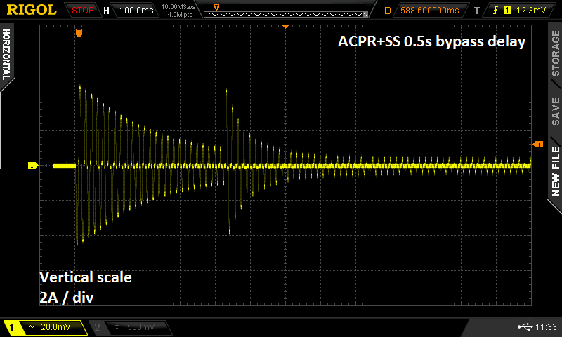

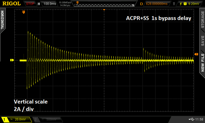

Maybe this passage from a different soft-start PCB design thread, might provide a little food for thought:
When should the inrush limiting cease? When should the bypass turn on? Opinions vary. Texas Instruments bypasses the ICL when the amplifier's DC power rails have ramped up to approx. 60% of their final voltage (Fig.5 on p.7). Douglas Self's textbook suggests bypassing 1 second after power-on (p. 632). Rod Elliott's inrush current limiter for power amps, Project 39, enables the bypass after 0.1 seconds. A brief and incomplete survey of diyAudio discussion threads, turns up recommendations varying between 10 full cycles of the AC mains (0.2 sec) and 100 cycles of the mains (2.0 sec). All of this suggests to me that there are probably more than one right answer, and maybe the shrewd decision is to provide a few user-selectable options. As has previously been done in the Soft As A Feather Pillow soft start design by diyAudio members jhofland and xrk971, I chose the convenient 2X-per-step settings 0.5 sec, 1.0 sec, 2.0 sec. Thus bypass happens either 0.5, 1.0, or 2.0 seconds after power on, selected by a jumper on the PCB.
846811d1590279332-pcb-low-voltage-switch-drives-ac-mains-relay-includes-soft-start-h9kpxg-with_acprss_0p5_sec-png
846812d1590279332-pcb-low-voltage-switch-drives-ac-mains-relay-includes-soft-start-h9kpxg-with_acprss_1p0_sec-png

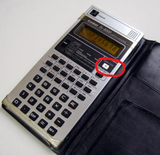

Jan, I have a Casio FX8000 calculator from college days that has a timer and stopwatch on it and we used to amuse ourselves seeing how quickly we could press start and stop.
80ms was the target to beat as I recall, in fact I still have it and it still works... yep about 80ms. 100 to 150 was more typical if you genuinely did two presses and did not 'bounce' the contacts.

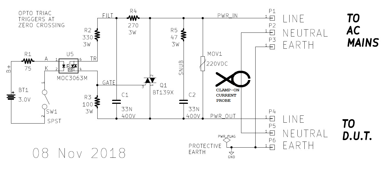

Attached below is a photo of the test rig I built, to observe mains inrush current limiters in action. It connects the mains to the Device Under Test, precisely at the zero-crossing of the mains voltage. This switching instant produces the worst case, maximum instantaneous peak value of inrush current. {remember "ELI the ICE man" from AC circuits 101? here he is again} Since I'm testing inrush current limiters, naturally I want to apply the worst case stress.
Being slightly paranoid about AC mains circuits, I included some safety features
  1. Galvanically isolated, battery powered, human interface (test start switch)
  2. Galvanically isolated oscilloscope interface (non-contact current probe)
  3. Apparatus and I/O wires secured to insulated tabletop
This is the fixture I used to capture the traces shown in post #4, above.

Good eye! Yes I clicked on the wrong row of the parametric table and bought small diameter MOVs by mistake. Luckily (a) the PCB footprint accommodates several lead spacings; (b) the MOV doesn't really do much in this tester anyway. The RC snubbers deal with inductive flyback at switch-off , so the MOV is just a "belt and suspenders" safety net behind the main safety net. Protection against surges on the AC mains isn't much of a priority either, because the apparatus (inrush current measurement board) is only plugged into the mains for ~ 2 hours each year.
+1 for current probes/transformers. I built a current probe for measuring inrush current for about $10: The $10 Current Probe - How to Measure Current with an Oscilloscope – Neurochrome
As Mark pointed out earlier, the best way to set the inrush delay is to measure the current and tweak the delay such that the two inrush spikes (the initial and the one that happens when the inrush limiter is bypassed) are roughly equal. You will likely find that you can shorten the inrush delay considerably by using an NTC or inrush limiter rather than a power resistor in the soft start. If you do use power resistors, watch their peak power rating and make sure it's not exceeded. For more detail, have a look here: The Ultimate Guide to Soft Start Design – Neurochrome
