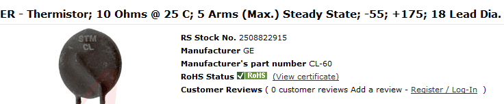

Would this thermistors be suitable, it is of CL-60 type.
GE | Passives | Resistors | Thermistor | |CL-60
oh boy
CL-60 is drawn on every Papaschematic
Sorry for Noob Q Zen, I am unsure if all CL-60's are of similar/suitable spec.
The General Electric co. is the only one who makes the CL60, for decades.
CL60 is CL60.
You can use other thermistor types, by other manufacturers, then they have a different name.
CL60 is CL60.
Save ?
Thankyou, that is what I was after.
