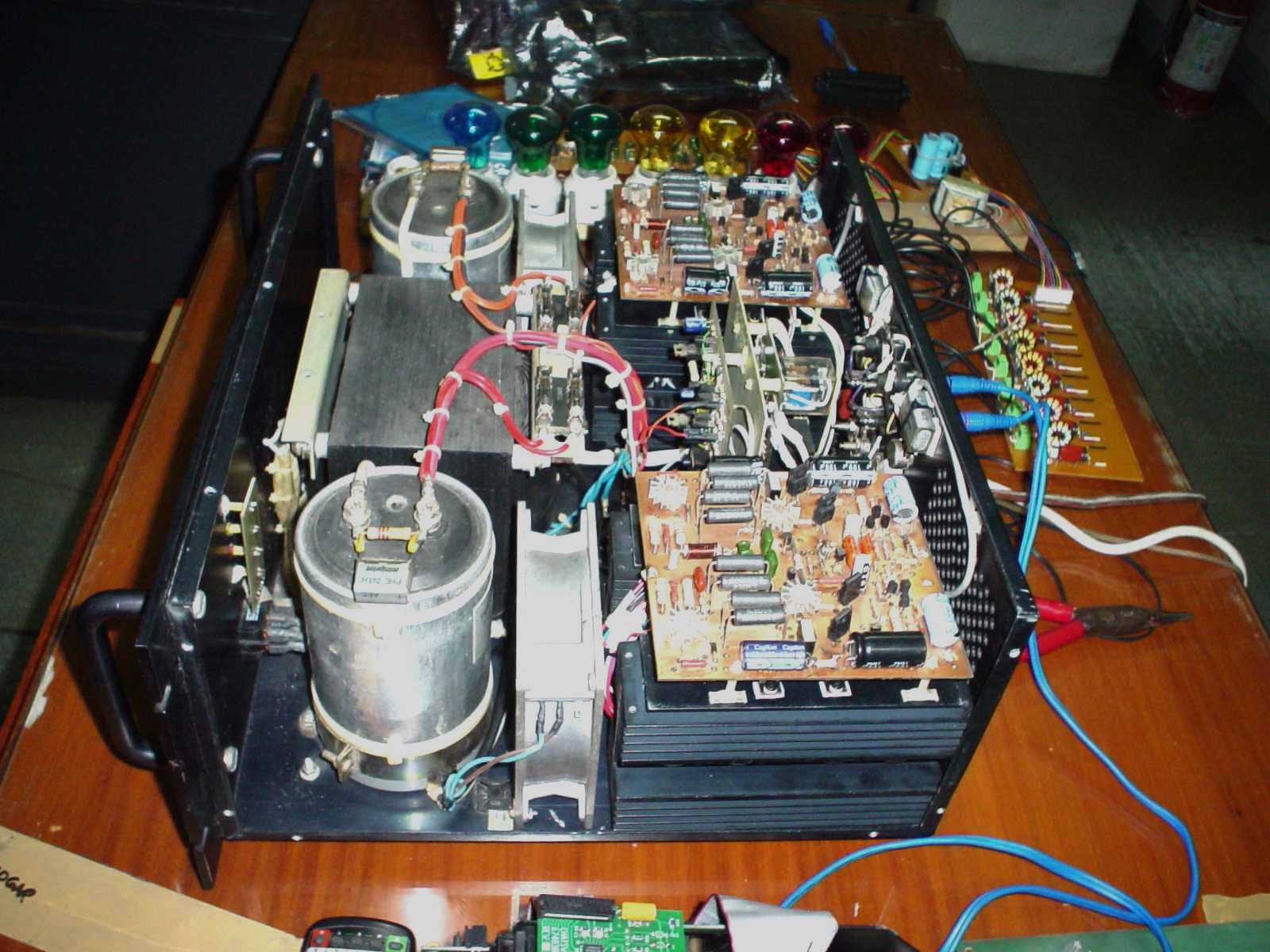

i agree with this...the 430va traffo is not that big, lots and lots of vintage amps with traffos as big as this have been made and sold, look at tthose japanese amps of the 70's and 80's.....get yourself a good quality power switch and you are go....
in 1994 i built this big traffo, 2 inch center leg and stacked to 3.5 inches and rated
for 1500volt amperes....i made this in the 80's.....
soft starter is a 10 ohm 50watt dale metal clad resistor, as proposed by
Walt Jung in his Audio article....
