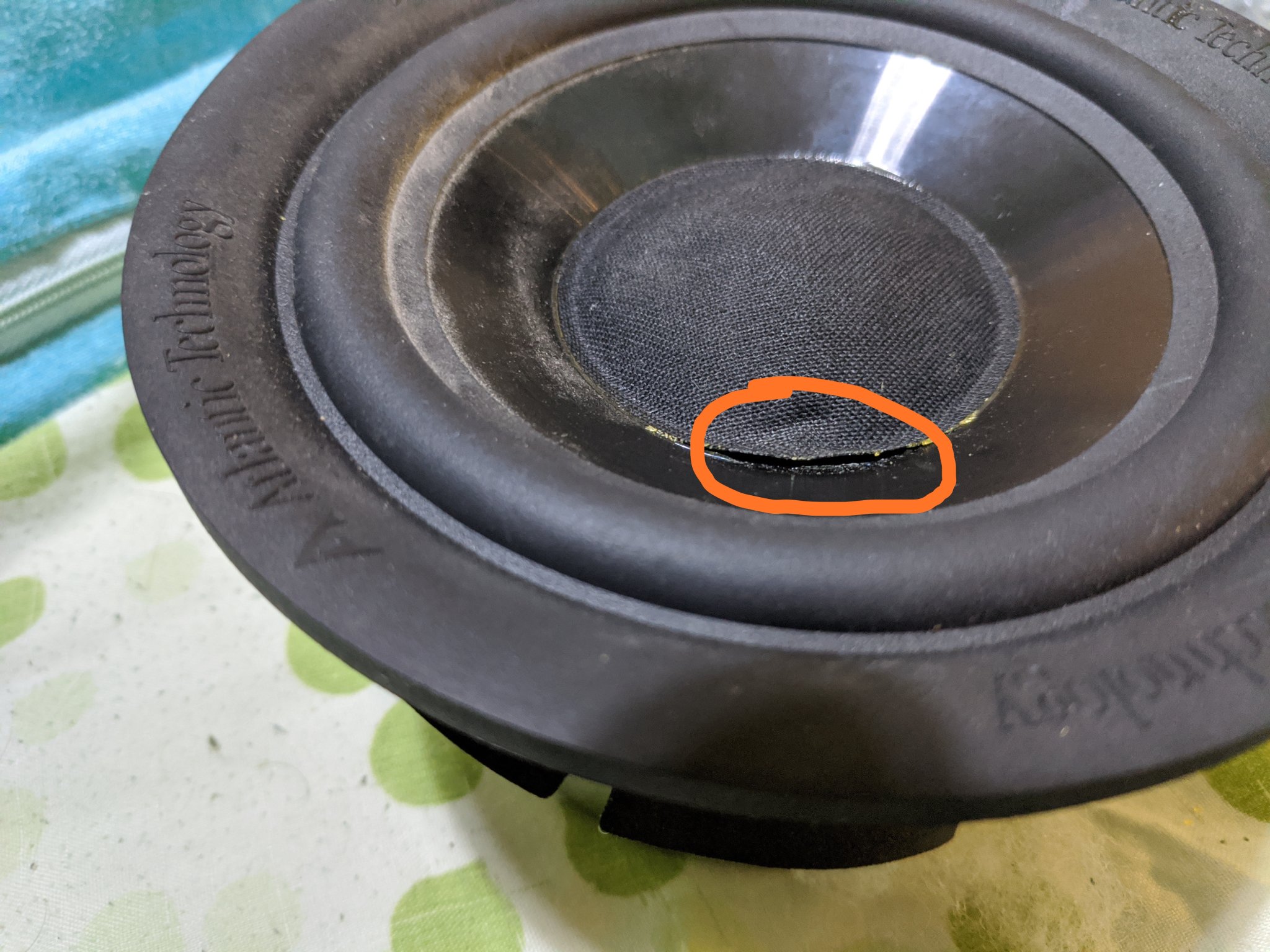

I will give another option 😉 : Here is the stuff too, I never have discovered big differences between them. Glueing PP is virtually impossible anyway, but my replacement surrounds attached on PP cones seem to hold up til now.With the very greatest of respect, an' all that, @markbakk, that is a pretty useless post! 🤣
You don't tell us which of this six glues is suitable for polypropylene!
I am generous with praise when the situation demands it @markbakk.
I got a bit confused with your glue suggestions originally. I didn't realise it was the same glue, just in different sizes and with different applicators.
Your suggestion was actually a good one. Consider yourself awarded a Gold Star if you remember primary School Days.
But we seem to be going with 2 component Epoxy Resin since @kstgr has some to hand. I think it might work. 🙂

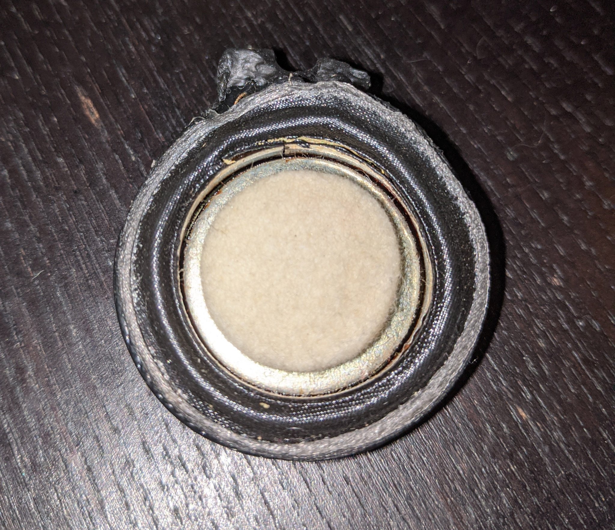

I don’t see how a glue that actually hardens that much will stay flexible enough to follow bending of the cone, surround and dust cap. But it will work, cyanoacrylate sticks to about anything you throw at it.

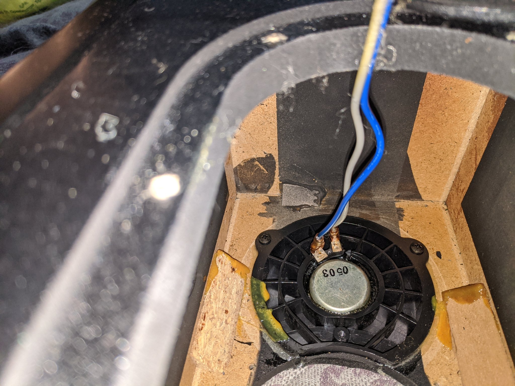

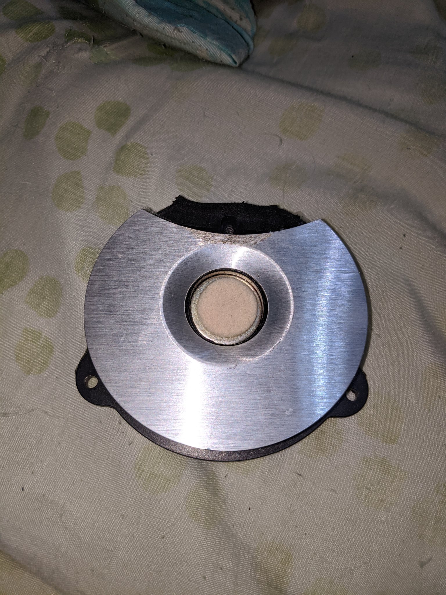

I glued the dust cap to the cone using epoxy 2 part glue
Here is some pics with the end result after 48hours to let the glue dry
I know it's done, but this is in case anyone else wants to know.
