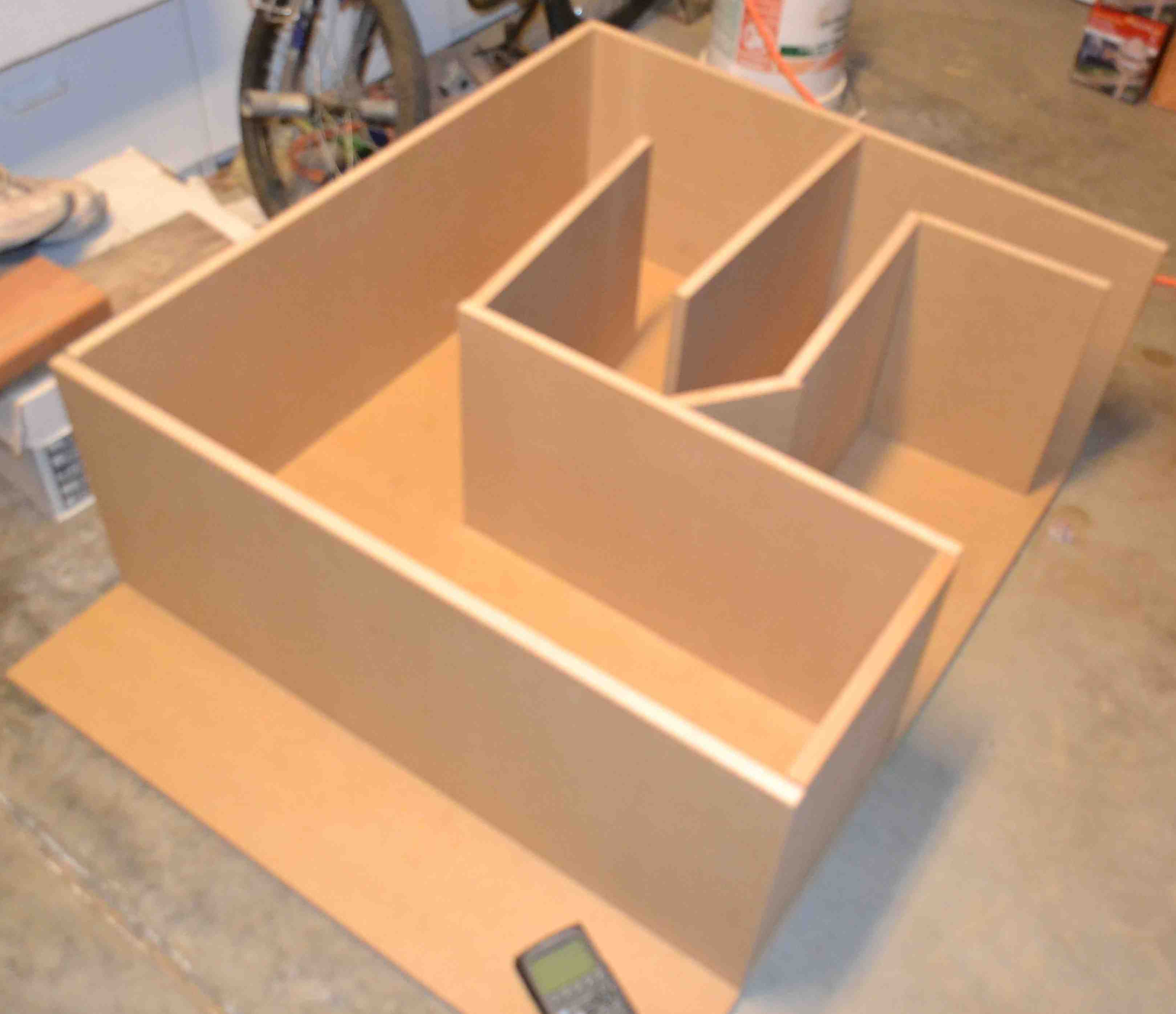

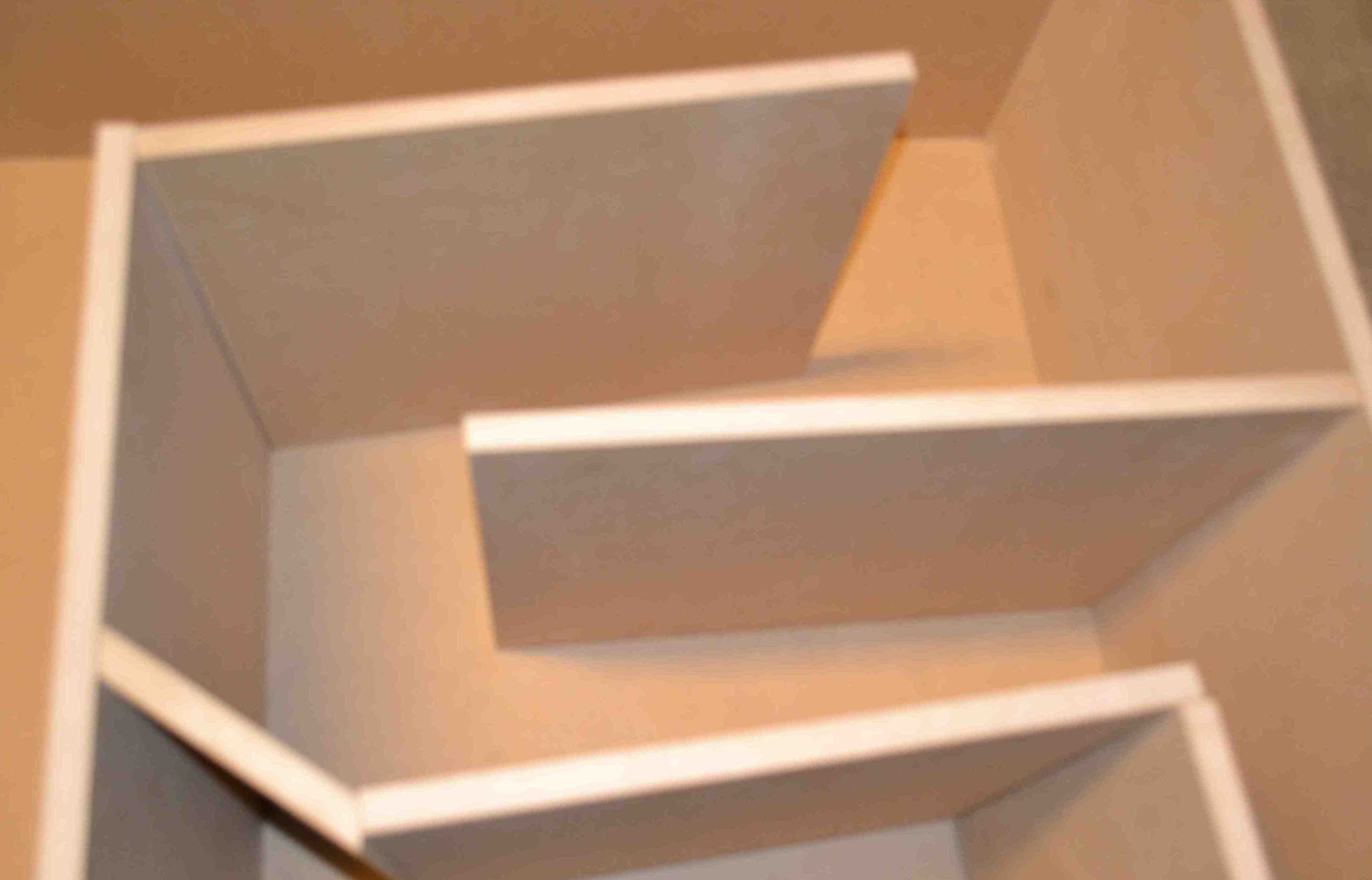

Two days ago I found a way to get onto HornResp, after a bit of a learning curve I figured it out, mostly. I came up with a very promising design that modeled quite well and called it a night. Yesterday during school I tried to fold it (very tedious) and near the end I realized it wouldn't fit. I made a few minor adjustments without hornresp hoping it would be close enough and managed to get all the dimensions. When I got home I modeled it and with one or two very minor adjustments I decided it was good to go.
I finally got a chance after school to go to home depot an get some MDF and start cutting. I started by drawing the 1:1 scale detailed drawings on the bottom piece of MDF, taking into account the 3/4 thickness and converting everything to the nearest 16th.
After some very precise cuts I got to the point where I'm at now. I laid it all on top of the bottom sheet on top of the drawing. I have not yet glued and screwed those on but thats going to happen today.
My dad thought it was really cool, he's done a a lot of building stuff also (the tools I use are his) so he was pretty impressed with the geometry and how precise my cuts were. My mom on the other hand is happy that the drivers haven't arrived yet (backordered from parts express 🙁 hopefully arriving at the end of the month)
At some point soon I'll post all of the hornresp information and the detailed dimensions I drew for anyone who likes the design in the spirit of open source.
Does anyone have any suggestions for putting the top on? I need to make sure that the screws actually go into the vertical pieces but I won't be able to see them. I was thinking about putting glue on the top of the vertical pieces and very carefully lining the top piece up then lowering it down. Then I would quickly take it back off and drill through the top where ever there was glue, lower it back where it was and screw through those holes, then hit it with the nail gun in between the screws. Alternatively I could measure everything but That may not be as acurate

The saga continues...
This weekend I got two days in working on the sub and I got as far as I can without my woofers or stuffing.
I need to go to my cabin where I have a a large amount of soundproofing material that I'm going to use for stuffing (I need a lot and I don't want to have to buy that much)
The drivers are set to be in to parts express on the 28th so I should get them around the 4th of next month.
The build went pretty smoothly, no big problems arose though keeping everything accurate and according to my design was tricky.
The sub right now is in three pieces, when its all done it will be in two pieces. The back/armrest are one piece that gets bolted to the top of the subwoofer enclosure. I did this to make it easier to take upstairs and work on it in the future.
I finished it with some cheap black fabric and put a large cushion to top of it. The grill is held in place with some neodymium I had, mostly its to keep my cat out of the maze but also to make it not recognizable as a subwoofer.
It barely fit in place, theres probably only one or two millimeters of clearance.
This thing is incredibly heavy, it weighs around 200 lb as it is now, with two woofers its going to be a bit heavier

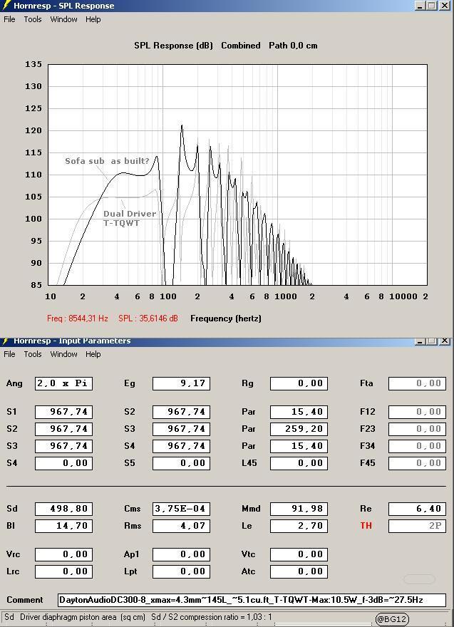

Hi kctess5,
In post”21 you wrote:

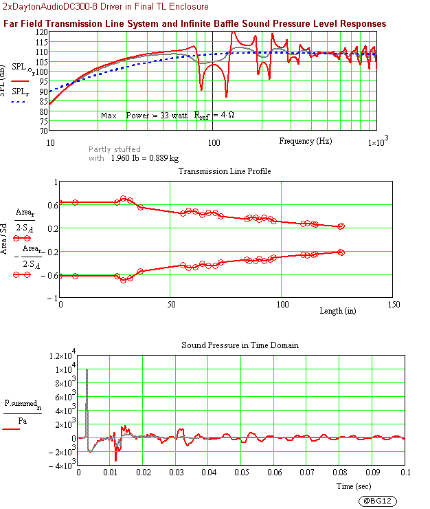

Sorry for missing this question, See the submitted OD-TL sim of your changes from my T-TQWT into your OD-TL using two drivers:
Looking at the FR and the fact that you have designed a multi-folded path to the terminus the HR OD-TL sim. is not reliable when entering stuffing(using multiple folds too) into the equations.
Stuffing by taste is not recommended as SPL could be lost unnecessarily as the damping material density profile might not optimal.
The lower peak seen in the HR sim will not cause problem and should disappear due to the foldings but the peak at 90Hz should be lowered a bit but the upcoming peak at ~200Hz to a greater degree.

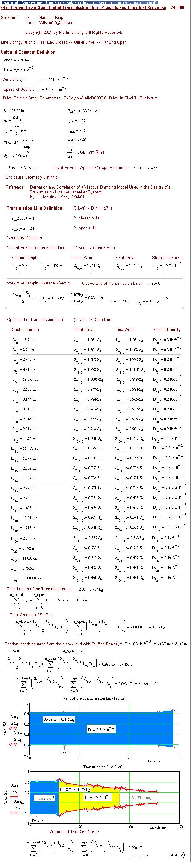

You've done a great job so far with this sofa TL but now you need IMO slow down a bit because of the complex airways:
The entire outline needs to be traced down by making a list of all used CSA:s and section length's.
Then if simulated in an appropriate program the localization of the damping material / different stuffing density and weights can be determined.
To being with,I would do that: I.e. spray gluing a 1/4"-1/2” felt at least 2/3 of the length but only stuff precisely as much as needed per built section down to the very last bend. IME:The needed weight of stuffing will then be minimized and not visible if looking into the terminus.
Very effective if mineral wool based but a disaster for your health, so ruled out and not recommended as micro size particles could be emitted into the room.
But if used : Leave at least 25% of air-columns to be formed between the mineral wool battens(~2” thick) and do not use any stuffing to fill/shut the open airways up as the attenuation when using mineral wool is by far more effective than any normal speaker stuffing material.
There is no norms but an density interval to use: Typically a span of~0.1-0.5lb/ft^3 that is mostly used. 0.5lb/ft^3 or even up to 1 0.5lb/ft^3 is about standard for a traditional totally filled TL but could be to much if followed in your case:
Be patient and post a list containing all CSA: and section lengths. If you want a hint from me you have to list(calculate all) the CSA:s in terms of the Driver Sd area.
( Section area (cm^2)/ Sd(cm^2) = Decimal Number.
The section lengths should be listed in inches. See your photo where I doodled hints on where to measure the required section lengths and CSA:s.
When this is done all the data could be entered into MJK:s most advanced program(tedious work but IMO very rewarding if done and wort waiting for ) and the return would be the weight of stuffing material using a certain density to be filled in between (per section) the (sometimes different) CSA:s enclosing volumes.
It must also be clear that the driver(s) you are using have T/S that are close to whats earlier was given. I give no guarantee for any posted calculations if the T/S are far off.
b 🙂

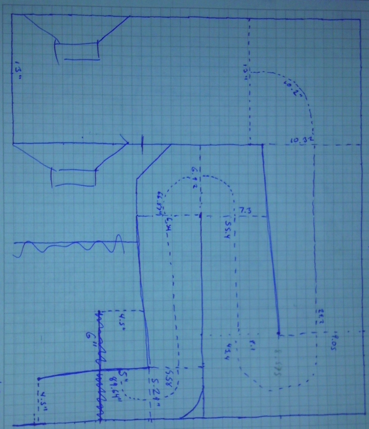

I actually have a plan with the exact dimensions on paper. I'll take a picture and post it. It may be a bit hard to read, let me know if you can't see a dimension. I spent about 2 hours on this getting the taper right and I built the sub quite accurately after it. I would say the accuracy on all of the dimensions is +/- .0625 inches, for the lengths, all of the widths are more exact than that. Is there any reason for me to measure everything if I'm quite certain its the same as the plans?
I need to fire up the jet engine (my pc laptop with an incredibly loud fan) and take screen shots of the models that correspond to the plans, it actually from memory is flatter and lower than that model you just posted, ill post it sometime tonight

First I must make a small revision of my last posting:
Should read: peak at ~145Hz. Then the label TH at the posted screen-shot of HR main screen should be read OD instead.
If I had your speaker in front of me, I would take the measurements needed in sequence and enter all into MJK:s program but as I don't have access to your sofa, only my own 😀 and it's difficult to read your numbers in your last picture where I also immediately noticed quite a few vital numbers were missing, I would normally
and move on to another thread and...
Unless a complete list of the numbers(or a complete drawing with printed numberings) I,m asking for( Some must be DIY calculated) I see no reason to spend my time of something that would meet a dead end after say half an hour sojourn with MJK:s program.
Thats only the coffee brake time taken for a true DIY'r, he will if necessary spend a whole day to get it right 😉 (I don't think it matter if you built the sub with an accuracy or 0.4” of every dimensions) but you have to understand here, that all ...measured... sections/ CSA:s is what counts, not the accuracy, they must be entered correctly in order to ..reflect.. your sofa-sub air-ways.
I counted 22 CSA:s and I wont accept an area/section presentation other than what I'm earlier asked for,you have to do the required number-crunching too.
Much appreciated if you take my requirement seriously! If your model is in reality flatter and lower. It would for sure affect the required numbers I,m asking for.

:peak at ~200Hz
I actually have a plan with the exact dimensions on paper. I'll take a picture and post it. It may be a bit hard to read, let me know if you can't see a dimension..

Alright heres a bunch of info I made today. Included is the input parameters I designed off of, the projected response, a screenshot of the spreadsheet, and the dimensioned drawing I took all of the info off of.
Note that all of the line lengths on the dimensioned drawing must be multiplied by 4 (because the scale of the drawing was 1/4) but I have done this for you in the spreadsheets so you shouldn't have to worry about it at all
Most of the corners have a 4in radius piece of sonotube on them to keep the area more constant and this is factored into the numbers
The drivers are offset about 7 inches (to the center, i.e. one inch from edge) from the beginning of the horn
Let me know if anything else would be helpful. Thanks again!
Oh yeah I forgot to mention that the CSA/Sd ratio is for two woofers, as in CSA/(2*Sd), because I have two. Just trying to avoid confusion
Great information! Now it's easy to plot/find out an MJK optimized stuffing scheme. It will take some time...Be patient!

Here is a preliminary result. It looks like it would be a good idea to invest in ~1 lb(more is IMO not needed) of commercial loudspeaker damping material besides to use cross bracings (like 12 or more dowels) at least for the five first of the sections seen in your drawing where also would benefit from felt of wool glued on the walls.
I need more time(1-2 days) before I have time to post a more detailed result..
b🙂

Late edit: 1lb of stuffing should read 2 lb's

Your sofa sub should be easy to stuff if following this final scheme with minimized use of damping materials but cross-bracing and coverage of internal walls is still necessary if to peak the performance of this design 😛art 1
