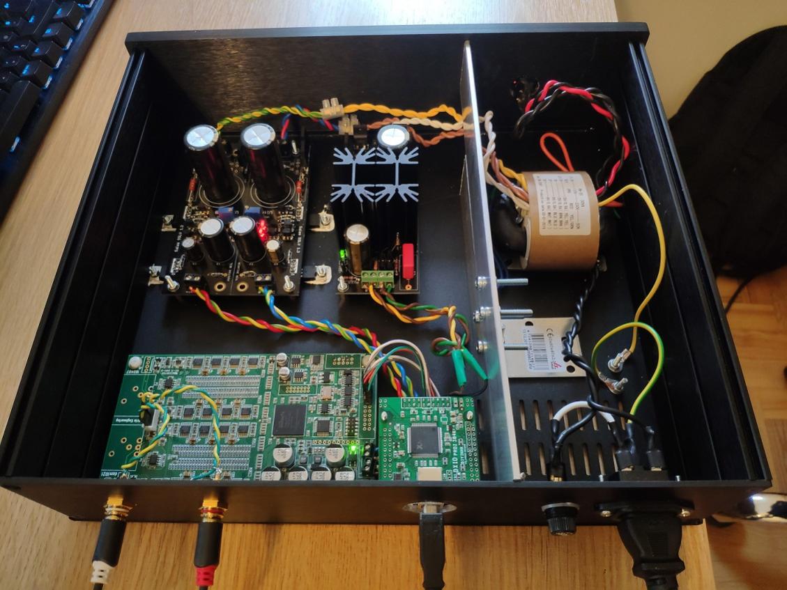

Got the box finally finished. The last part for USB rear port gonna 3D print instead of oval hole.
So far DAC sounds really nice. Using it now with Salas DCG3 and B&O H6 headphones. Also should get Sennheiser HD6xx real soon to do further testing.
Wanted to thank again for helping out with the firmware upgrade. Cheers :)
