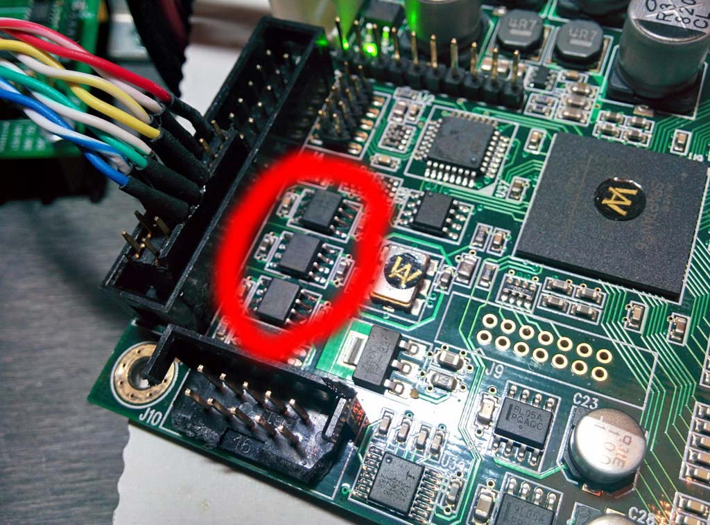

The isolators should be U36 and U34 (and probably the other similar-looking 8 legged IC beside J3) as per Soren's post here
Dimdim can probably verify since he has actually done the operation!

I can't read the light markings on other ICs. Can anyone tell me where is/are the isolator(s) and their respective part number?
Here they are, in the crude red circle:
attachment.php
The part number is SI8620BB-B-ISR but it's near its E.O.L. so a better choice would be the ISO7420FEDR. It's a drop-in replacement.
The ISO7420FEDR is 2.5 times more expensive than Si8620BB. Is there any superiority of ISO7420FEDR over Si8620BB?
