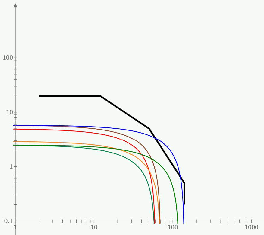

I'm trying to use mathcad to draw up SOA charts, but I'm not certain about my formulas. If anyone knows how to use that, I'd like to double check my calculations. But that only checks to make sure the load line sits well within the soa, but doesn't help with the calculation on the protection circuit.
3 pairs MJ15003/4
Here is a snapshot of a plot that I made for a 3 pairs output of MJ15003/4 with rails at 60V and 70V on a load of 8 and 4 ohms. First I aimed at resistive loads and then 100% reactive (using 2 x Vcc).
The colors are:
green: 8ohms at 60V rails resistive. 8ohms 60V rails 100% reactive (2 x Vcc)
orange: 8ohms at 70V rails resistive
brown: 4 ohms at 70V rails resistive
red: 4 ohms at 60V rails resistive
the SOA in black is taken from the MJ15003/4 datasheet, plotted with the knees at:
Ic: 20 20 5 0.5 0.2
Vce: 2 12 50 140 140
The question is on the reactive load line. I just used 2 x Vcc, but I'm not certain I'm using the right formulas.
If I can get all this right, then half the work is done.
  • MJ15003:4 3 pairs.png
To bump the old thread, I have a question regarding SOA given in datasheets.
Take as an example the 2SC4027 datasheet. The SOA includes graphs that seem to specify the maximum, non repetitive (as I understand but this is essentially my question) V-I relationship. For time intervals of 1ms, 10ms, 100ms.
What if you stay well inside the DC SOA, but the power swings momentarily but repetitively to these extreme 1ms SOA limits, but for no more than 1us each time. For example, when driving a high frequency sine into a load. Would then the transistor be in danger, or is it ok as long as DC power falls within the DC safe operating area?
I think you'd have to do some thermal modelling to figure out the repetitive ratings, but I reckon you'd need to know the time constant for hot spot diffusion/dispersal to do that, which is presumably tricky to define, let alone measure, as hot spot distribution/spacing may vary from die to die...
