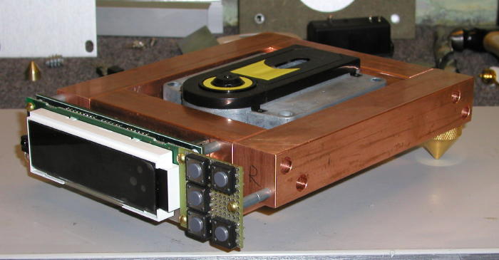

Steve Eddy said:
You know, Peter, if you could come up with a CDP in the same design style and a pair of speakers a la the Elans, you'd have one hell of an "executive" tabletop system.
Well Steve, I'm not completely sure, but chances are you made me start working on this;)
The CDP will have a footprint of approx 6.5" x 8.4". Basically the same as Amp-1. As far as I'm aware, nobody makes such a small, high end player. The TDA1543 DAC will be on board too.

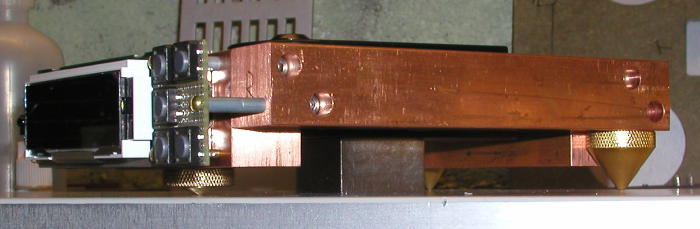

Here's another angle. The frame is made of 1" and 1.5" copper bars, hard suspention, separate PS (possibly battery operation). Brian Bell came up with control interface. Actually, such small design was possible thanks to his board.
I had a bigger design in mind initially, but working with small parts is much more satisfying.
