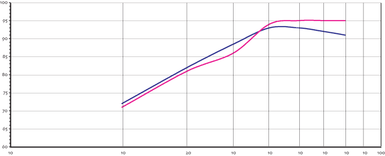

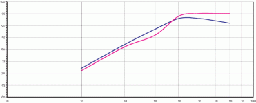

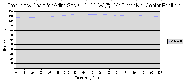

I think it might be a problem with your room, if you look at the graph I posted above, there's no large hump in FR when my ported subwoofer is in a room. If in your room, a sealed subwoofer is better, then obviously you're better to use a sealed subwoofer. 😉
