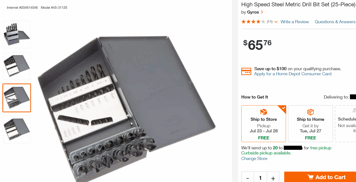

....I was down at the local Home Depot and they don't stock metric drill bits....
They can get them, but it sure took me long enough to find them, and I would not buy a big set to mount a few jacks.
Which is all extra-funny because Home Depot must have contracts for metric bits for their Canadian operations. (Which have a much sleeker website, but won't sell cross-border.)
You can pick up a 1/8" to 1/2" taper reamer for about $12 from Home Depot.However, I see that a 3/8" drill bit (which I have) is 9.5mm. Did you try that for drilling the mounting hole, but found that it was too small to use? A half a millimeter is not much.
