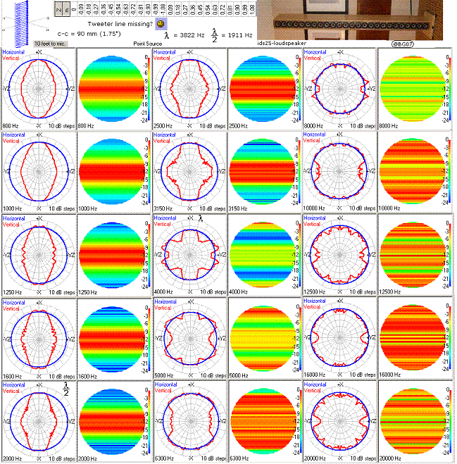

FYI: See the picture, No combing in RR ids25 array destroying the phantom height impression?
Look at the corresponding point source plots with ideal drivers showing + 6 dB noticeable vertical ripple starting at 1250 Hz and the up-coming severe loobing at lambda (3822Hz) and above.

bjorno, is there somewhere i can go on the internet to decipher what you are showing me with the color graphs. it is quite interesting buy i am not sure what each graph is displaying.
I am sorry, but simple physics will show that the only line array that works outside of the fresnel zone (a mismash of changing energys) is a focused array.
At work i developed a variable focus array that is constantly changing in depth of focus point in materials to evaluate grain boundary conditions (reflected energy at the grain boundry). This works in any point of the time/distance baseline. This is designed for higher frequencies of 2.25 Mhz and higher. However the physics of lower frequencies remains near the same.

...is there somewhere i can go on the internet to decipher what you are showing me with the color graphs…
You may find some explanations and where to find the free ArraySHOW program here:
http://www.diyaudio.com/forums/showthread.php?postid=1209499#post1209499
http://www.prosoundweb.com/install/synaudcon/tt26_3/tt26_3_p1.shtml
See the picture where an ArraySHOW polar curve is compared with Tolvans Xdir and observe the differences, as Xdir is not third-octave filtered but the ArraySHOW is:
