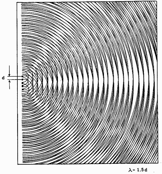

My take is SY's talking the idealized case of an ideal flat radiating driver. If two such rectangular drivers with infinitesimal frames are butted edge-to-edge it must be so, nothing differentiates the pair physically from a single rectangular driver doubled along one dimension. No differential movement between surfaces and no gap. While it's correct individually they begin to beam above a certain frequency the effect is offset by their output summing at 90 degrees to the long dimension.
SY said:
The model of narrowing dispersion is valid for an isolated driver, but with a tightly spaced array
A driver's dispersion is independent of the array. It is these radiation patterns that lead to the comb-filtering.
dave

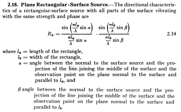

someone else can crunch the numbers... here is the math for the directionsl characteristic of SY's ideal rectangle. R is the ratio of the level at angle alpha vrs the on-axis level.
from Olson
dave
As i understand SY's argument, R would need to be 1 for all reasonable lambda & alpha
