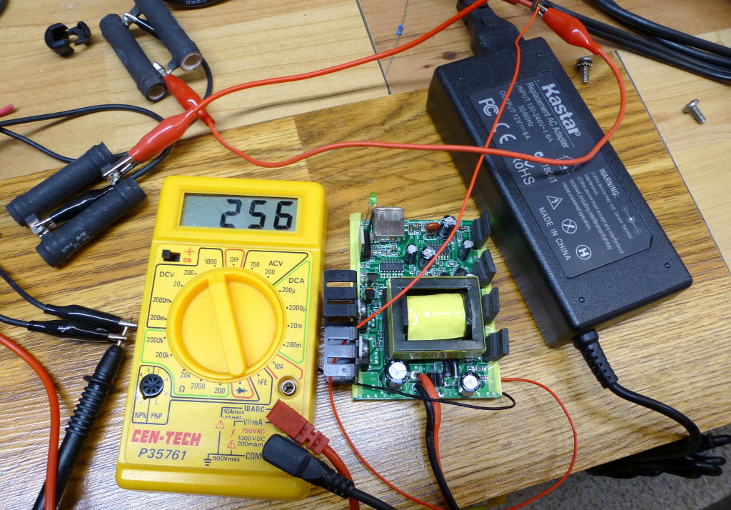

I have been tinkering with a battery powered vacuum tube guitar amp. The exact size and power output is yet to be determined, since I have not yet found the limits of the available cheap power sources.
My last experiment consisted of a "200 watt 220 volt AC outlet Power Inverter" from Amazon for $17.29. Unfortunately I may have purchased the only one in existence, but there are other similar units. I opened up the unit and connected a pair of wires across the only 400 volt electrolytic in the unit.
Amazon.com : SallyBest® 200W Automatic Thermal Shutdown 220V AC Outlets Power Inverter Car DC 12V to AC 220V / USB 5V Inverter Laptop Charger Notebook Adapter with 1 AC Outlet + 1 USB Port : Car Electronics
I then connected the AC inverter to this 12 volt 6 amp "LCD AC Adapter" which I got from Amazon for $6.86. It's now $7.71.
http://www.amazon.com/gp/product/B003TUMDWG?psc=1&redirect=true&ref_=oh_aui_detailpage_o01_s01
I powered everything up and measured 13 volts across the AC adapter output, and 290 volts DC across the inverter wires with no load.
With a 10K load the output was 270 volts.
With a 5K load the output was 265 volts.
With a 3.3K load the output was 260 volts.
With a 2.5K load the output was 256 volts. (26 watts)

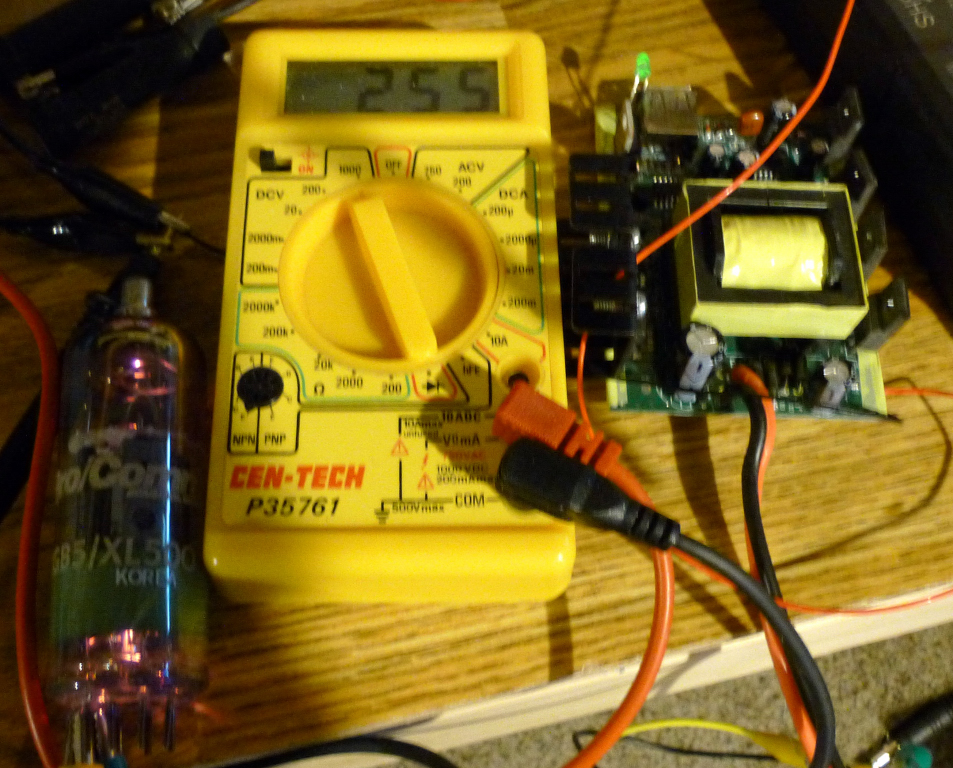

No start up issues were seen so I added a 13GB5 tube heater (600mA) across the 12 volt supply. Again no start up issues were seen....so I added another 13GB5. Again no start up issues were seen. I tried adding a 47uF 450 v cap across the load, and the power brick would not start.
At this point it looks like this power solution would have no problems powering a 10 watt guitar amp made with a pair of 6AQ5's and a pair of 12AX7's. Or a similar load without further work and I may just build one.

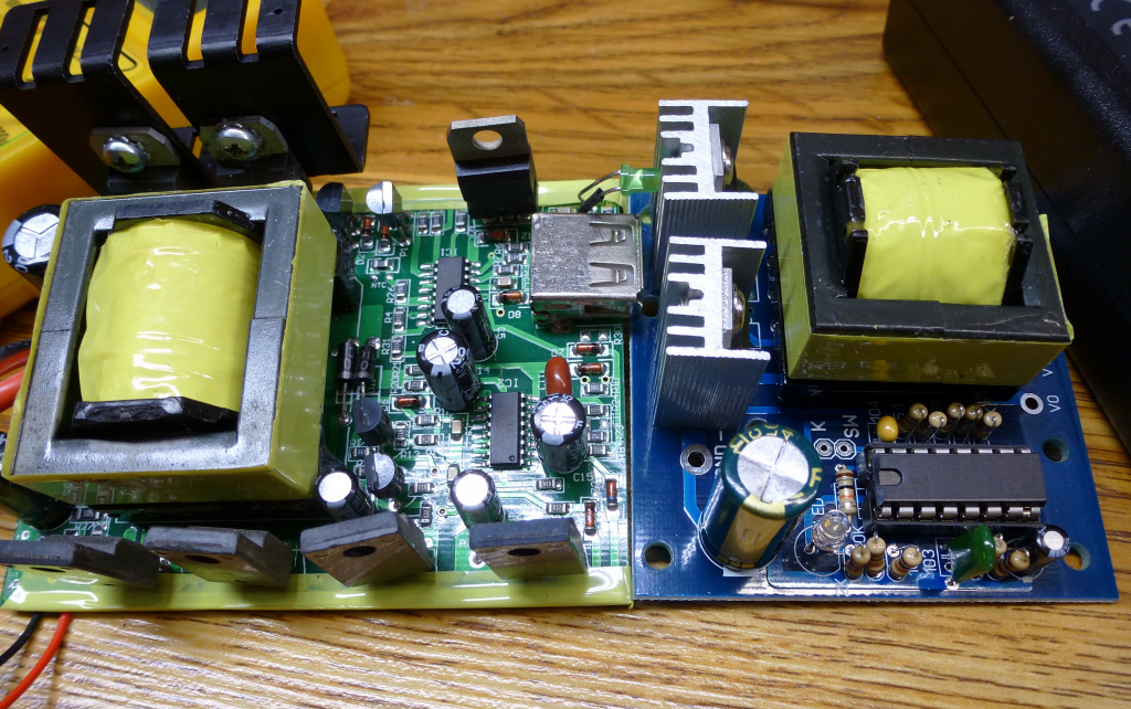

That is the exact inverter that I used in my experiments. I took it out of the silver case and added some heat sinks to the switch fets since the case was the heat sink. It wasn't even bothered by the loads that I threw at it, and it will deliver over 300 volts on 14 volts input. I was originally intending to steal its transformer and toss the rest, which might still be the case if I blow it up.
I've heard it alleged that most inverter controllers are nothing more than a huge 555 timer charge pump.
That's not the case here, and I have never seen an inverter bigger than about 10 watts that is made that way. The green board on the left is what's inside the Chinese 200 watt inverter. There are two identical SMD chips, Fairchild KA7500 SMPS controller. These are similar to the SG3525 chip. One of these drives the pair of fets above the transformer that I put heat sinks on. It operates as a push pull step up converter. The transformer is the typical center tapped primary (like a P-P tube amp) and the secondary is a full wave bridge with 4 diodes and a 6.8 uF 400 volt cap. There appears to be some feedback to one of the KA7500 chips.
The 300 or so volts DC are fed to the 4 fet H-bridge seen along the bottom of the board. These have no heat sinks and serve to chop the DC into a square wave with dead time that "approximates" a sine wave. I assume the second KA7500 controls them through some level shifting, but I haven't investigated that circuitry.
The other TO220 device in the upper right is a 7805 for the USB charging port.
I have cracked open a few inverters and this is the way they all work.
