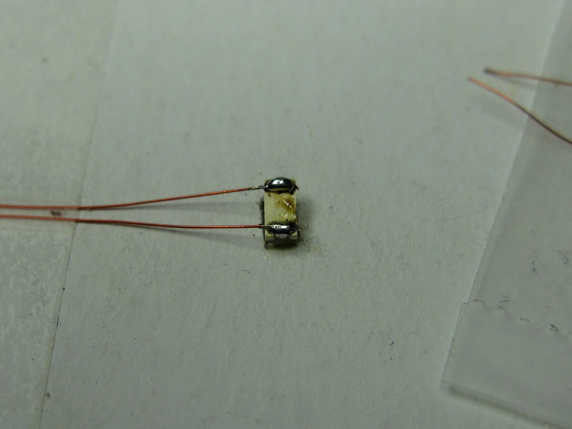

People do it with SMD LEDs... Should work fine with a resistor:
Reactions: JMFahey
